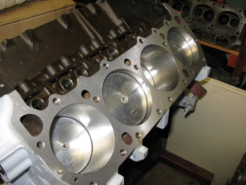

with those heads I helped design the kb quench dome specifically for that build

I can't answer all your questions Jerry, but one I can handle. If you are gonna use either 516 or 915 heads, you can't use the quench dome kb pistons, because you would have closed chamber heads.
In 68 Chrysler changed from closed chamber to open, which killed the quench, because of the new open area on the intake side of the head. The kb
reverse dome piston was designed to get the quench back, along with some more compression . Instead of the normal dome location in the combustion chamber, that area on a kb is flat, and there is a little dome on the opposite side, to fill the area opened up to make the open chamber. That piston therefore would collide with a closed chamber head.
