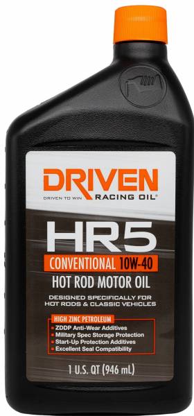

Driven HR5 conventional. ALL the ZDDP and then some - and also has "storage"
and start-up additives in it, which is good for cars like my GTX that might sit a few months in winter.
This is my #1 preferred oil and is in Fred the GTX right now.

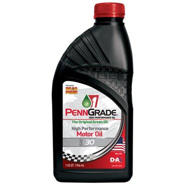

PennGrade 1 conventional straight weight. The famous "green oil" some remember as Brad Penn.
Again, specifically made for older flat tappet engines that need the zinc and phosphorus.

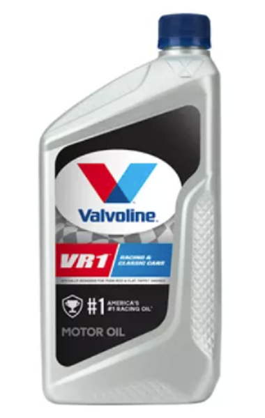

Valvoline VR-1 conventional. Again, has the additives (zinc!) for older flat tappet engines
and is probably the most likely one you're going to readily find in local stores...
BUT be careful here! There's a LOT of different VR-1 oils (they use the name on all sorts
of oils besides this one), so make sure it's the right one before grabbing it at Wally World.

Kendall before that, all done at the same refinery in Bradford Pa. Now they just train car it to Indiana to bottle it, rather than build a new bottling plant in Bradford.
Yep, Kendall was what I ran in all my pre 90's air cooled Harleys. Green oil!!

Oh yeah, a bunch of them. The Schaefers/redline I mentioned are full synthetic. Valvoline VR1 is probably the most common high zinc/full synthetic oil you can find, but it’s a race oil with no detergents and I wouldn’t run it in a street car unless I liked changing the oil frequently.

Valvoline says modern oils have other additives than zinc that do the same job so a high zinc oil isnt necessary, but people want it and they sell it to us in vr1. My car had full synthetic in it when I got it and seems to have had no ill effects. It wasn’t drive much while last guy had it. I put old school vr1 in it because I just don’t want to find out it needed it and modern oil doesn’t cut it afterall. Especially since it’s no problem to order up the oil.
