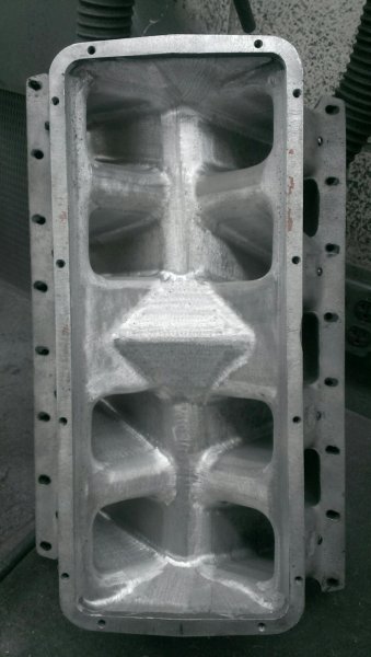

I dip my burrs in ATF. They don't clog, lubes and somewhat cleanses all at the same time. High temp, high pressure wash in parts washer once done. My last project was gasket matching, porting my tunnel ram.

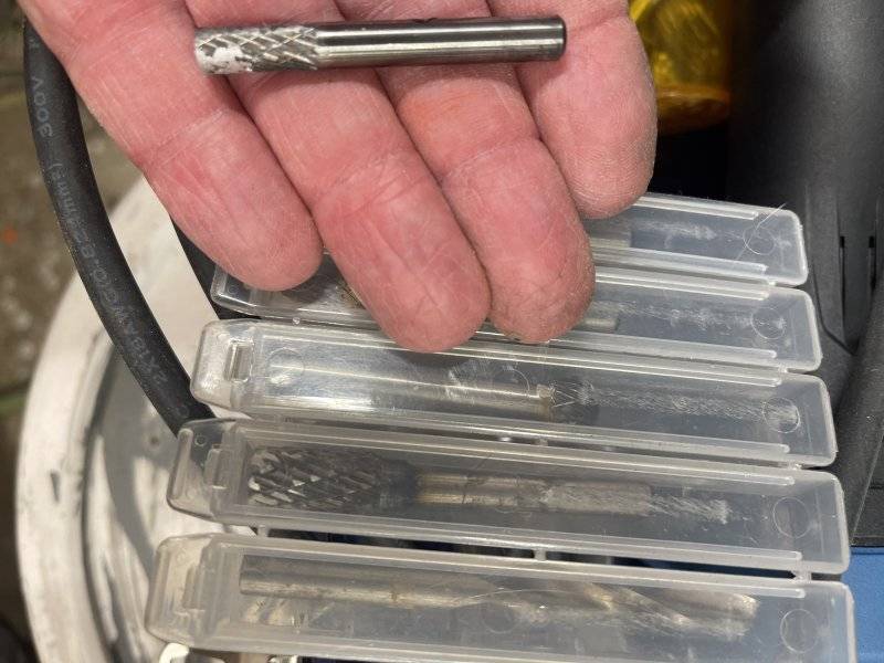

I have several carbide bits for my 4A 1/4” shank die grinder. One is a very high quality cobalt bit. Neither chew aluminum as they do steel! It looks like some helical designs might be better suited for Aluminum?
So what do you guys use to chew aluminum if not these?
To answer your question, the only Aluminum bit I see is the one at the bottom. All of the others are for Iron, and clog up faster. You can use them, but must clean the flutes often. For me, the aluminum ones jump around to much, and I carefully use the carbide bits made for iron and pay attention to the loading.

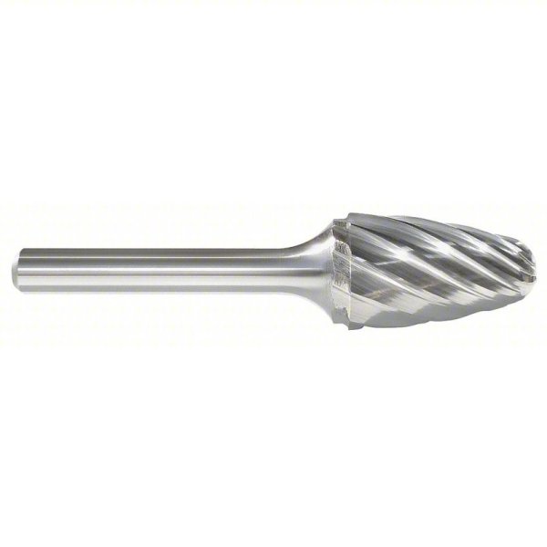

You need a wide flute aluminum burr and a can of WD-40. The burrs you have are for steel and cast iron.
