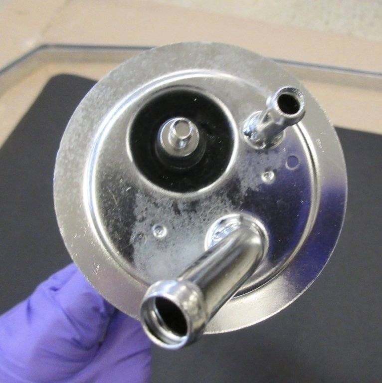

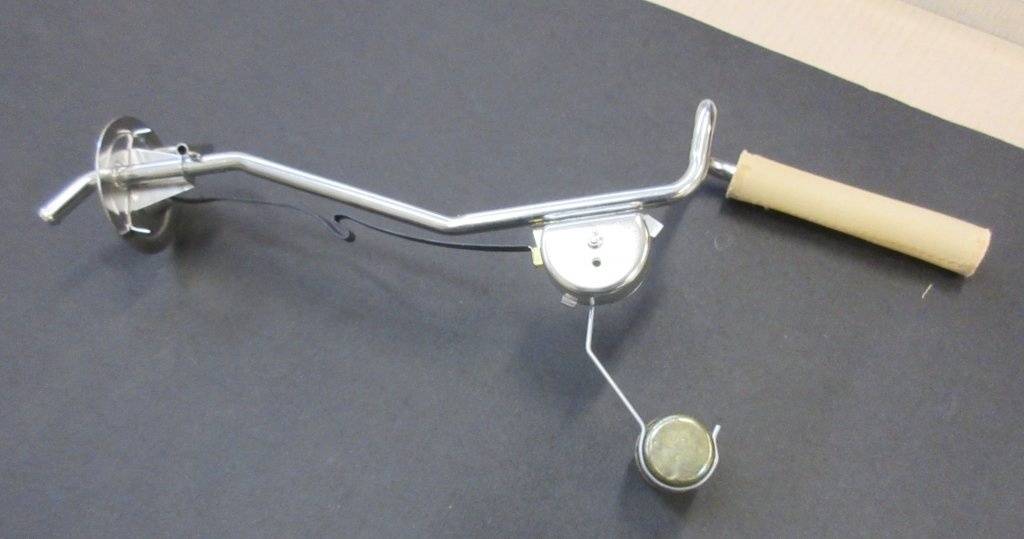

I discovered on Sunday that not all repop fuel senders are the same. They look the same, but they are not. The one that I was installing looked identical to the original, but there was a key difference.
On the original, the tube for the fuel outlet is bent to the rear of the car, and on my repop it is straight. This caused a bit of a headache with trying to route the fuel line so it wouldn't kink and be well clear of the exhaust pipe. So... if you have a 71-74 B Body and are looking at replacing the sender, shop around for one with a fuel tube that bends to the left when installed and not the straight one.

After reading this I checked mine out. Yep I got it from Van's. It has the straight tube. Somebody post up the contact info for a better unit. Thanks
B5BIRD, could you post a picture of the unit with the straight tube? Also, what year model and body type would the unit be for? The reason that I ask, you might have gotten the wrong unit sent to you. Some of the units look very similar, but there are differences in them.
As for the availability of the sending units, I would say that there are basically three possibly four different manufactures that the vendors are selling. I just received a unit from Van's for a customer and it is the same unit as pictured from Instrument Specialties. I do not know how it will function, but I am very positive that they were made from the same plant. The grounding from some are a simple wire, some are a metal band. Then a couple of the units are stainless and one is a zinc plated metal.
I was involved with the reproduction units that were made initially by the original vendor to Chrysler. Even these units had some issues with them, with approximately 3% having a real issue with reading and even testing 10 units, you would see some variation in all 10 on the OHM spread for each unit. That is why it is necessary to tweak the float arm to get the most accurate reading. I know that it is pain, but it is necessary to insure accuracy.
At the time when I had these ran, almost 20 years ago, the manufacturing cost to wholesale them was in the $57 range. Year One who was the primary purchaser, found they could purchase a alternative in the $18 range. So needless to say, they went to the cheapenr variety with the issues as the profit margin increased for them. Fast forward to 2017, reputable vendors are retailing the units at prices that are close to what my wholesale was in 1997.
I still have a couple hundred of the different applications that I will probably go to my grave with. We all want stuff as cheap as possible, including myself, but you really do pay for what you get. I know looking at the construction of the two reproductions, I quickly noticed that the plate that the pickup tube is soldered into is thinner and the supplied lock ring is still an issue. But hopefully it will fit and function well as a fuel leak and improper reading gauge is not a pleasant reality to deal with in dealing with these ventures.
Thanks Bfan. I bought this at the indy swap meet. I remember the package stating it was correct for my car but they may be trying to lump several models together. I will get a pic later tonight or in the morning.
When you say the line is straight up, which line are you referring to? Again is this a 68 to 70 B-Body unit? Also, is this a 3/8 or a 5/16" unit as the the feed lines exit differently as I recall between the two sizes. Trying to just educate myself so that I can better help our customers
