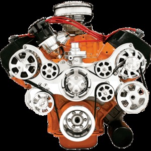

I used the CVF Racing all inclusive serpentine kit. Includes all the components you need.
That looks slick...What is the price on that???

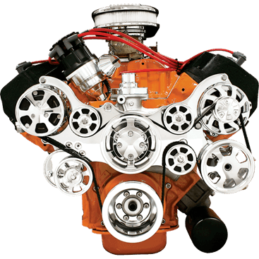

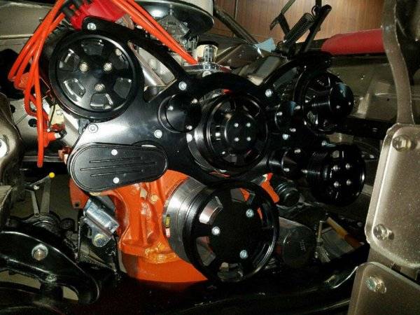

Hey kern a billet specialties true trac system would look great under the hood of your charger! They’re about $2500 but comes with alternator ac compressor water pump and power steering pump
Damn that's a lot for that set up! I probably have 300$ or less in my OEM set up counting belts. I'd rather spend it on go fast goodies.
Buddy of mine has the Tru Trac on his 68 Chevelle with a supercharged LSX, looks nice but like you I rather spend the money on go fast parts and just bought 440 source billet pulleys to make it look decent lol

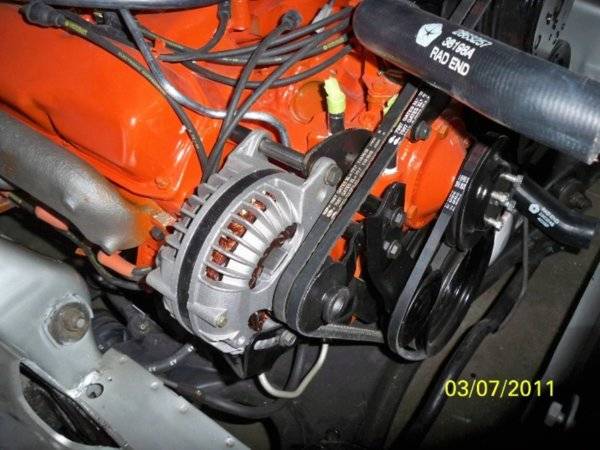

This is one of the 4 groove setups. Note the idler pulley to the right of the alternator. I just wonder why they had a 3 and 4 groove arrangement. Why not build it as simple and light as possible? Fewer parts...less weight, cheaper to build.
I think the reason for the 4 belt system is the smaller water pump pulley might of needed more contact to keep from slipping. Smaller pulley, less contact, more resistance.

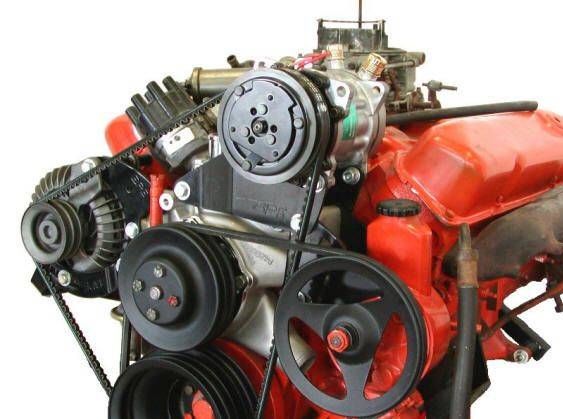

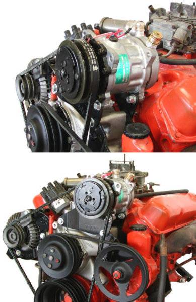

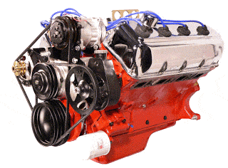

I found some images online. This is the same setup that I was able to set up, a 3 belt arrangement. It is funny that they also used a 2 groove water pump pulley even though the forward groove is not used.
Air conditioning with a 426 Hemi?
