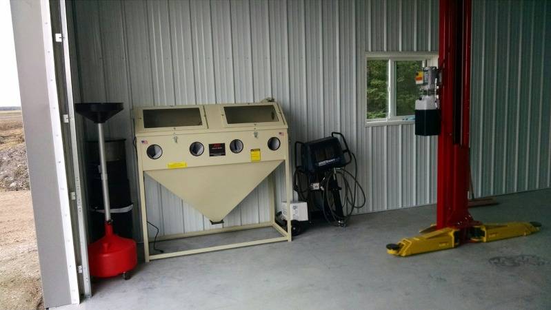

Congrats!!! You'll wonder how you ever lived without it. Mine's a 'little' bigger than the HF cabinets but it was one of the single best investments I've ever made for my shop.
Very nice Cudachick very productive cabinet. 5.7 Hemi go to Tacoma Company also HF mods on You tube you can do a few mods to make the unit better. The gun is a problem, better available.

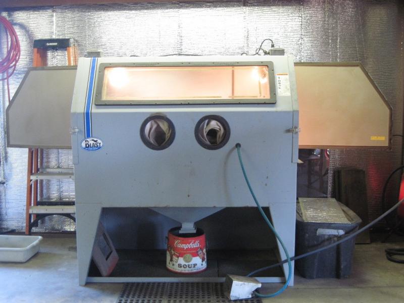

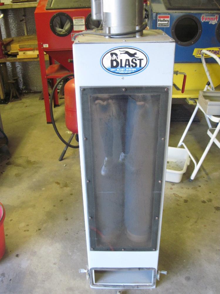

You can't really see it in my picture up there but my Craig's List SkatBlast cabinet score ($1200!!) also came with their awesome vacuum / media cleaner. It's got a Baldor motor (I'm thinking 3 hp off the top of my head) and it's amazing at keeping the dust at bay, albeit a little noisy.
I hooked my shop vac up to the cabinet and the gloves looked like I was inflating them. So I added a valve cover breather in hopes of the possibility that I had sealed it a bit too well.......didn't help whatsoever!!!! The dust is none existent, but the lighting sucks mountain oysters!! So now I'm trying to figure out a better lighting system.

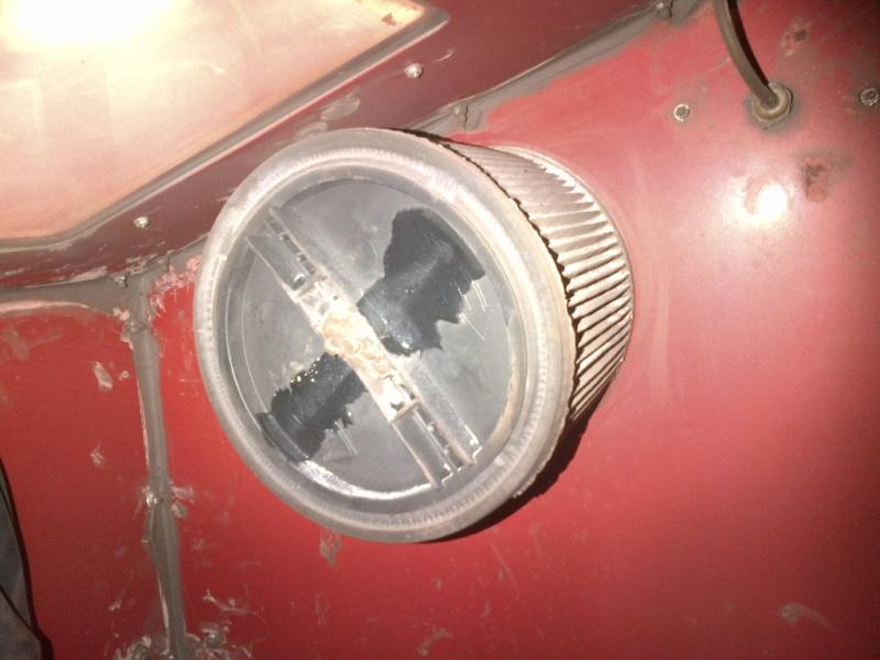

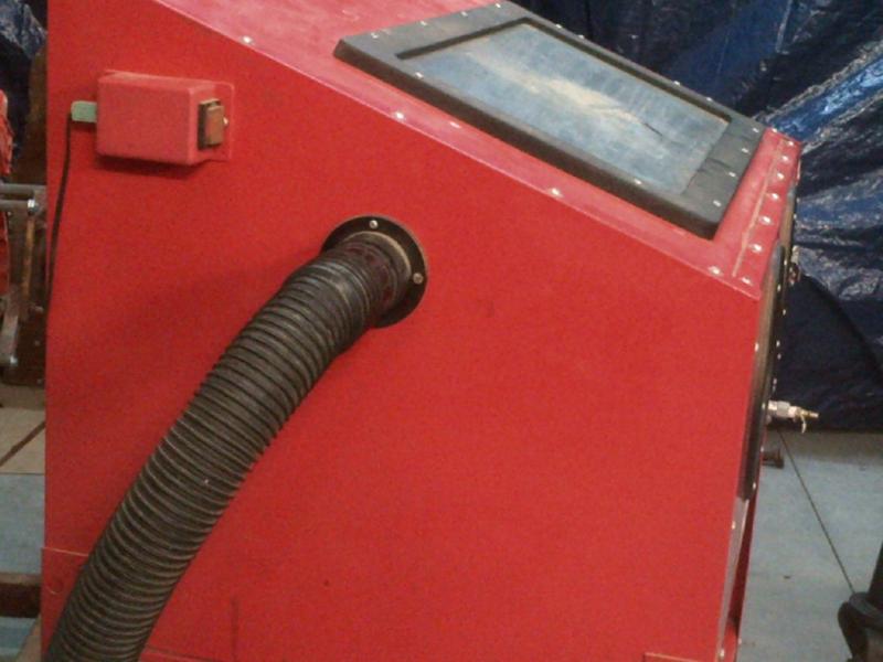

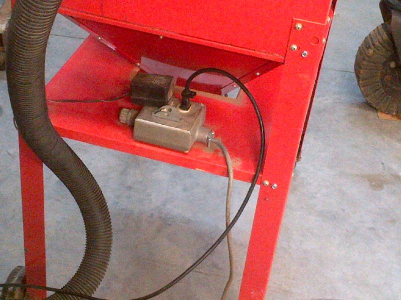

I have one of the cheapies i bought at a Homier tool sale for $99. I used silicone on every panel when i put it together. I mounted(self tapping screws) a switched receptacle to it that i plug the light and the shopvac into. It grounds eveything so i don't get shocked from static electricity. On the inside of the cabinet where the shop vac hose connects, i placed a shopvac filter. Most of the media stays inside the cabinet and gets drawn to the filter. When i shut in down, i tap the filter and the media falls into the hopper. I made a bracket that goes on the inside of the filter to attach it to the exhaust port.blaster.jpg
On the outside i attach my shopvac.
The switched electrical box that keeps me from getting shocked by static electricity. I also added casters on the legs to roll it around.
