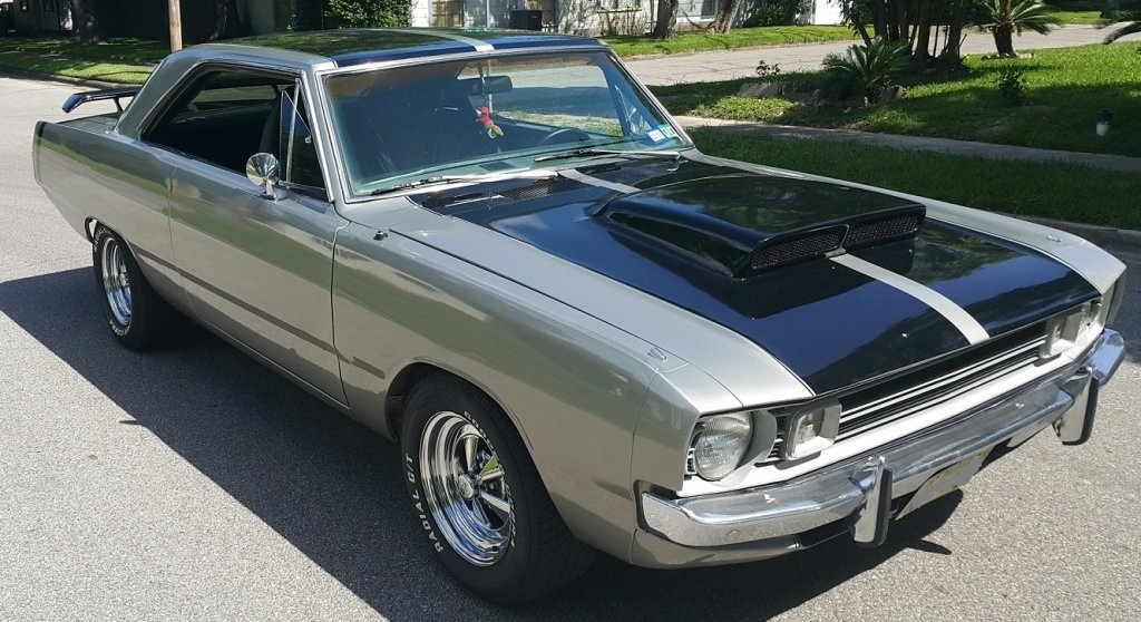

"Blind in Texas" '71 Dart build

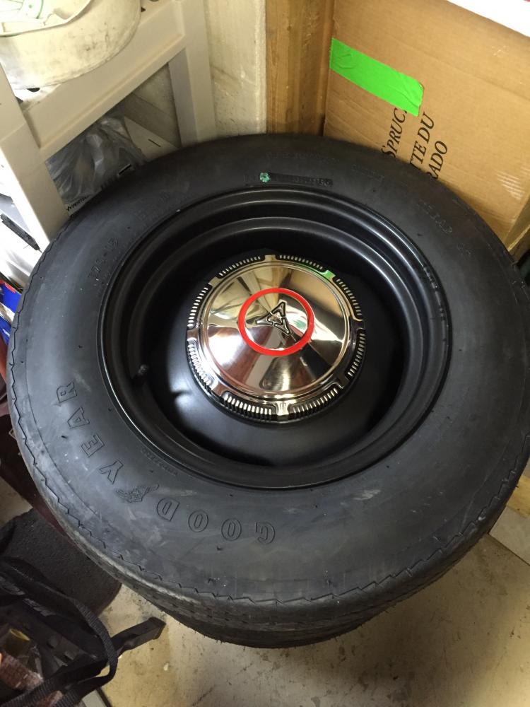

Well; building a car in Canada sure sucks with the dollar! So the 1700.00 U S,turned into 3030.00 Oh Canada! At the end of the day! Thankfully I have most of the parts I need now. View attachment 251229

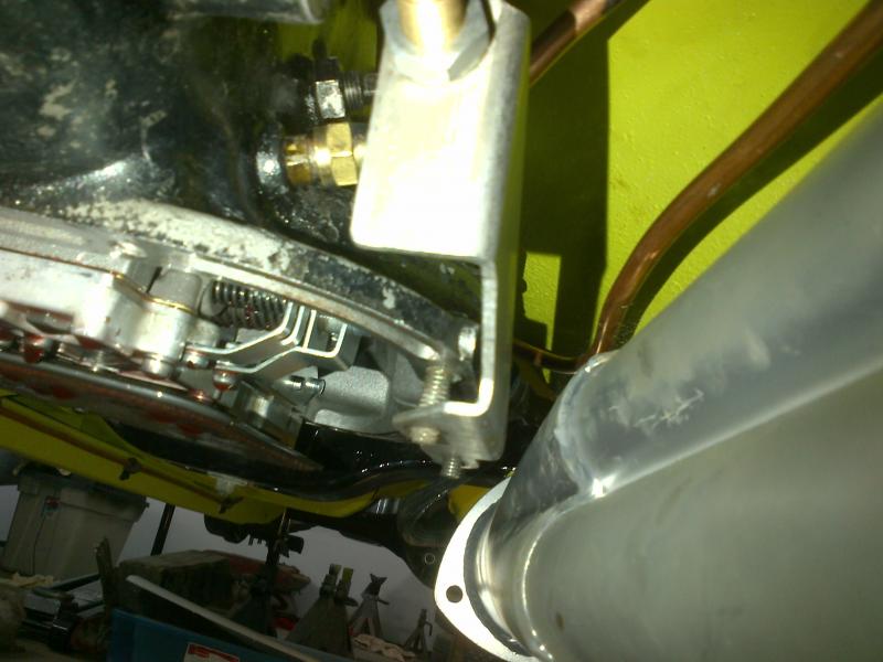

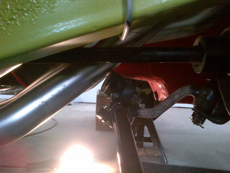

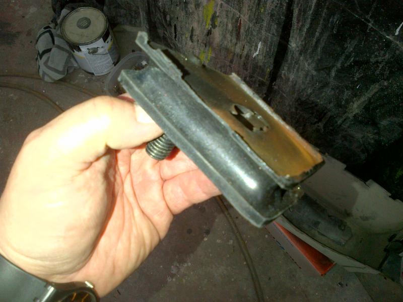

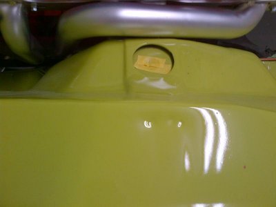

It's all going good! TTI headers are great,the Schumacher mounts are absolute garbage,for anyone doing a swap. Your better off making them!IMG-20150905-00941.jpgIMG-20151003-00968.jpgIMG-20151003-00967.jpgIMG-20151003-00969.jpg
IMG-20150905-00941.jpg IMG-20151003-00968.jpg IMG-20151003-00967.jpg IMG-20151003-00969.jpg
What didn't you like about the Schumacher mounts?
well what part fell apart? did you get the Poly lock type?
Yes,on the other side is a steel plate with a stud like the one in my hand. About as well bonded as a ham and cheese!
lol Yea the Biscuit type aren't as good as the Spool type But you got to make it work some times.

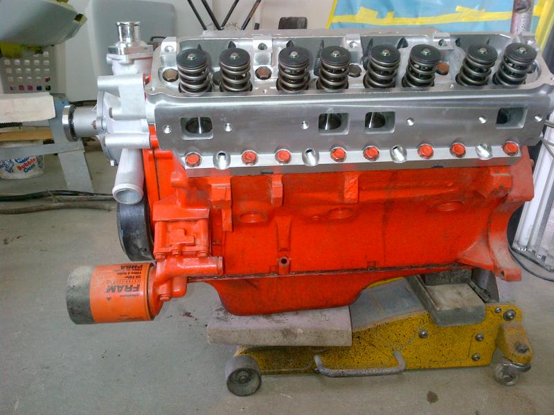

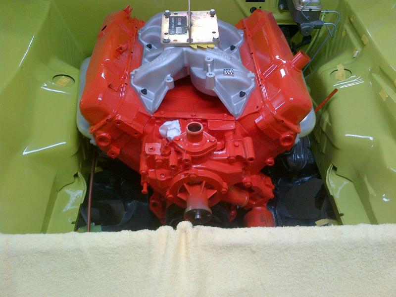

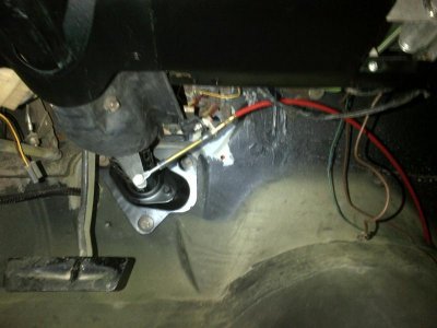

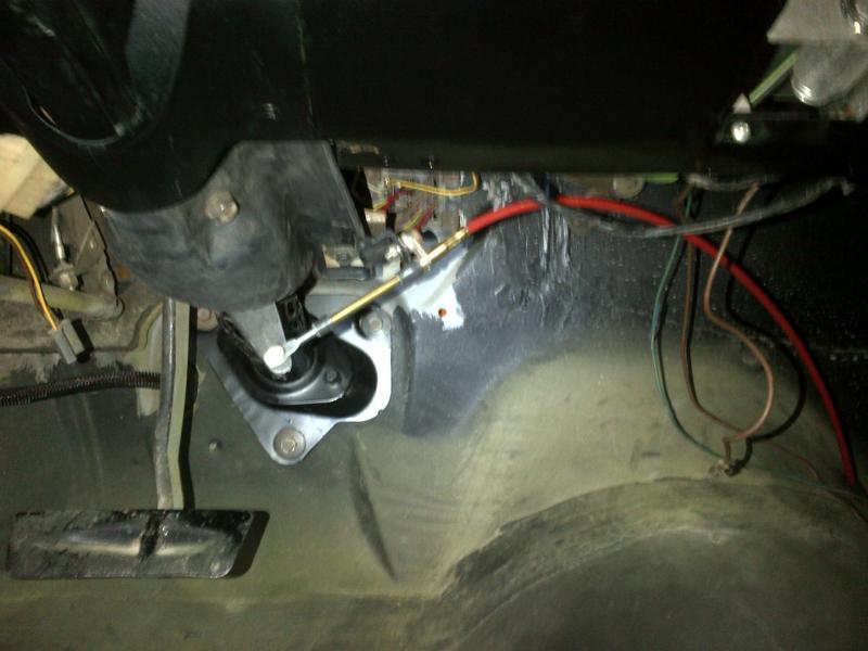

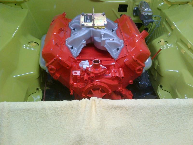

I haven't had much time lately,very busy with work. Just getting the engine ready to run,I hope to have it running by Christmas. I did get the shifter set up,the cable column shift works great!IMG-20151016-00974.jpgIMG-20151016-00976.jpg

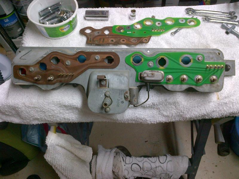

I'm still in the process of getting it running. Doing a clean up on the cluster and replacing the boards.IMG-20151028-00995.jpgIMG-20151028-00996.jpg

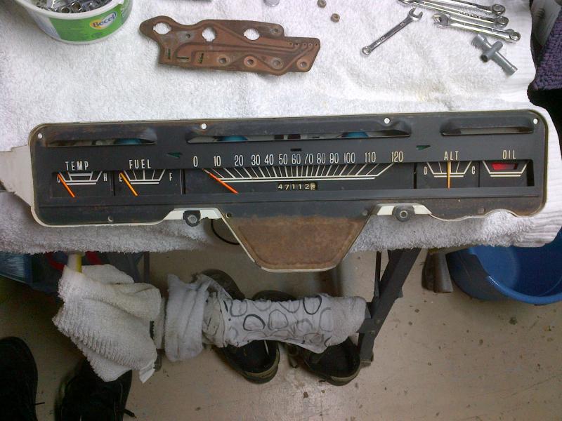

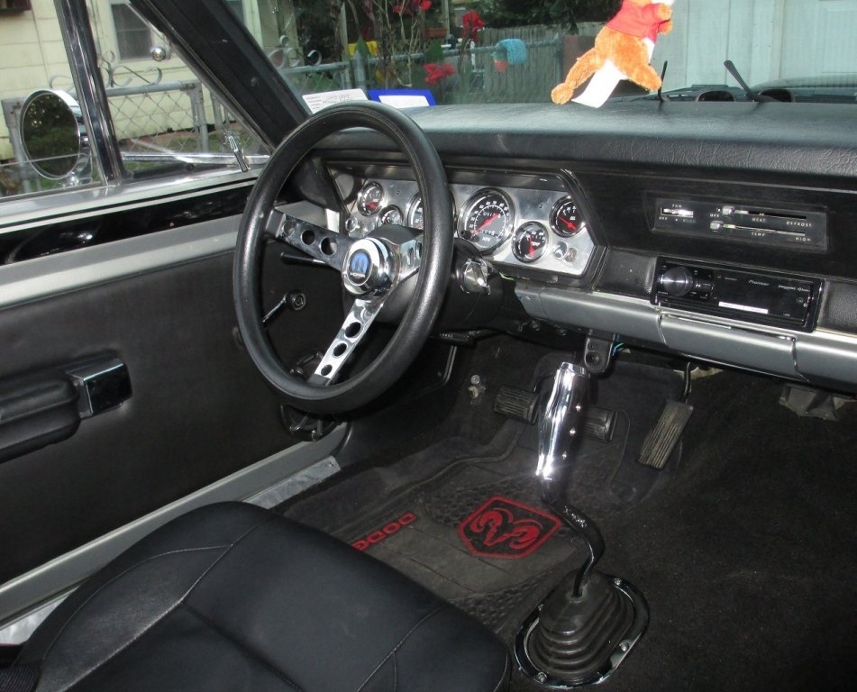

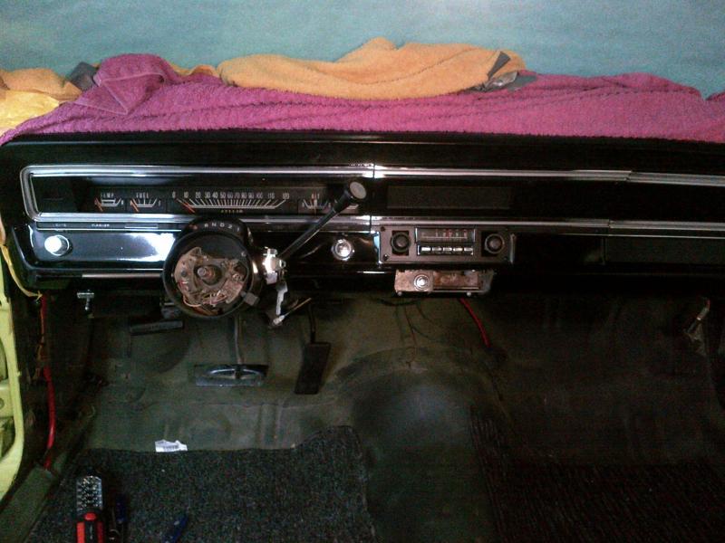

It wasn't a bad swap,going from the '71 to '69 dash. Very pleased with how it turned out.IMG-20151030-01003.jpg

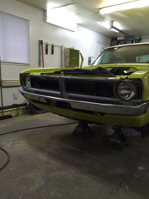

The "to do" list is starting to get checked off! I put in the front end tie rod ends. The only thing left in brakes and suspension is the shocks. Everything sure is a tight fit! lolIMG-20151102-01005.jpg

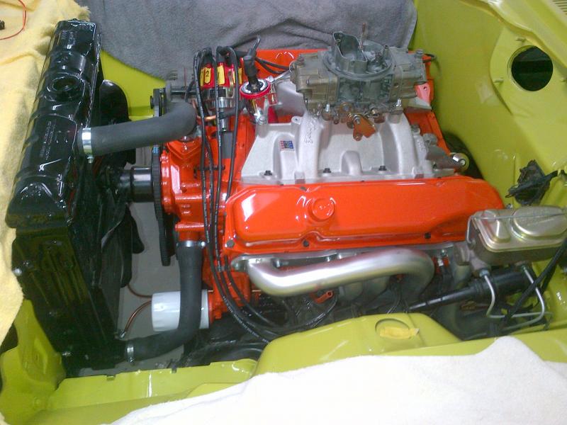

I have it running. I went with one of those ready to run distributors,and the module quit after a couple minutes cranking it over. So we backtracked through the wiring looking for a problem. Thinking there is no way it could be the dist,because we did have spark. After hours of frustration and making a mess of the wiring,I took out the dist,and bench tested it with a different module. Sure enough it was the problem. I decided to bypass it,and use a msd box. Some more wiring to sort out,but the engine sounds good,and the wiring is getting closer! I hope everyone here has a merry Christmas![video]https://youtu.be/M1RHpS1b-zg[/video]

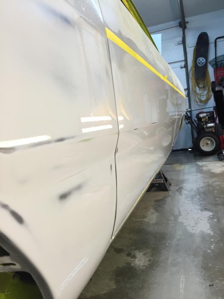

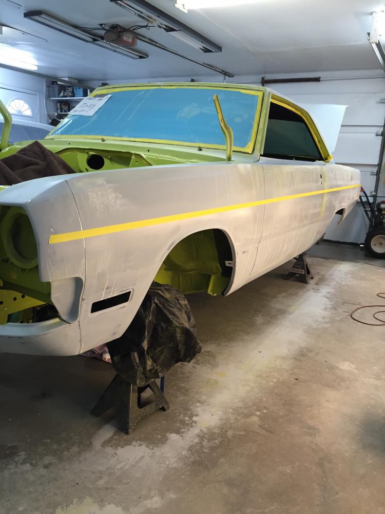

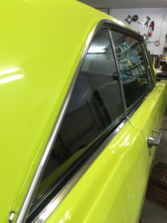

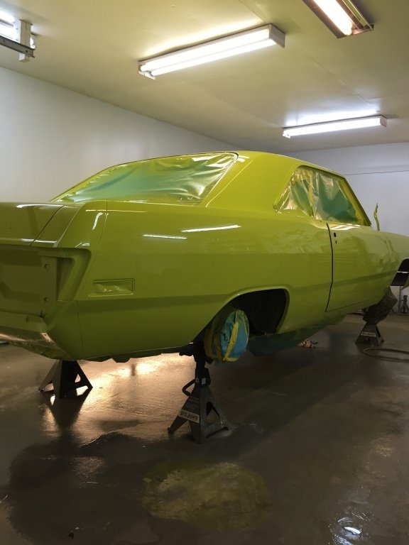

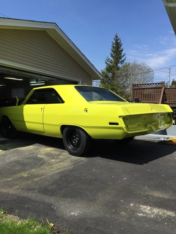

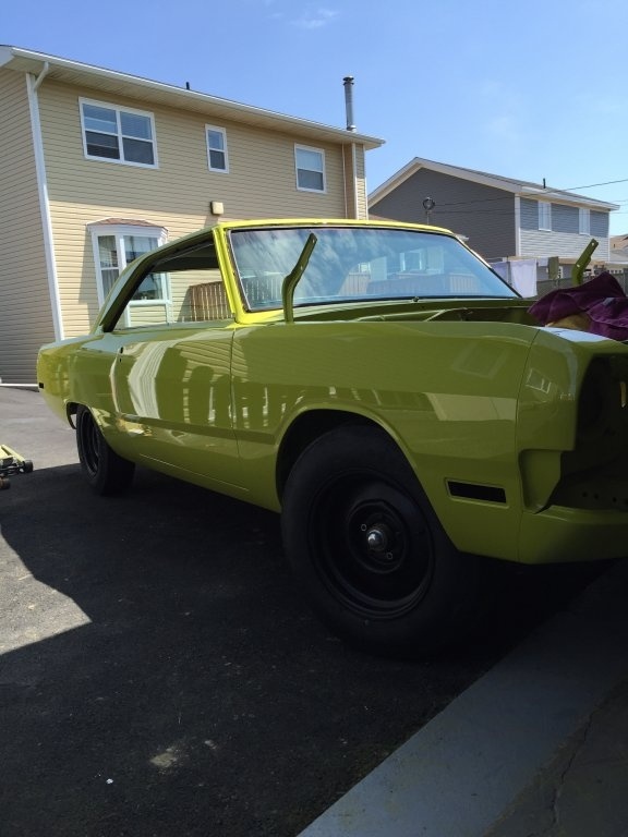

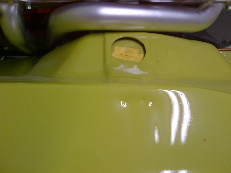

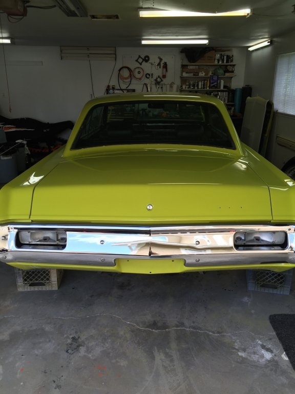

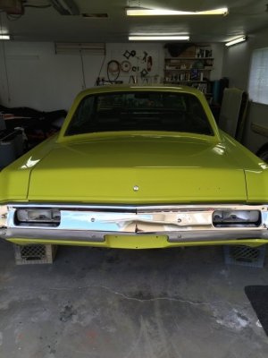

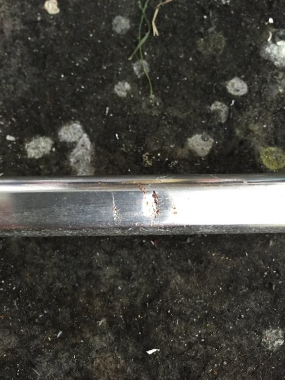

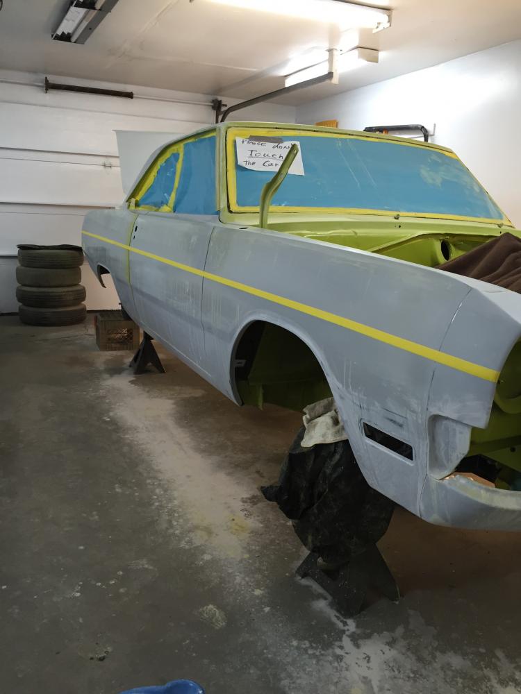

Just a little update: I've been doing the final sand on the body to get it ready to paint. It's all going well,I did have to do a little work on the front valance. And my caps finally arrived! Sandpaper in Canadian funds ,ain't too bad!IMG_0047.jpgIMG_0048.jpgIMG_0051.jpgIMG_0037.jpg

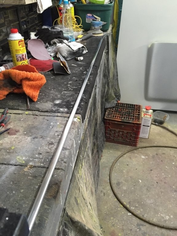

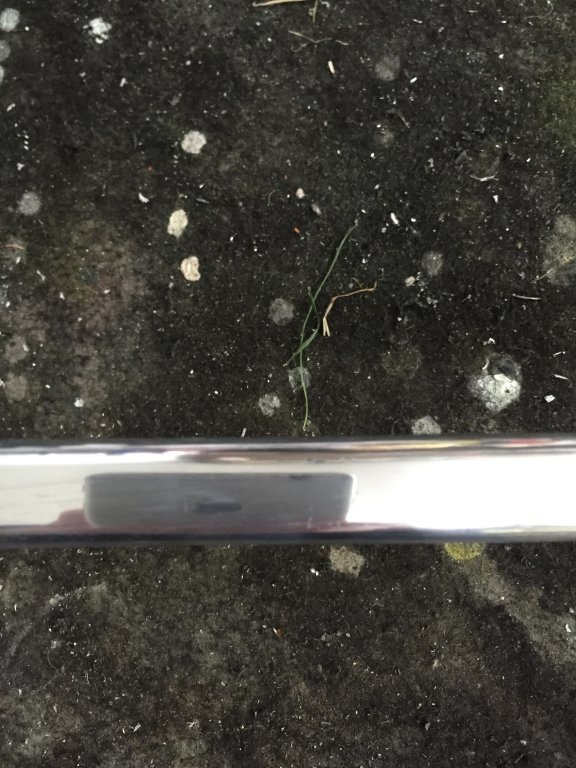

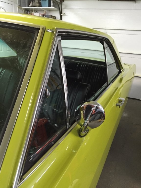

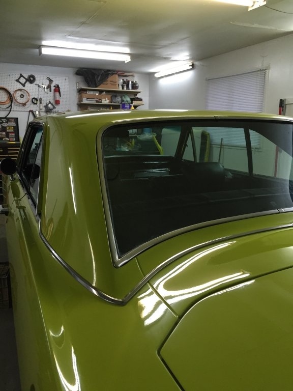

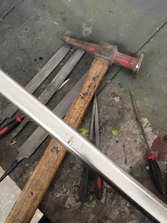

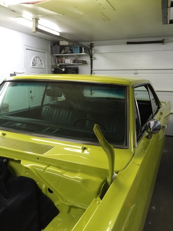

Been busy,doing some pick,file,sand,polish on the rocker moldings. And polishing and installing the rest...
IMG_0432.jpg IMG_0430.jpg IMG_0431.jpg IMG_0433.jpg IMG_0465.jpg IMG_0466.jpg IMG_0467.jpg IMG_0469.jpg IMG_0470.jpg IMG_0360.jpg
