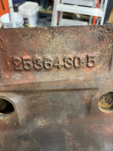

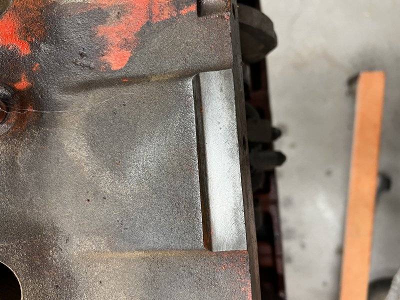

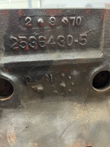

the first picture is the pass side, second is drivers side. The car was an automatic.
He was asking about the VIN pad along the oil pan area. Is it stamped or blank?the first picture is the pass side, second is drivers side. The car was an automatic. View attachment 1792220View attachment 1792221

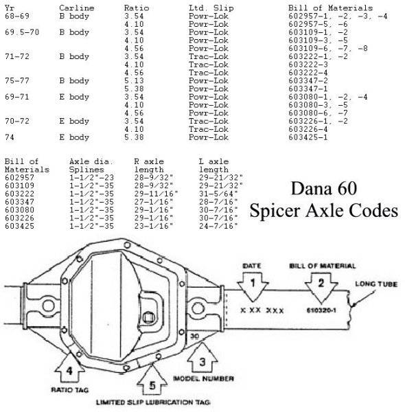

I might be wrong but I thought you had to have the 4 speed to get the Dana unless it had a Hemi with an automatic. There will be numbers on the rear of the tubes usually the right side tube as I recall.I rebuilt the motor in 1995. thats why the inside is painted. The car was an automatic, it was ruined in the fire. I do have the stamped ID pad from the engine compartment. I will dig it up. Where would I find the info on the Dana ?

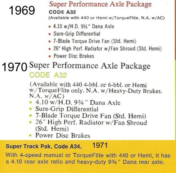

So in 1970 a 440 with an automatic could not get the A32 package. Am I reading that right?
when the porter hammered the gas peddle it went boom and the dealer had to fix before sale j.m.o.I guess it could have been in it already. Did they do that with new cars back then?
NO, was available w / torqueflite only. WITH torqueflite only. Not available with A/C. Couldn't get it with a 4 speed.So in 1970 a 440 with an automatic could not get the A32 package. Am I reading that right?
So what package did the 440 and hemi 4 speed cars get?NO, was available w / torqueflite only. WITH torqueflite only. Not available with A/C. Couldn't get it with a 4 speed.
Not my alley, that's @69Coronetrt expertise territory.So what package did the 440 and hemi 4 speed cars get?
