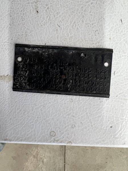

I will look for the numbers on the Dana and the fender tag soon.

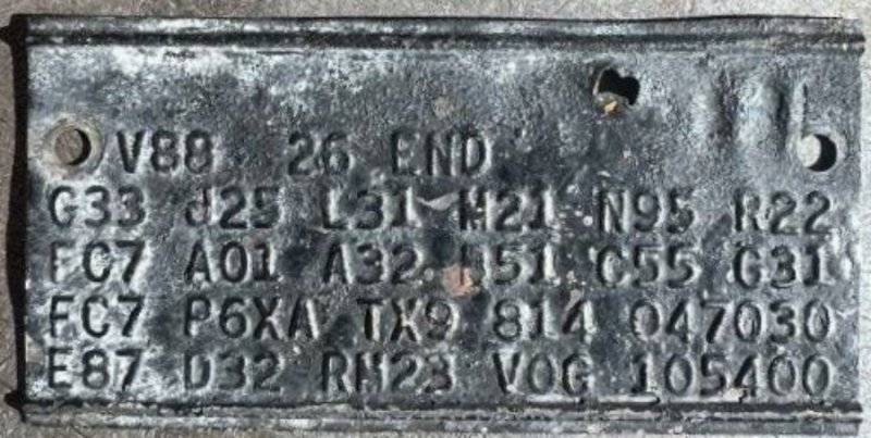

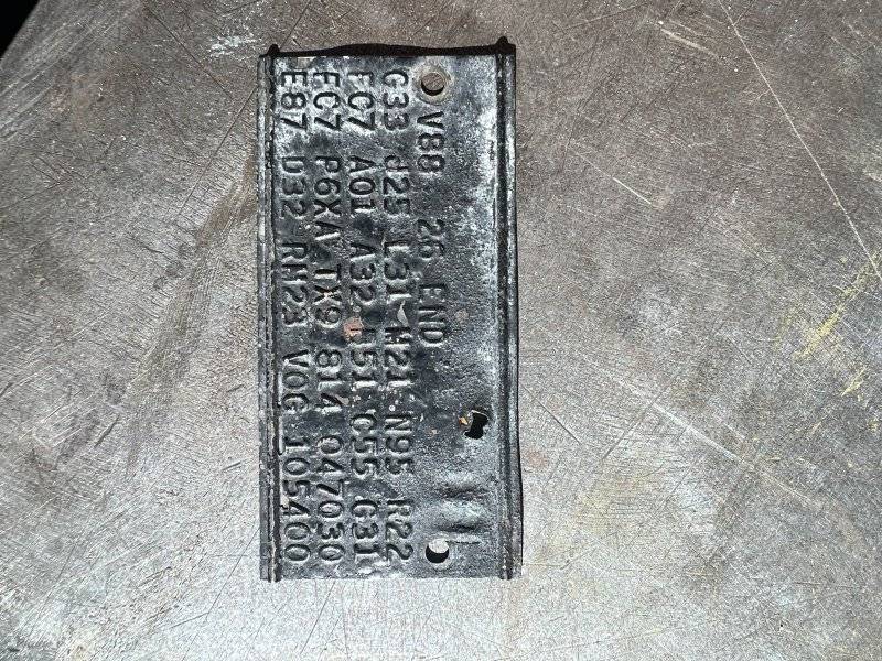

fender tag, I'm interested about this.
If I read that tag correctly that was an early built car. Scheduled 8-14-1969. So that will answer the question on the block as it was cast 2-9-1970. So the car was built well before that blocks casting. So some time after 2-1970 that car had the block replaced. They should of had a black box in those cars.
I did find the build sheet under the back seat. it was in terrible shape, and I'm not sure if it was the correct one for the car. I remember it showed it has a 383 car. the sheet got burnt up.
