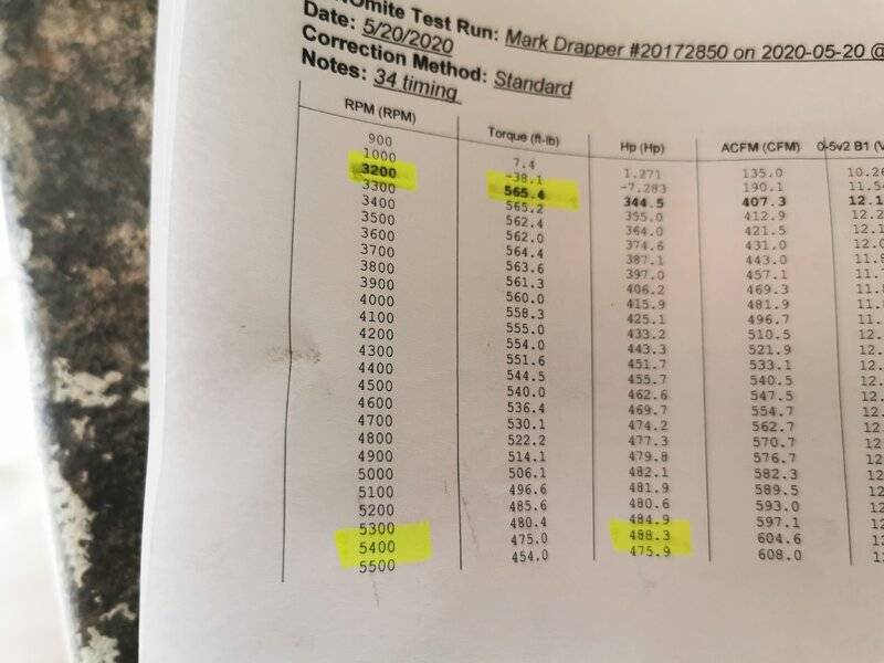

The company that built the tranny make their own convertors apparently. They chose the stall speed(2800)based on the dyno numbers and car weight, etc. So here is one of the problems. The shop that dyno'd the engine has a reputation for their dyno being a little generous. In my engines case, maybe 50hp and 50-70tq. I'll put the dyno sheet below. The car was chassis dyno'd and the rear wheels put down 345hp. Either something was slipping badly, or somehow 150hp was lost from crank to tires. That seems like a lot to me. When I gave the engine specs to two other engine builders, both said that engine, especially with my cam, would never make the power the engine dyno was reading. If the power was off, would that throw off the 2800 stall speed? I didn't know at the time that they have a not so great reputation for their torque converters.
Back in the day when the rpms came out, edelbrock claimed 535 with a similar build but bigger cam. So your numbers with the 268 doesn't sound egregious
Dark fluid means the fluid has overheated or the friction surfaces [ clutches, bands ] have been been slipping...or both. Either way, tranny has to come apart.
I don't know why you would use a stall c'ter with that mild cam, not needed. You just add heat & slippage.
I own a chassis dyno and I think I can help here. A dyno looks at rpm vs acceleration knowing the weight of the drum, so any slip in converter throws off the calculation. I can say that an auto trans with a lock up converter will show about an 18 to 20% driveline loss, vs a stall converter showing an approximate 25% driveline loss.
