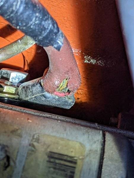

Ok, so it appears obvious the starter gear engaged the flywheel while the motor was already running, and while it did take a little paint off, all the teeth are ok. My neighbor came over and we checked the starter relay(he's way better at this stuff than I am)and while the relay tested out ok, he said these things can go anytime. Btw, it's never been changed since I've owned the car. 9 years. Also, below is a picture of the positive starter wire, and the bare wire was laying against the body of the starter. Now my neighbor mentioned to me that unless you are powering the relay, the starter should never get power, because the relay contact should still be open, unless it's faulty. So I'm repairing the damaged starter wire, and will replace the relay. I hope this takes care of the problem.
The starter can fail internally and also cause it to crank on its own.
That appears to be the case. I've completely disconnected the wires and when connecting the battery cable, the engine turns over.

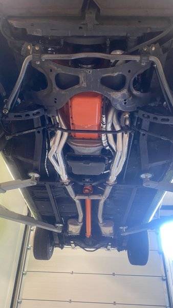

Not sure what brand headers you got there, but for me the most annoying thing in my TTI headers is that the bell housing does not fit between them.
I need to pull the trans, rotate it almost 90deg and then it can fit between the headers down.
Not sure this is the case with all headers, below a picture of mine.
I noticed the same thing with mine, I backed the header bolts all the way loose on the passengers side and zip tied the collector toward the rocker , it give me just enough room to side the trans back. I didn't want to have to mess with header gaskets on the driver's side. Actually, I got lucky in that when i installed the header gaskets I put some Permatex copper on the engine side and when i loosened the passengers side header it came off clean from the block. once the trans was back in i thought, mind as well just try to bolt it back up and only replace the gasket if it leaked, got lucky, all good.
