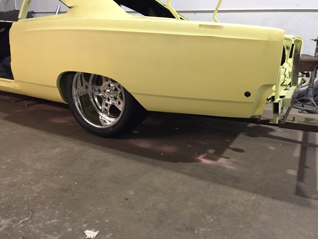

Here is a side shot. Hoping it will sit this low but still waiting on magnum force.
looks good what dimensions did you end up with on the wheels? back spacing ect? also how much did you need to shorten your rear end?

The moser is a 52" flange to flange, its a moser fabbed housing, yukon nodular case, wavetrac 35 spline differential and 35 spline yukon axles. The tires are pirelli p zeros and the wheels are 12 wide with a 4.5" backspace. I am shooting for over a 1000rwhp so it needs to be good parts. I will probably get some slicks for the future but no definite plans at the moment.

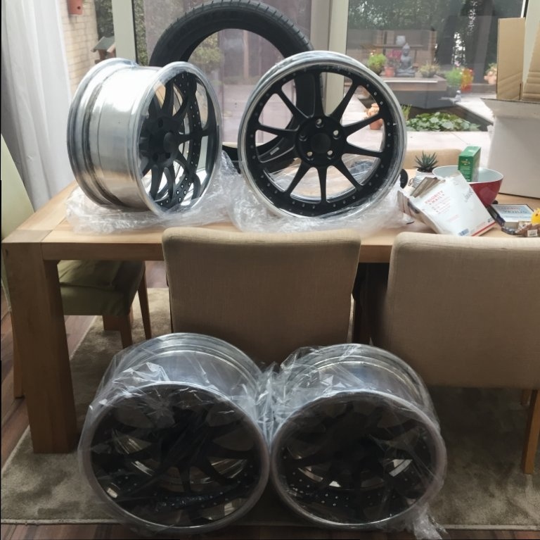

Just picked up my Bonspeed wheels and I'm happy with the results.
Communication wise Brad can learn a thing or two. Delivery time is 10 weeks is what he told me. After 19 weeks I've received them.
Thx, guys. Next week the tires are going on them and then test fitting on the car...

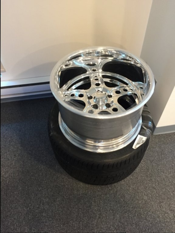

Finally got the tires on them and test fitted them last weekend. It looks like I haven't got to do must fabrication on the body.
