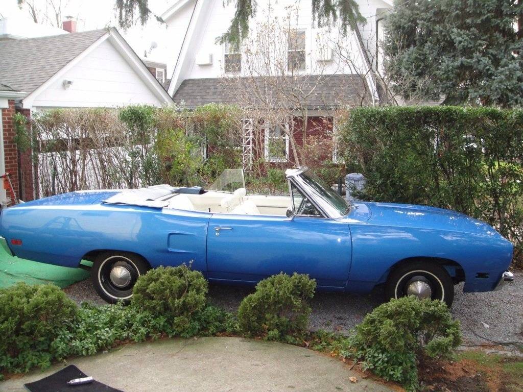

The next question is wheels and tires. I currently have 14" police rims with dog dish hubcaps. I want plenty of clearance for the disc brake conversion so I'm going to step up to 15" tires and probably rallye rims. I think ride is better too and definitely the look as the wheel wells look a little empty with the 14's. Any size suggestions? My 70 RR had 225/60/15 front and 255/60/15 rears. Should I go bigger on the rears? How big can I go? Here's a pic of how it stands now on the 14" police rims.

I think those Summit 15x7 rallye's look really good and appear to be pretty close to the OEM wheels.
