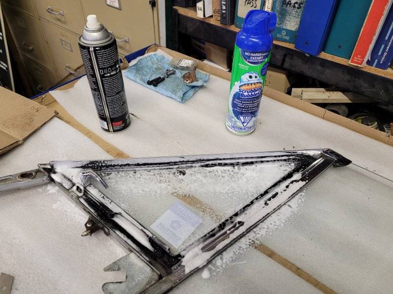

Not much done today after losing 1/2 the day to following my tree markers around the property, but some scrubbing bubbles to clean up the vent window seal.

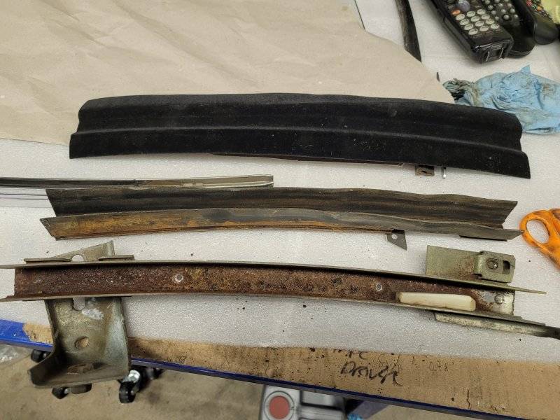

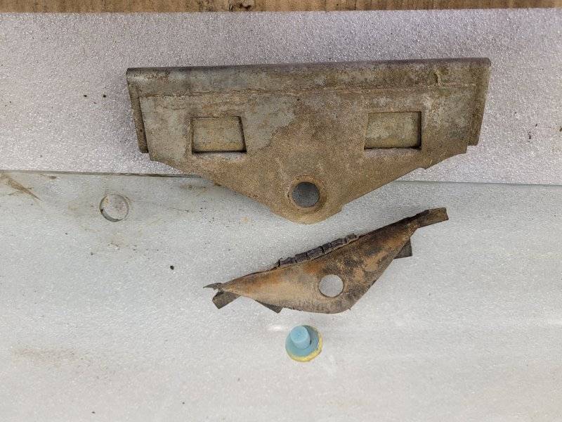

Regulator bracket channel needs to come off.

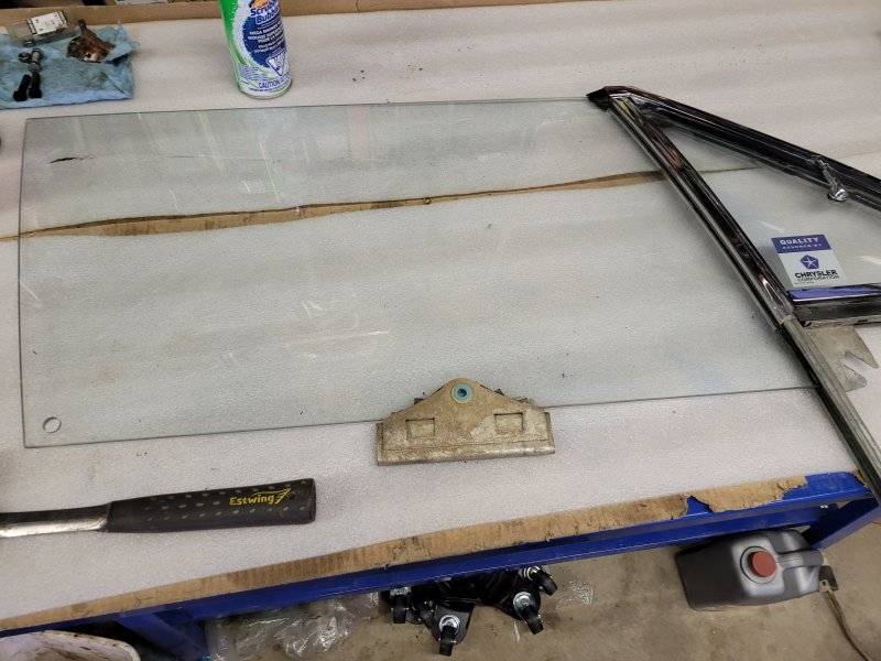

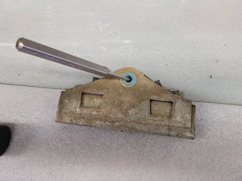

Quick rap with a punch to remove the center mandrel.
Rivet, gasket, bracket and glass.

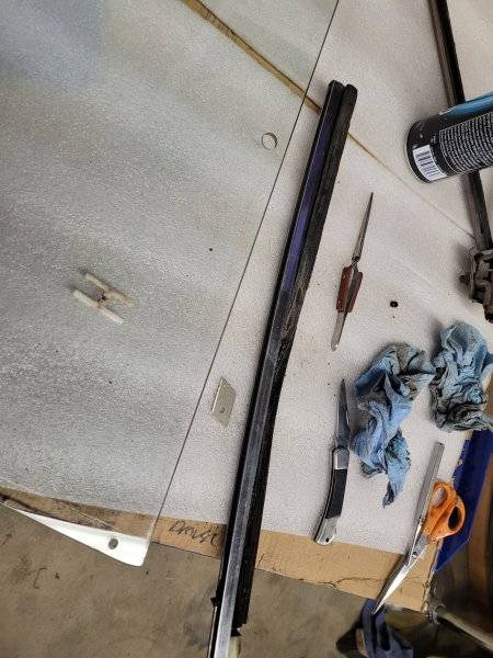

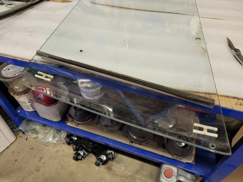

Managed to save the "H" slider pins on the slider mylar on this one. The mylar itself it toast after 53 years.

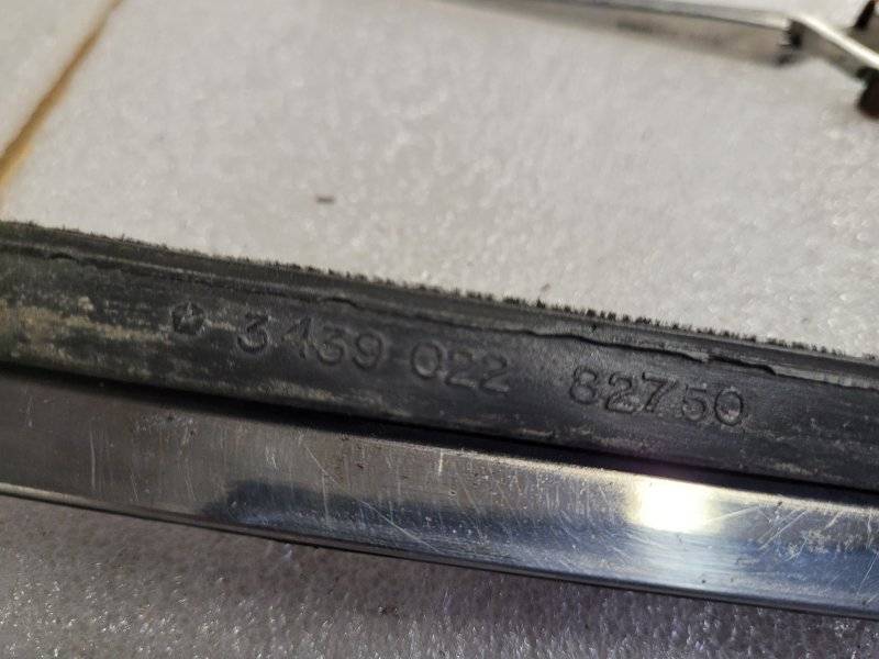

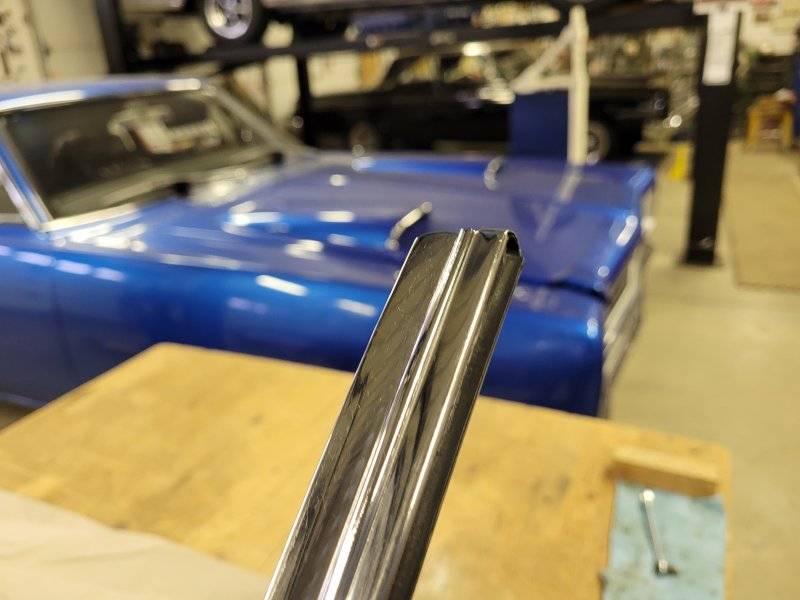

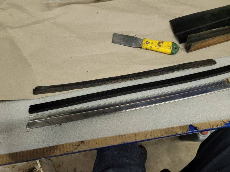

Pulling the OE door glass to quarter glass seal out of the stainless glass trim edge, seeing the trim edge fell off during handling. I was hoping I didn't have to reset it, but **** happens. I'd bought a "new" piece of trim off an FBBO member for this side, as mine is dinged at the top, but turns out what he shipped me is a drivers side.. ffs.
3439022 is the original part number 82750 the vendor.

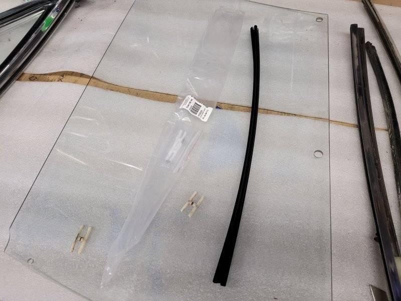

New 32230 mylar ready to punch holes for the slider pins, cut to length and install.
How long do you leave the scrubbing bubbles on there?
A minute or two and then wipe. Stuff is the BEST cleaner I've ever used on vinyl roofs. It lifts the dirt out of the grain...

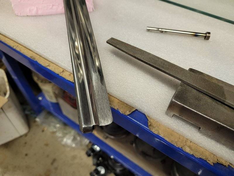

I'd bought a used door glass rear edge trim for the "passenger" side, but turns out it's actually a drivers side. So I guess I'll fix the one off of the car that's been damaged since I bought the car. You'd swear it went through a pop machine...

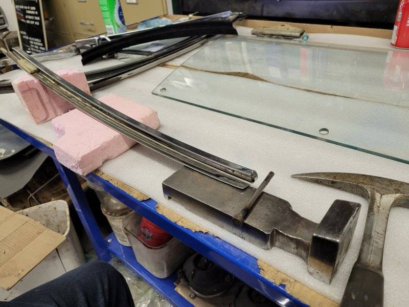

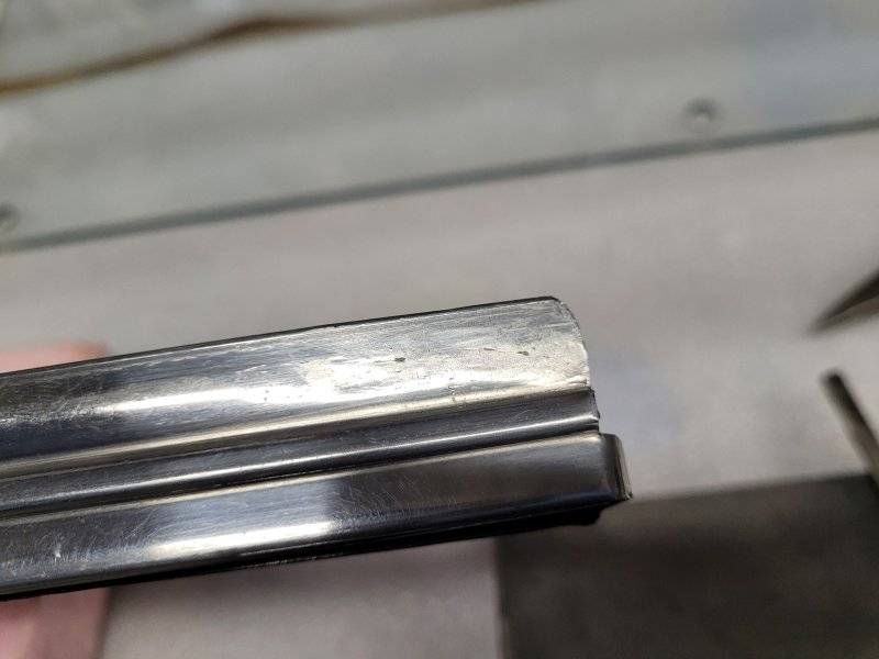

Full of dings and dents so I punched those proud from behind.
File all the lumps smooth.

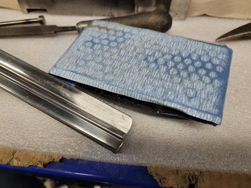

Work through the sand paper grades starting with some 220.
400/800/1000/2000
Then onto the buffing wheels with Black on the hard wheel and green compound on the soft.
Guess that'll do !

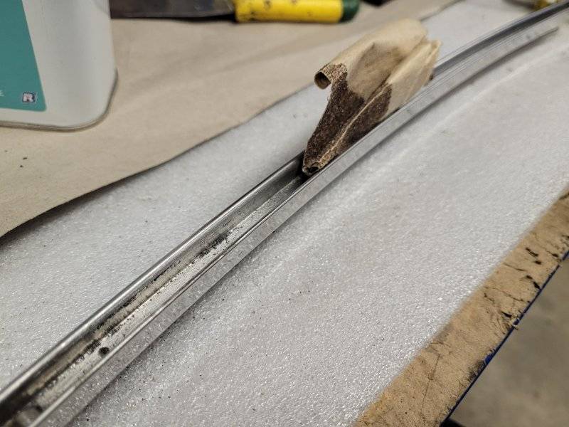

Need to run the glass rear guide channel through the blaster before installing the new rubber/felt.

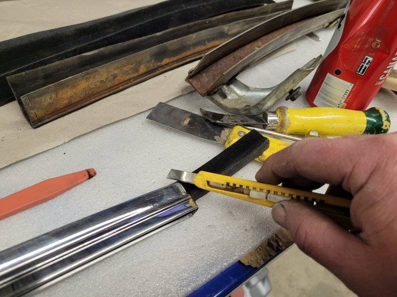

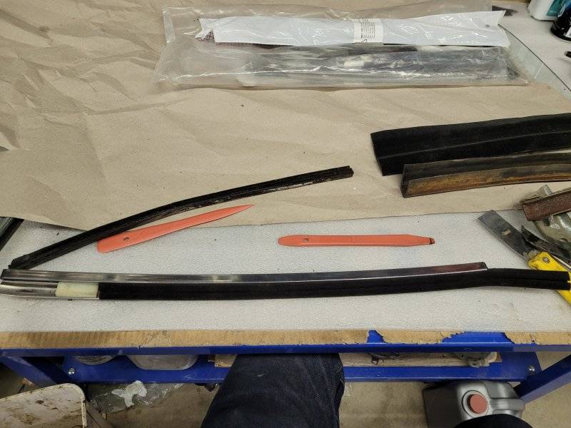

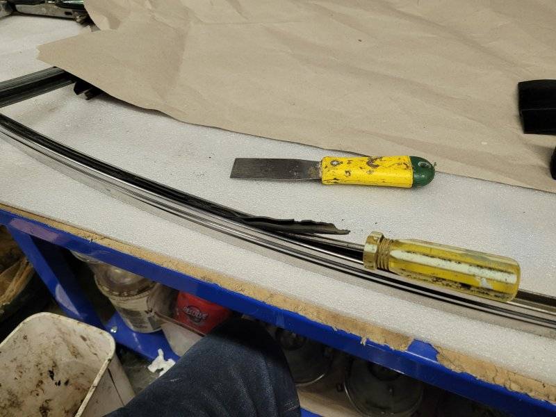

Removing the glass setting tape from the glass rear edge trim. This one let go a lot easier than the drivers side did.
Quick clean with some 80 grit so I can reset the trim onto the glass with setting tape.

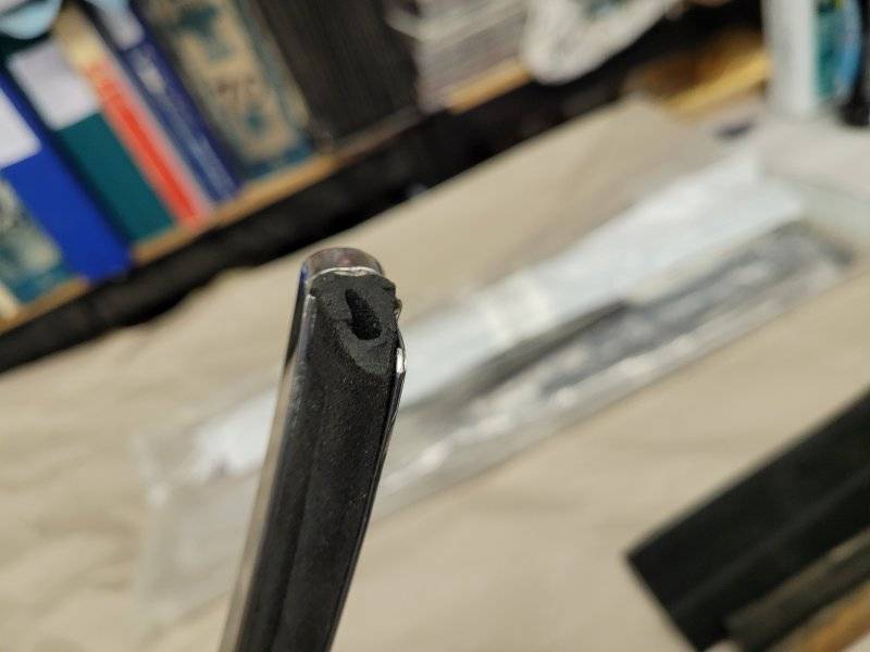

New flocked seal ready to go into the trim.
Seal pushed down into place and then the small lock tab forced into the trim with some plastic trim tools.
