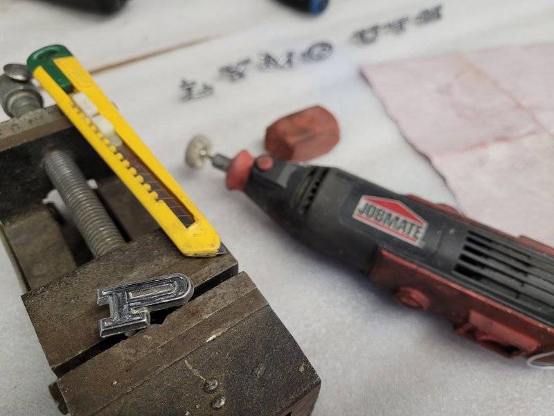

Figure we're this far in, time to clean up and repaint the PLYMOUTH letters for the tail light panel. Chipped Exacto knife blade to scrape out the paint and Rouge compound and the dremel to polish the chrome.

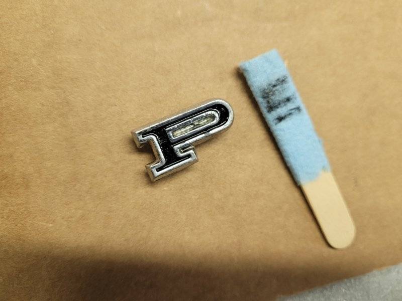

Spray paint in the cup and a sharp toothpic to "paint" with. Dip and let the paint run off and flow out level in the letter.

Three letters done.

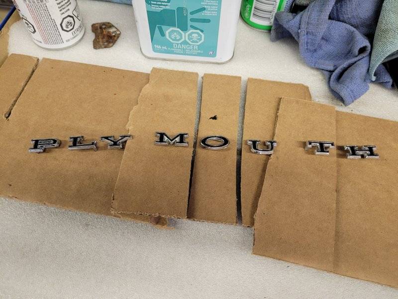

4 more letters cleaned and the H bringing up the rear.

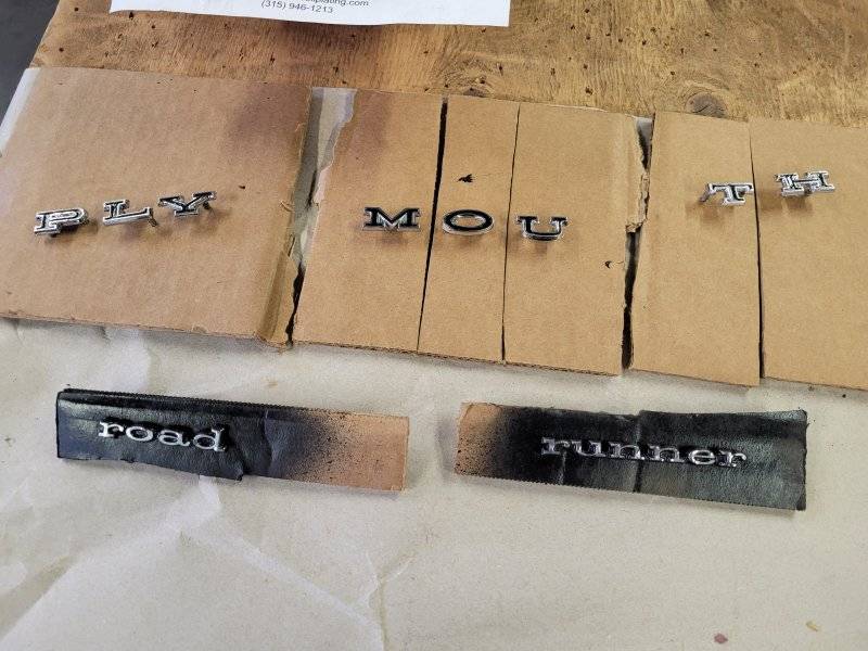

All 8 letters polished and then painted.

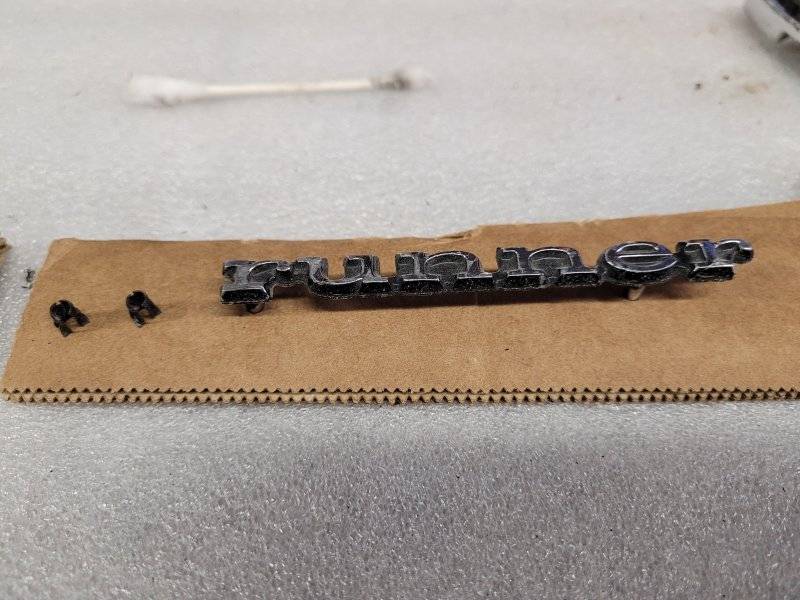

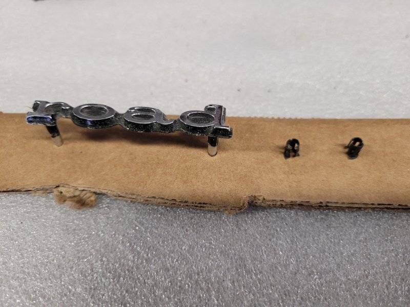

Might as well do the road runner as well. I polished it before Taladega in 2019, but it could use new paint.
runner... with the retainer ferrules removed.

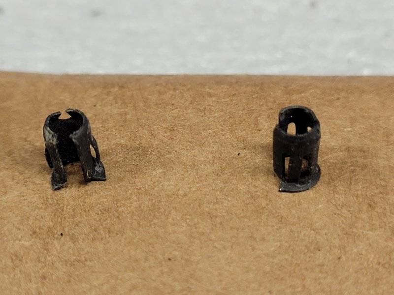

What the correct retaining ferrules look like. They go into the trunk lid holes and then the road runner emblems are pushed into place.

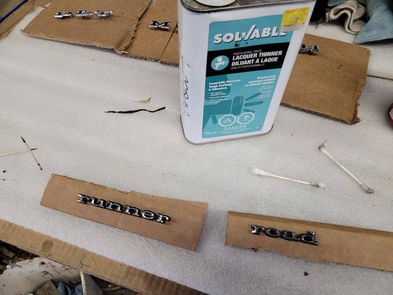

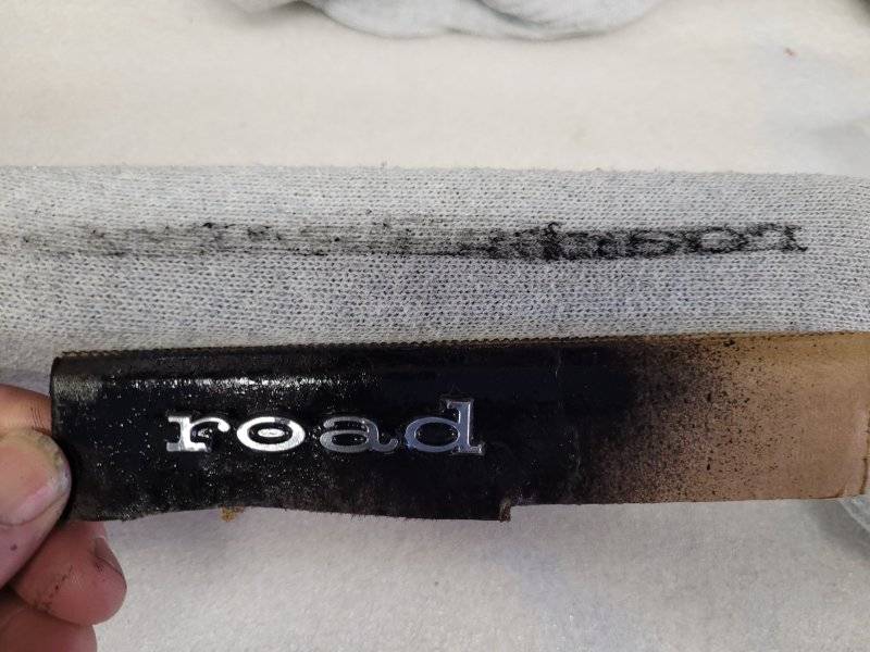

Scrubbed with lacquer thinner and ready to spray with Black paint.

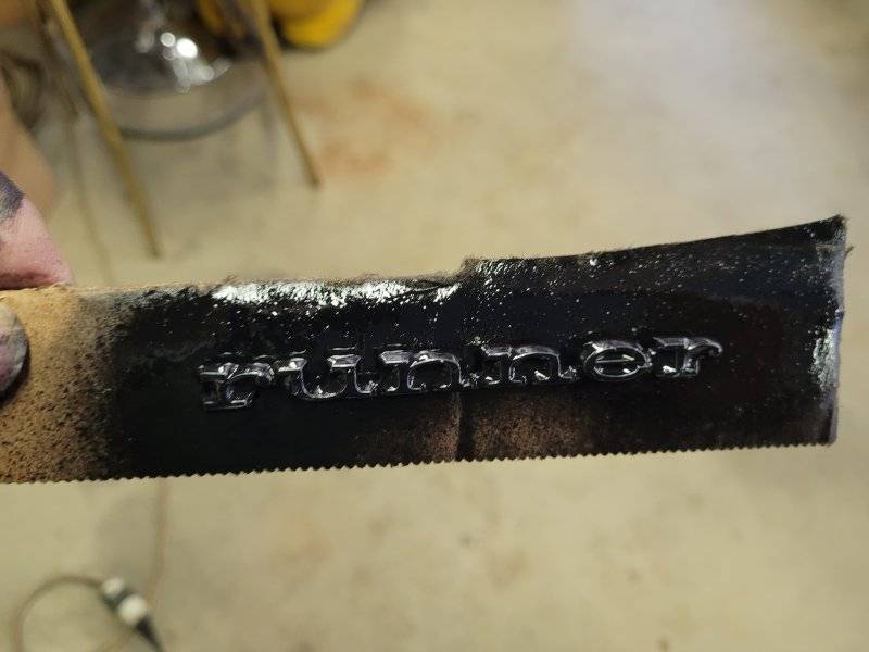

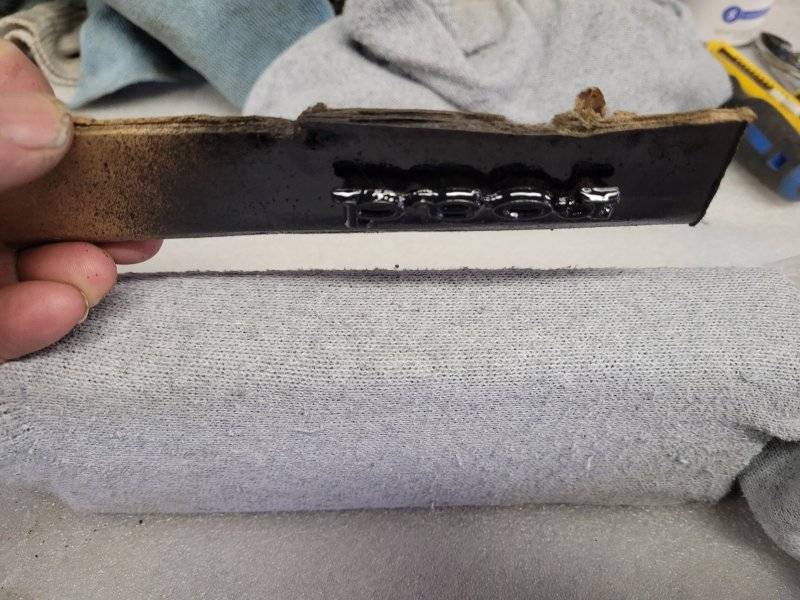

Painted and then rubbed across a sock with a 2x4 inside.
Sock takes the majority of the paint off the chrome face and then a bit of careful wiping to complete.

Script and letters all done. The letters took almost 4.5 hours. The scripts.. 10 minutes!

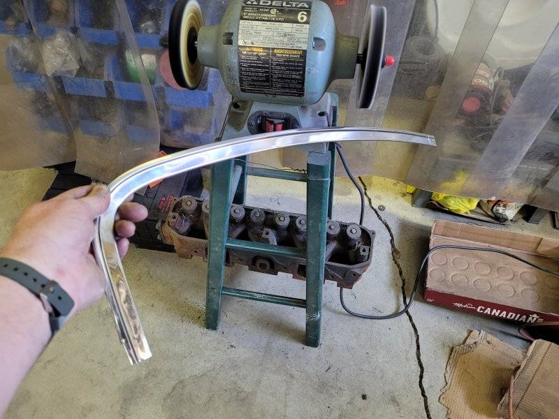

Polishing up the window trim removed from the lower front and rear glass.

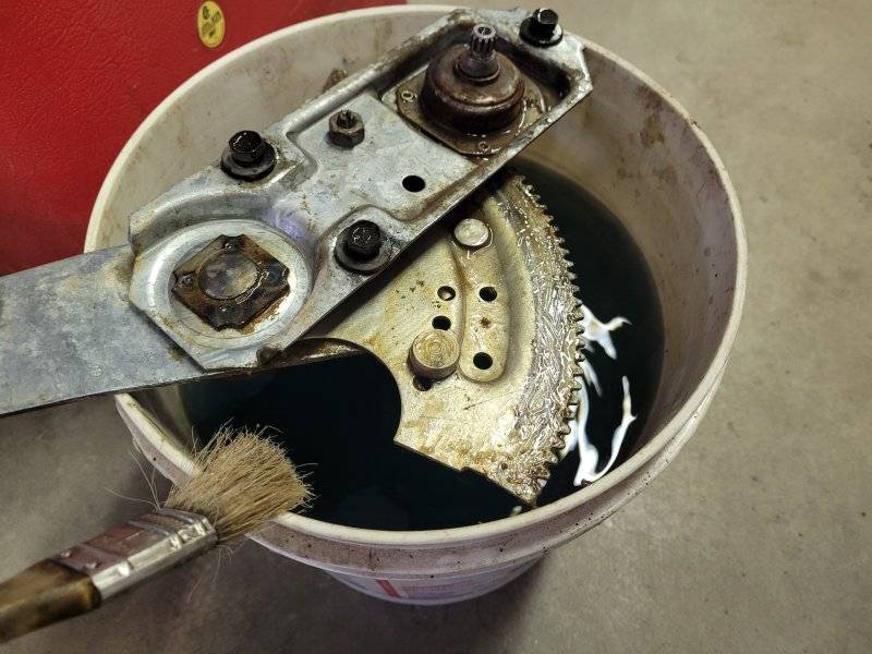

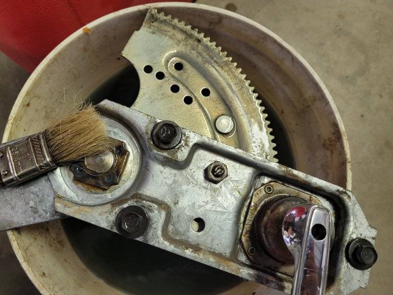

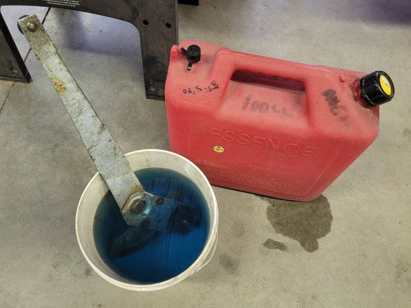

I still stay 100LL AV gas is the best degreaser ever produced.. and cheaper than anything off the shelves. Soak the window regulators for 5 minutes and the old grease and goo flows off with very little help.
Quick brush and the old grease is gone.

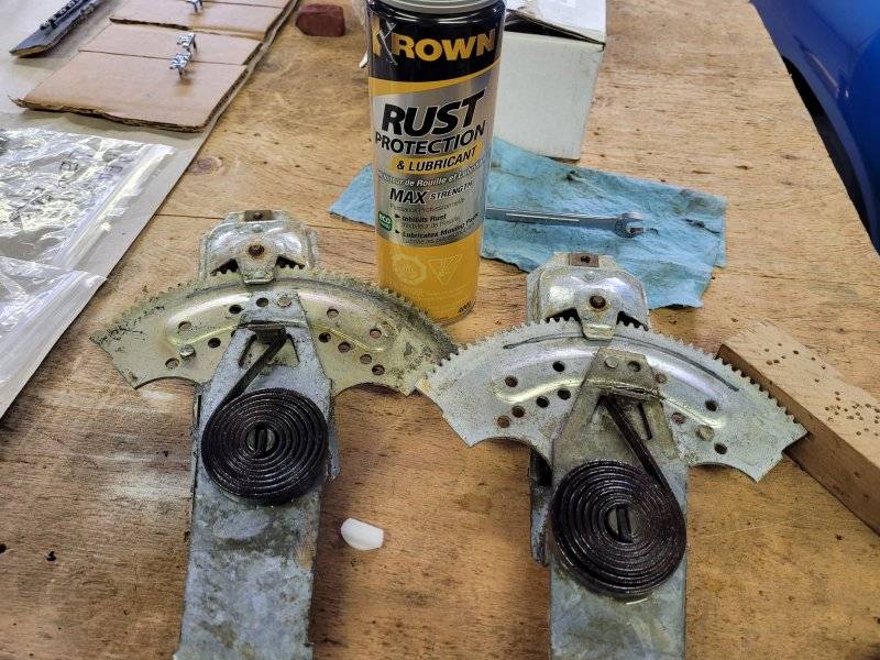

Cranked the regulator around and cleaned everything.
All clean, springs, gear drive and bushings sprayed with Krown. Total, a 30 minute job tops. Just need some fresh grease when they go back into the doors.

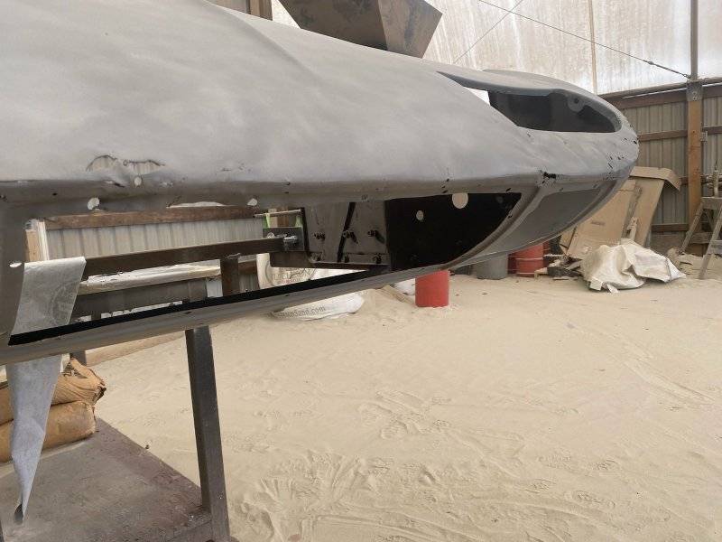

Now we're thinkin outside of the box!! Mounted to the table and ready for body work,

Looks pretty damn good, but we know from stripping it out and looking in the back, that there's a lot of "cheese" in the front!

Down back to the media blasting "cover all" building to reveal all the "stories"! About the same as any Bird nose I've seen that the owner was willing to share before paint!!

Nothing surprising, I knew this car was hit in the front left in the 70's.

Just shows what the Picasso from the past was able to do with plastic filler... Your gonna have a better bird when this is in the rearview... Not that it wasn't nice before... But it had "stories"...
Like I said. I have NEVER seen a Bird nose that wasn't banged to **** prior to paint, from any owner that was willing to share pictures. Drue has been doing metal work for almost 40 years and does amazing work. He can barely walk as his body is so "tweaked", but glad he's got at least another few weeks left in him!
