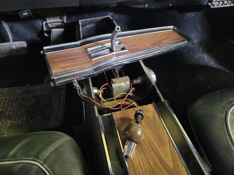

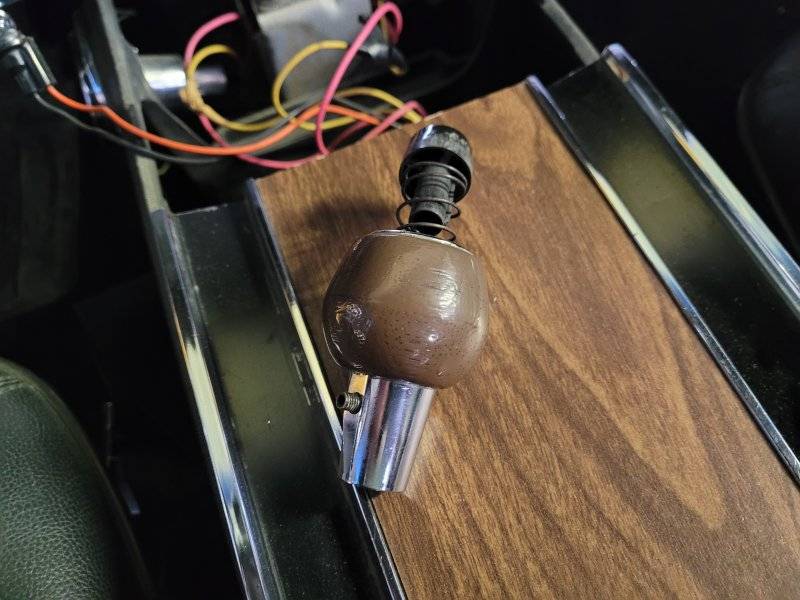

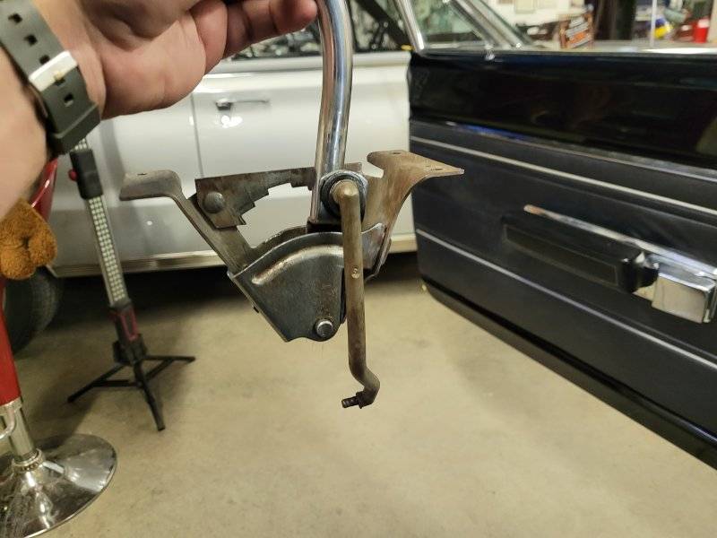

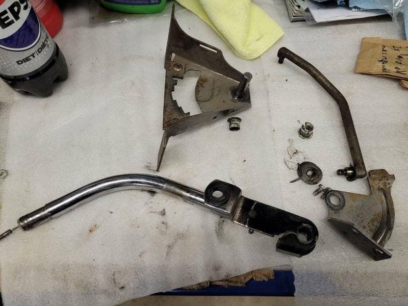

Exacto knife around the washer before turning the nut and a careful lift. Then a new nut on.
Shifter mechanism out.

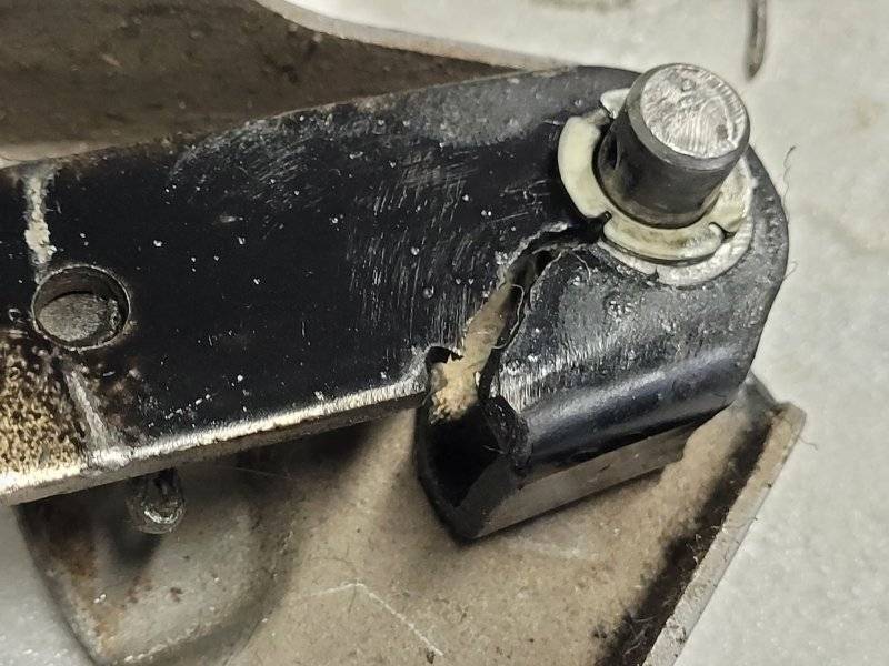

Looks like I did so just in time... or I guess 1.5 years too late...
All the parts.

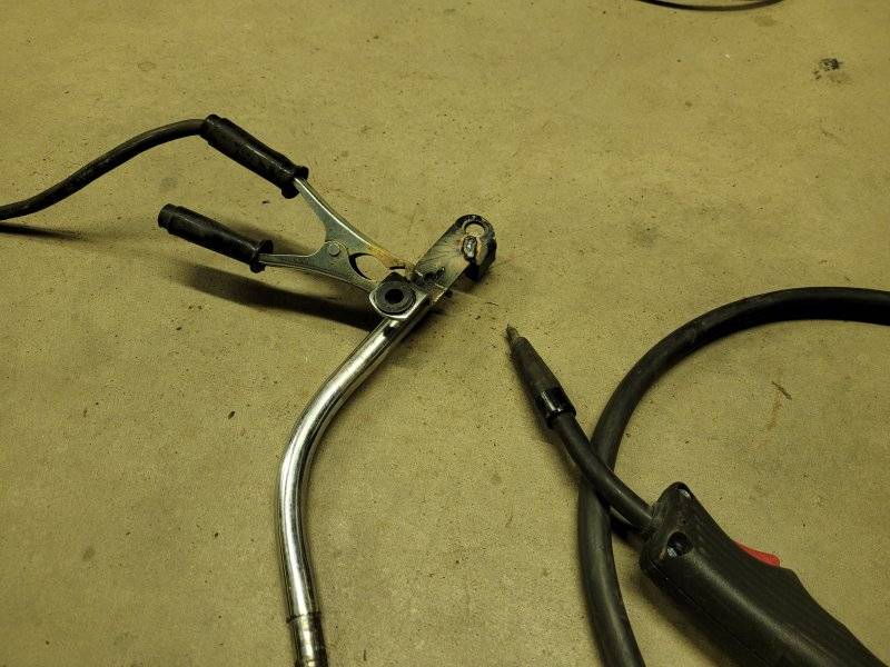

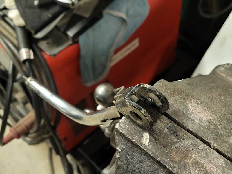

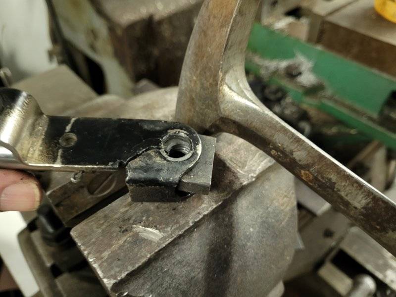

Reformed the pivot end somewhat so I could weld up the crack.
Quick MIG on both sides.

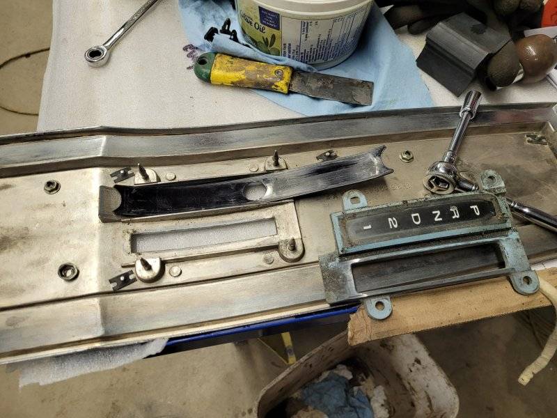

Welded, ground clean and finishing up massaging things to the correct shape.

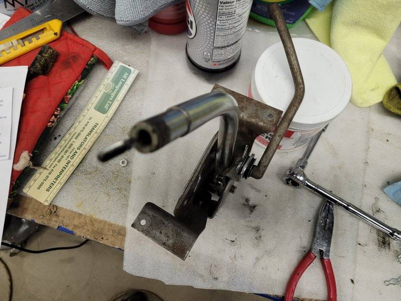

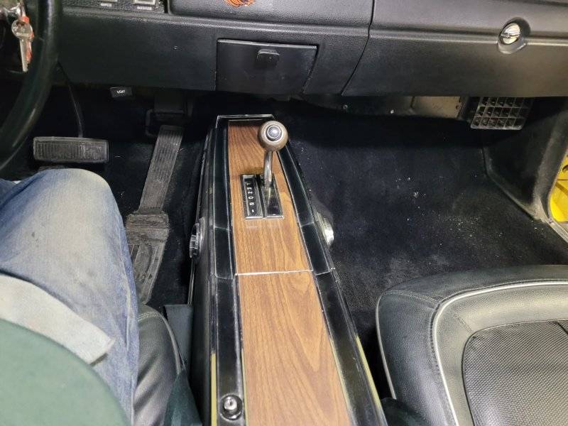

All reassembled, ready to put back in the car.
Figured I'm this far in, may as well clean the console and gear selector up.
All back together. Minimal play in it now. Now I need to get underneath and fine adjust the shifter linkage.

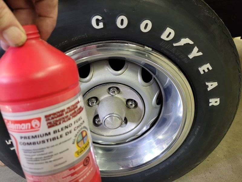

Best White letter cleaner ever. 34 year old tires. I bet when my new ones get here that they yellow just like **** BFG tires have for over 40 years. Even this stuff won't clean them...
All the parts.
