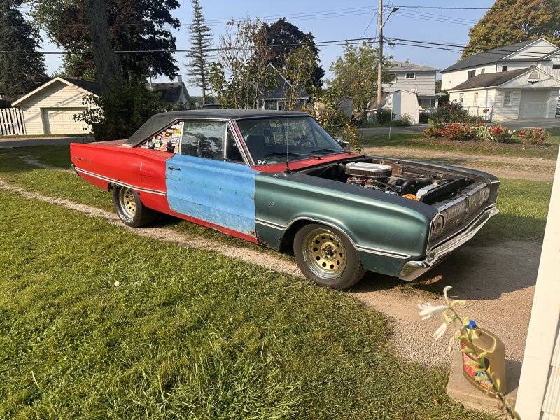

I am sure this has been discussed before but I would like to hear from others what known upgrades (with a lower budget) I should be on the hunt for. I am 23 years old and only had my Coronet for 3 years and I believe I’ve made a post about it a while back but I’ll go over what the current setup is
1967 Dodge Coronet 440
- 1978 440 Block, crank, rods and pistons
- Purple shaft 474 Camshaft with new stock springs
- “516” closed chamber heads
- Edelbrock Torker 440
- Holley 700 cfm Double Pumper
- stock refurbished hei distributor with GM module
- iron flywheel and diaphragm style clutch
- 1.75 long tube headers
- 2.5” exhaust with purple hornies mufflers
- 1964 or 65 23 spline a833 (flange style)
- Yukon 489 case with 3.23 suregrip
- 28 x 8.5” Hoosier Slicks
- power steering
- manual 10” drums front and rear
As the car sits without me in it it weighs 3910 lbs. I know for sure that the stock pistons need to be addressed and the cam is very small. This was the first time I took it to the drag strip and it ran 15.154 at 91 mph. I will that elevation was over a mile so in reality it should be a high 14s car. Just wondering what would be my best price to performance upgrade path since I’m rebuilding the motor and trans this summer.
