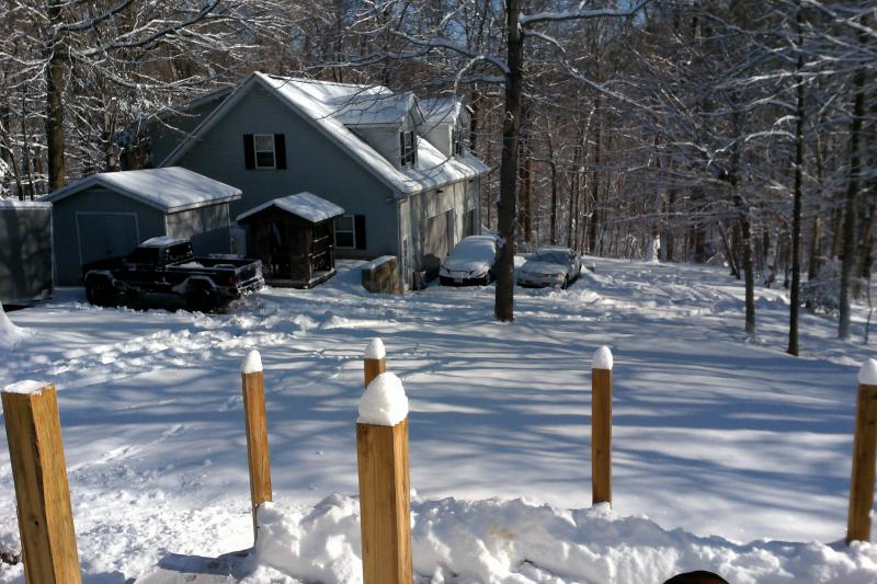

Here's mine. It's 28 x 44. I was limited to 1250sq ft since I'm in the city limits. If I were in your situation, a 30x60 would sure be nice. I put in an exterior entrance for the attic as I'm not getting any younger. It's 4' wide and is really nice when hauling up hoods and fenders.
Love the upstairs steps! Hmmmmmmmmmmmm, I live on a hillside and it might be possible to make a ramp into the upstairs? Beautiful shop Hemi.

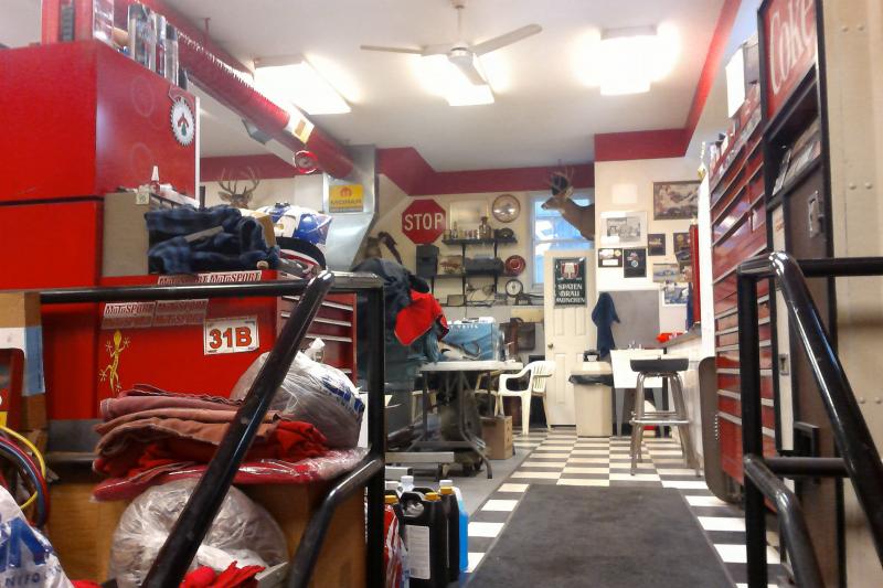

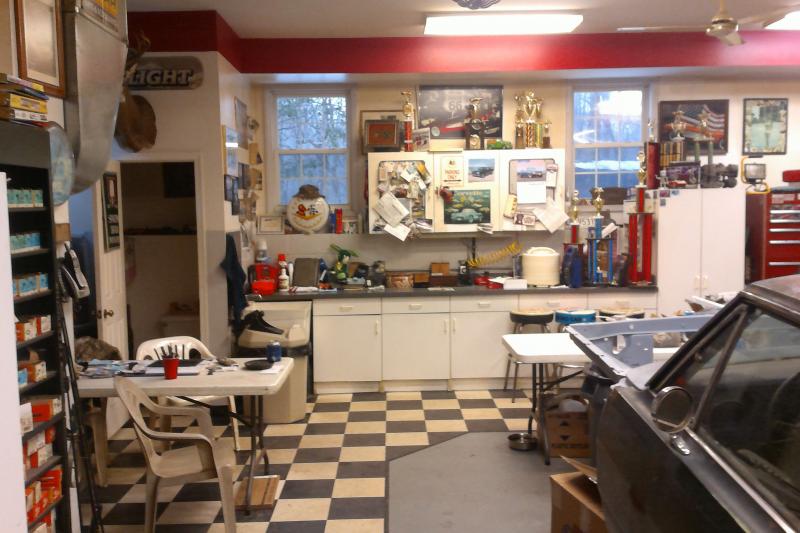

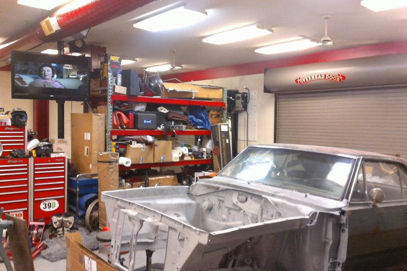

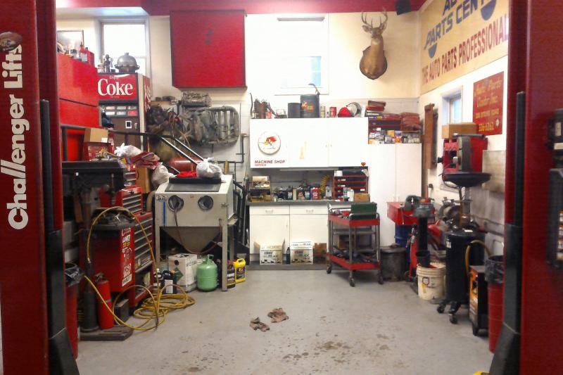

Mine has HVAC with LPG back up heat. Plumbing, Lift in lower bay, because the property rolls downhill on that side. Allowed for 14ft ceiling in that bay for tall lift. Also has 2 bedroom, 2 bath 1400 sq ft apartment upstairs, completely separate, with full amenities .
Obviously the shop is on my 3ac homesite. I have mentioned to the Wife, that when we get older, we can get the renters out of the apartment. Move into it ourselves, and rent the big house to someone that will handle all the property and building upkeep. I gotta Plan !!
