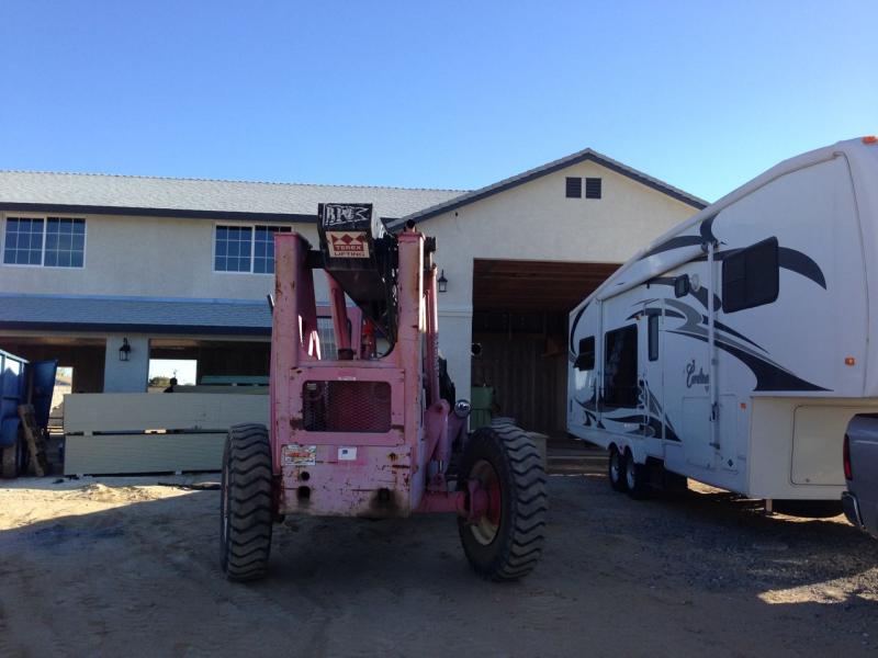

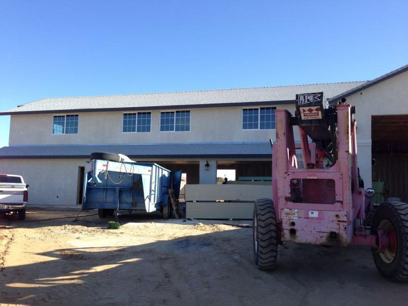

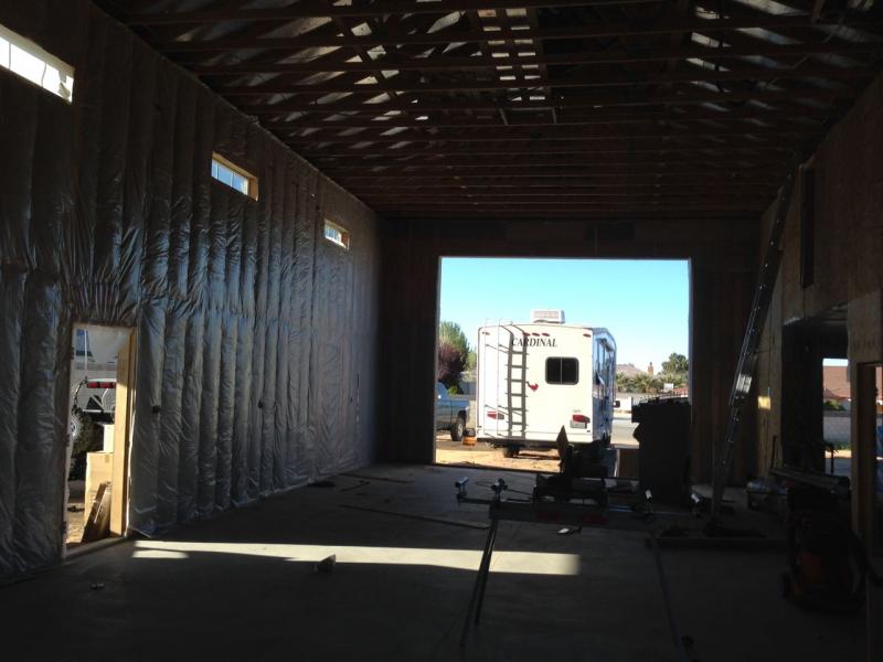

My "Buds" man cave and garage
The RV portion is 60 Ft deep with a Lift at the end.

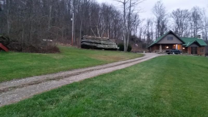

This pic gives you an idea of where it will be in comparison to the house, far enough away for me to be noisy. It will sit to the left of the rock.

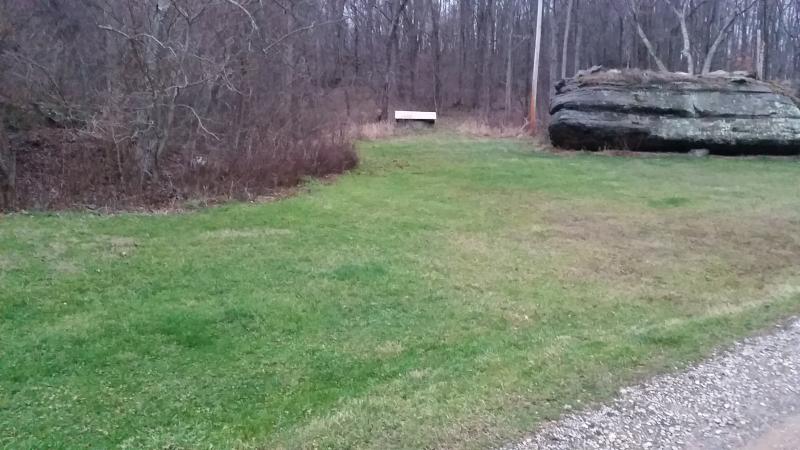

And this shows the spot, I'll clear everything to the left but there's a small spring there that will need some culvert and leveling (not building on it just cleaning up). Also notice the handy location of the electric pole and the easily available spring water tank!
