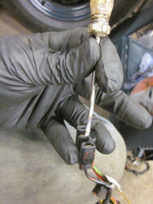

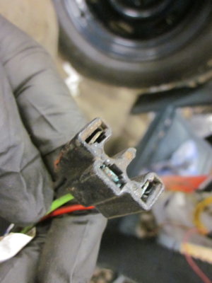

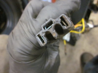

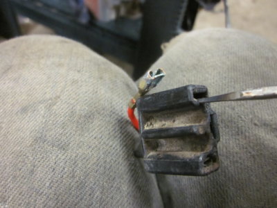

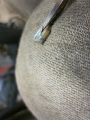

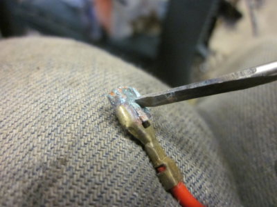

Here's a few pics from some recent work I did on the 64. The highbeam switch connector usually sees a lot of moisture and can get nasty. Just spraying it did little to remove the oxidization.
