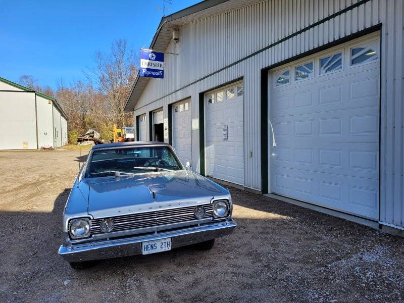

A tad steep. I thought paying $1400 Canuck bucks to do my Bee rear bumper 5 years ago was steep, at the highest rated shop in Canada. Satellite front bumper is fairly simple in shape, but thankfully someone else paid to do this one.
A tad steep. I thought paying $1400 Canuck bucks to do my Bee rear bumper 5 years ago was steep, at the highest rated shop in Canada. Satellite front bumper is fairly simple in shape, but thankfully someone else paid to do this one.View attachment 1370597
Yea I thought so too, was hoping for under $1400.
Typical bumper no damage no rust through top lip is showing through chrome in spots. They had someones 50's Chrysler 300 all Chrome and stainless estimate at $32,000, ouch. They were going ahead with that job.
