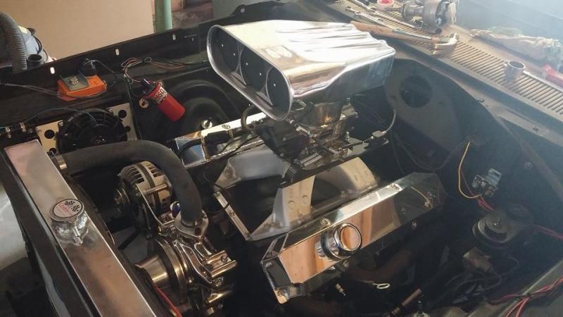

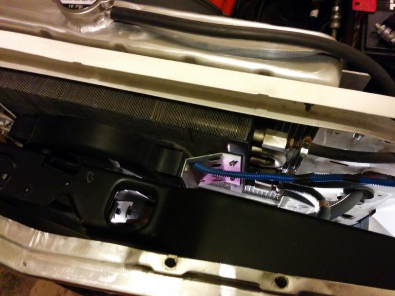

i have had the trans fluid mix with the coolant problem back in the early 90's.ever since i run external coolers only.just make sure you get one big enough for you application. 10411292_237489503112653_6391885681296785854_n.jpg
that is my newest project location.see the fan just pass the upper rad hose?

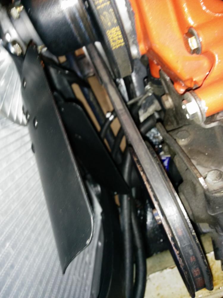

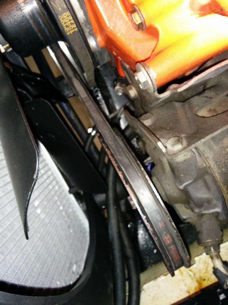

Whoa, you went from over cooling to cooking the fluid? A 2500 stall converter is mild and shouldn't make that much heat. Post pix of your setup, you sure it's plumbed correctly? Some of the coolers have check valves in em to prevent drain back and thus only flow one way.
Besides, don't get too down, puking tranny fluid ain't the end of the world.

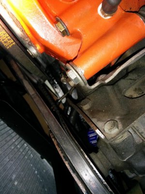

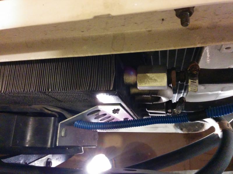

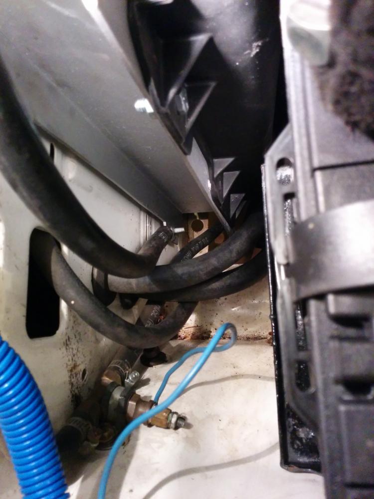

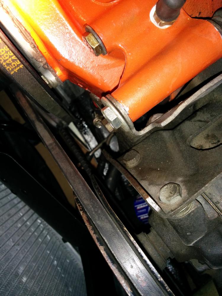

To be honest, I'm not 100% on the lines. I don't even know the brand on the cooler. It's something that PO had installed. I'll post pics.
The tranny line toward the front of the tranny is the 'out' or hot side, the rear is the return or cool side. Find out which one goes to the top of the cooler. Also, that cooler is an inefficient pos, get a b&m plate-type supercooler - best cooler technology for the buck.
How is that cooler fan wired? Is it always on?
Lol, btw, you're right, those pix suck.

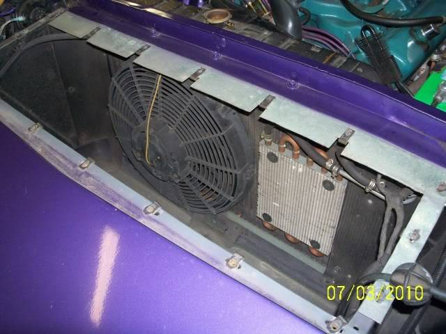

here is mine..5/16" lines to trans, by-passed radiator, been on there since late 90's
