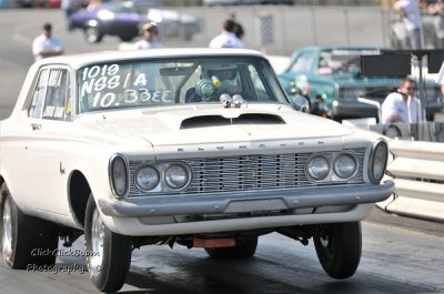

Get some Caltracs mono leafs stock height, 22 inch Caltrac bars and single adjustable QA-1 rear shocks if your budget allows.
You'll have adjustability and if you have questions Caltrac has great customer service.
See results of the above setup being used in the pic below.

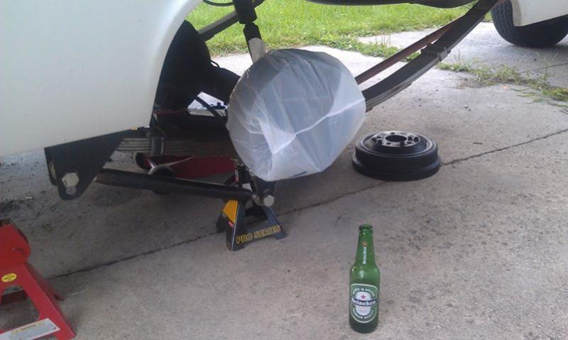

67-b, do you have any pics of your home made traction setup. thanks john.

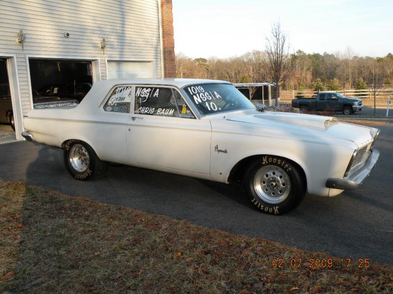

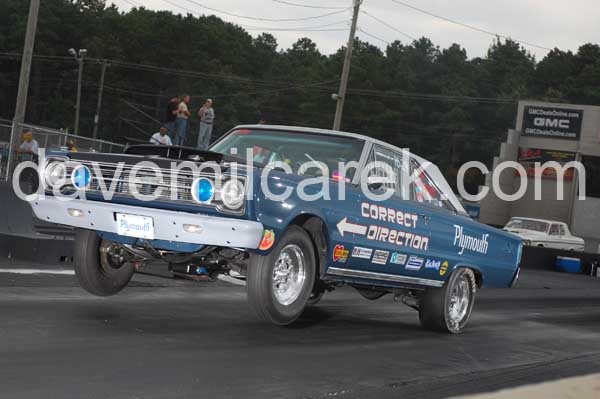

I DISAGREE WITH THAT. GET THE DBL. ADJUSTABLE COILOVER FOR THE REAR.
also GO WITH THE 1" under stock ride height mono leafs 22". Ive been down that road before, with Caltracs I was 1.37 60 foot in my 63 Plymouth with a 500 ci motor:jerk:. You need 5 inches of front end travel in order for the cal tracs to work properly and a very loose frontend.:icon_eyes:
I'm on my Wifes computer, so I don't have any real good pictures right now....Here are the only shots I have on here of them in view.
