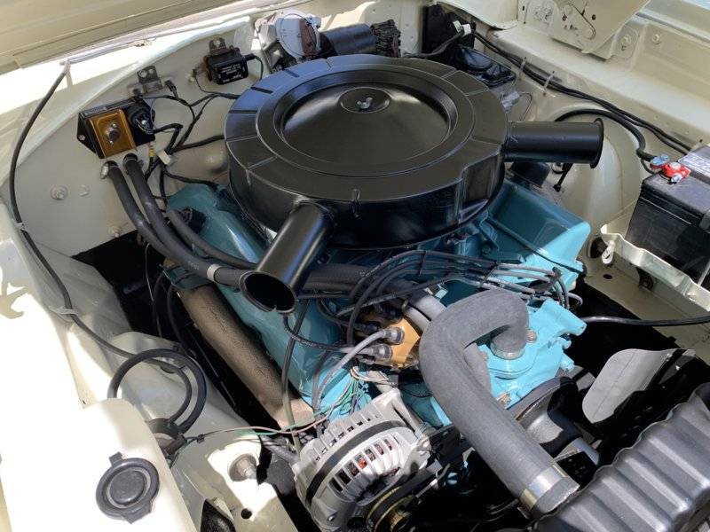

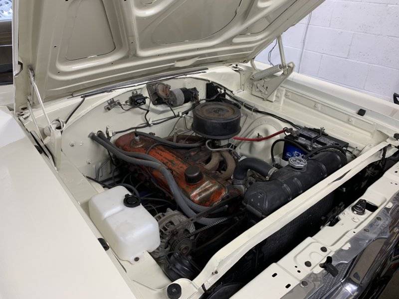

A bit delayed but here are the results. The slant pic was Friday afternoon of Memorial Day weekend just after getting home from filling it up with Hi Test, the V8 pic was Monday afternoon (Memorial Day). This was a big project for 1 long weekend and it was just me and my Father, he always was a gear head but he’s 74 now so he’s not able to lay down and crawl around under the car anymore... so I’d say it was 1.5 guys, 3.5 days, 2 30 packs to accomplish:
- slant 6 out
- 904 out
- 7.25” and leaf springs out
- K frame out
- Bolt in connectors in
- K frame in
- 8.75 (3.73 grip) and HD springs in
- 727 w/10.75 convert in
- 383 w/comp 270 in
- TTI 2.5 manifolds to tail pipes in
He was driving it by 4pm Monday.
Still chasing a few bugs but overall it’s a huge success.
The comp 270 is a very nice surprise. It sounds really good and is just ‘small enough’ to NOT be lazy out of the hole. So many cam choices end up only coming alive above 20mph and 2500rpm... the 270 doesn’t have that noticeable band come in... it’s just respectably strong from a dead stab.

way to go
my installs rarely went that smooth
I would not run 160 stat if mostly around town as it does not get hot enough to evaporate condensation and other bad stuff
after break in do a compression test and report back
then tune your timing curve and carb
what did you end with as far as valve springs?
Great job between the two of you !!
Install looks fantastic.
Glad to hear it’s just what you were after.
Very nice. That 270H is a really good pic in my book and glad you/dad like it.
Thanks for the follow-up post.
I put in a set of spring from EBay, listing says 110lbs at seat. They have run there springs into the 11’s.
$80 for the set. They are working fine.
I welded up the T-bar to limit it to about 17° in the distributor and I am running 17° initial with 1 light and 1 medium spring. The 650 AVS2 is out of the box rods and jets. Idle screws out 1 turn. It had a bog/sneeze if you snapped it open quickly... I moved the pump up to the top hole and tightened the flap a 1/2 turn and it’s perfect. Next time I have the plugs out I’ll check the compression.
