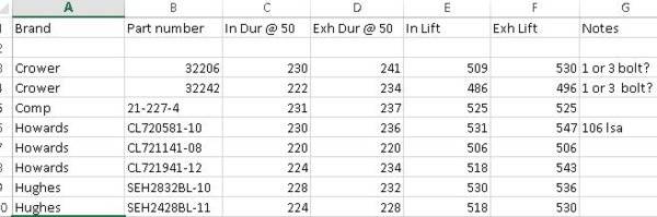

I recently spun a few bearing in my 440. I picked up most of a used 383 from a guy about a month ago and I'm now purchasing all the parts to put it together. The bottom end is all together, looks good, and turns over smoothly. I am about to purchase a cam to put in it and I was hoping to get some suggestions from you guys since this is my first car and I don't know everything about cams.
Here are the specs and the cams that I am considering right now.
Vehicle: 1989 D100 Will see maybe 1000 miles a year as it's mainly a toy
Block: 1968 383 bored 30 over
Pistons: Flat top @ zero deck NO valve relifs
Head Gaskets: Steel .020 crush
Heads:1968 250 casting code. Have 2.14/1.81 valves installed and are not shaved.Will be home ported
Intake: Torker 383 with gasket match porting
Carb: Holley 4160 750cfm Vacuum secondary
Gearing: 3.55 posi 9.25"
Stall: 3000 B&M Holeshot in a 727
Weight: About 3800 with me in it
I plan to rev it no higher than 6000
I need something that will give me good power, but not have too large a lift at 50 and cause a piston to strike a valve.
I'll attach the ones I am currently looking at.
Thank you for any suggestions.

I had the Crower Compu-Pro 271/284 #32242 in my 383 built alot like yours. It would be OK. Use the dual valve springs or rev-limiter as I over reved my engine with the single valve springs and bent a few valves.
Take a look at the Luniti Voodoo #10230703LK. 226/234 @ 0.050".

I had actually looked at that one as well, but didn't write it down as it's a 3 bolt style and I already have a single bolt timing chain. If I find a good 3 bolt I wouldn't be opposed to buying another timing chain though.
Also forgot to mention that the springs on the heads are rated for up to 600 lift.
Those heads are going to be limiting flow, even with a home port job.
The Crower cam just did not impress me in the 383, but I also did not degree it when I installed it so maybe it was a bit off.
I think the 110 LSA would be better than the 112 LSA, in the 383.
If you don't mind the cost difference, the Hughes Engines cams make great power.
As long as I can get it with the lifter kit for about $250 or less the price isn't a huge deal. The cam is definitely not somewhere I want to try and cut costs.

I did one that was 218@50 with .525 lift- get a copy of their master grind sheet
I think one of those you mentioned is really long for the lift- and CROWER did not used to use .006 but I don't remember

The Summit 6401 is probably the best choice for your money.
