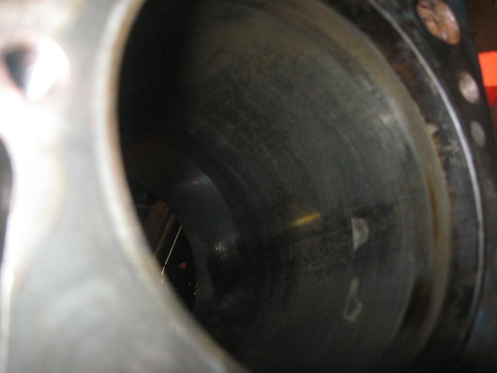

After all the **** I had with it I decided to pull the engine, a new rebuild as it
should be. I have the invoice from the shop doing it 1996. Yes, the car
only has 500 miles since. The bores looks like they have 150000 miles on them, propably no honejob and no clearence between piston and wall.
But what's scares me is the "craters" in cyl 4, I can feel it with my finger.
Can that be fixed with a honing? Bore is now 0,040.
Honing without going crazy should be limited to about .0015" on the diameter. This usually gets rid of most surface defects but not the deep stuff. Take it to the shop and have them take a minimum pass to try and clean up the marks on the worst bore then see what's left, but be prepared to make the call on the spot to go .060" because the setup to bore a block is the same. I have left small witness marks in bores with no problems - heck, my shop used to call me the re-ring king!
