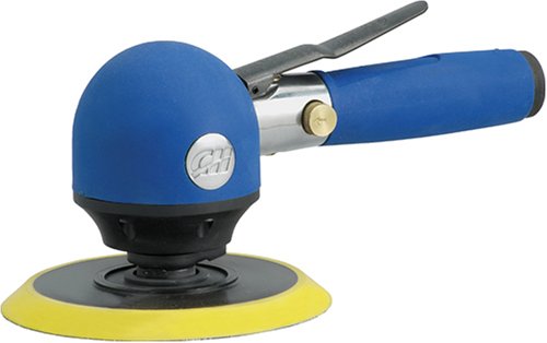

any reviews on this thing? i've quickly realized how painstaking sanding a car with a wire cone will be. lol
wal mart has em for 35 but sears wants almost 60.
60 gallon. 3.7 hp 11.5 cfm @ 90psi
That sander requires 13 CFM @ 90PSI and under heavy load, probably a bit more. I'll be up front and honest with you, your compressor will not run that sander worth a damn. DA Sanders require a lot of CFM to operate. The PSI gets you the speed. The CFM is the driving force. If you hooked that sander up to your compressor, sure...hitting the trigger it would wind right up. But just as soon as you put any pressure on it, it would fall flat on it's face.

There are a few MFG's selling low CFM DA sanders. National Detroit I know makes one, but it cost about 10 times as much as that one. Another option would be an electric DA. There are some pretty good ones out on the market. Downside is you're hampered by a bit heavier weight and will probably cost you a bit more. They don't get the RPM an air driven DA does either...so slows you down a bit.
Last option would be obviously a different compressor, but the cost there would be a real kick in the shorts. A good 2 stage 80 gallon would run that DA no problem. Anyways, not trying to cut down your plans or ripping on your equipment, just being up front with you.
not at all man! thats why i'm here. i thank you for it, otherwise i would of wasted time and money. i have looked at electric DAs and know i can do the job with it but they are more expensive.

Thats a good DA. But Body work as said here take ALOT of air !!
