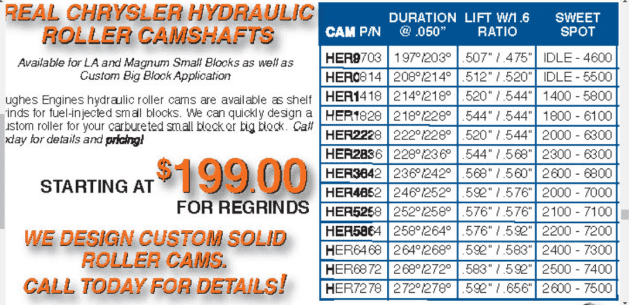

Hughes Engines looked at it the opposite way. Their cams are often long on lift compared to the duration numbers.

I was just curious as to why a company like Hughes would seem to favor the higher lift with their cams. at least the hydraulic roller ones that I have seen.

Part of the reason that I was curious about this is because I'm rebuilding a 360 for a Dart. The engine I have came to me with Hughes 1.6 roller rocker arms. Also, I noticed that Hughes brand camshafts seem to favor higher lift than I'm used to seeing elsewhere.

The Hughes cams are good, most cams use a lobe designed for a smaller diameter lifter, which limits how fast they can open/close. The larger 0.904" Chrysler lifter allows for more lift per degree rotation. Has to do with the lobe to lifter diameter geometry.
I would not run 1.6 rockers with a Hughes cam unless you're just going to do 1/4 miles.
