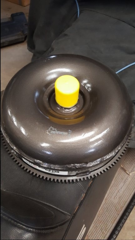

Torque converter was tweaked to about 2400 so now time to figure out cam&head combo

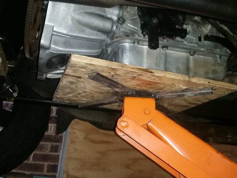

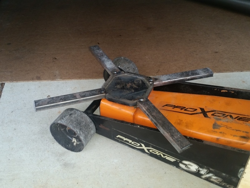

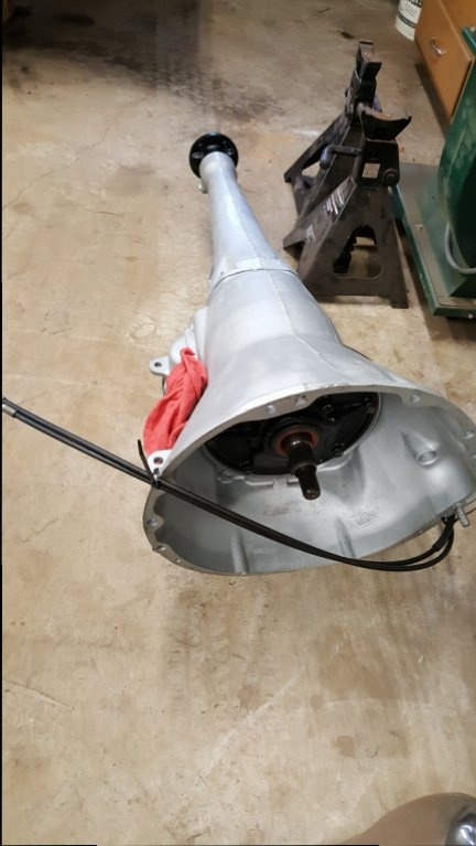

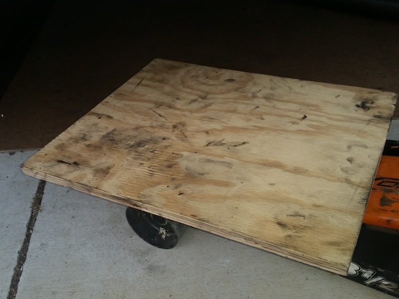

UGH . . . I just put the transmission back in my 4x4 daily driver truck . . . still got the bruises from wrestling it up onto the jack so I could get it in place ( made a nice little adaptation to my floor jack and it worked like a champ - installed it by myself )
Here's what I do - maybe this can help you out too ( or a couple friend that want to wrestle it with you )

Add plywood - for full coverage . . .

Then add transmission ( wrestling it was "fun" . . . )

Of course I was on the ground -

Thanks Larry. I saw your posts about your tranny re&re, clever idea with the jack! It was actually not difficult just on the jack plate. It would be tough with the 727 though. I bought a used tranny adapter for the jack for $20! I hope it works well if I ever get to install it.
