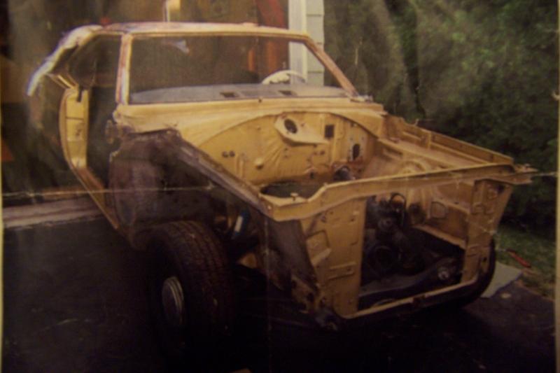

Yes but the transmission was fully rebuilt and this is what I tore it down to so you can get a idea. On jack stands because It has not seen the road in 12 yrs and everything has been rebuilt. Did not want to take it out on the street and have a issue.
