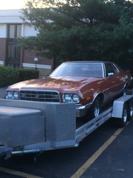

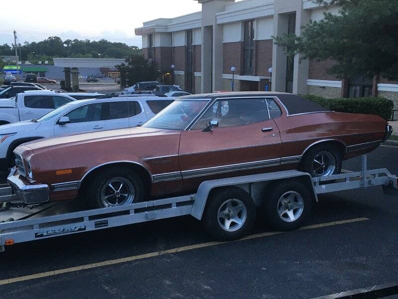

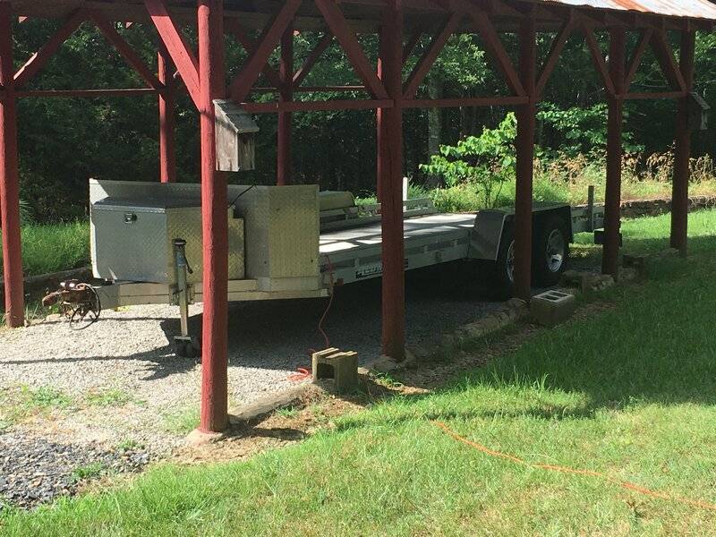

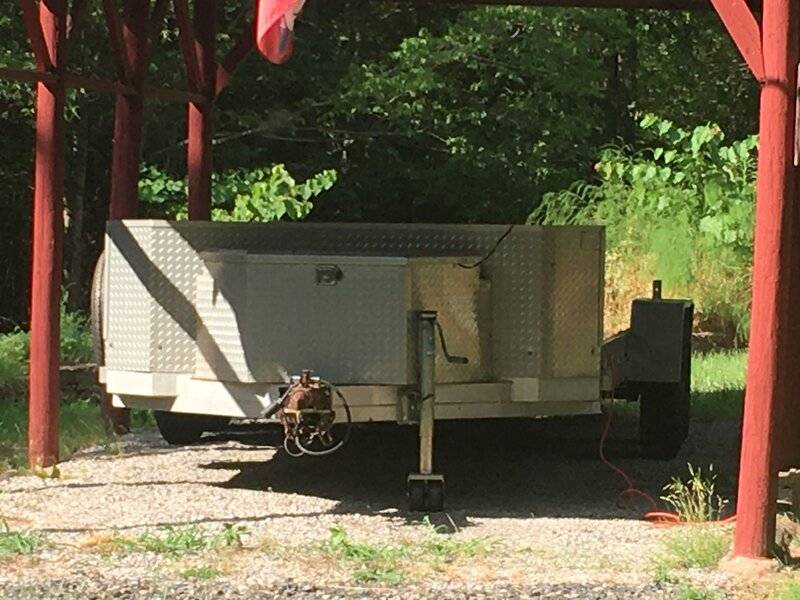

2006 Aluma 20’ trailer, winch in the box, my brother’s Torino, 750 mile trip, Illinois to Arkansas trip was a breeze on the back of my 1/2 ton 4x4 pickup with the aluminum gem.
Sure it will cost more but light, smooth and not much maintenance. Money well spent and probably perfect for your pickup too. Oh and I built a plywood box that was used to haul furniture.

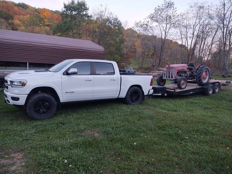

This is roughly a 6,000lbs load, my 1500 had zero problems doing 70mph with it back there. Trailer brakes are a must for me!

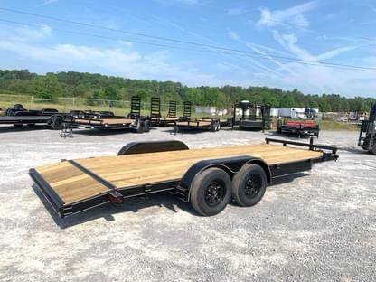

$1500 cheaper for wood deck non tilt same dealer.
New 7x20 Heavy Duty 10,400 GVWR Car Hauler / Equipment Trailer - $4,199
image 1 of 4
© craigslist - Map data © OpenStreetMap
more ads by this user
New 7x20 Heavy Duty Premium 10,400 GVWR Car Hauler/ Equipment Trailer
($4,199)+ Tax For Ga Residents
- 2.75% Debit/ Credit Card Processing Fee
- 5,200 LB Ez Lube Axles/ Brake/ Breakaway
- 10 Ply Radial Tires/ Powder Coated Wheels
- Tear Drop Fenders
- 2 5/16 Coupler
- All LED Lighting
- Set back Drop Leg Jack
- 5’ x 15” Heavy Duty Tube Ramps
- Spare Mount / Add Spare For $160
- D&D Trailers (423::::240::::2050)

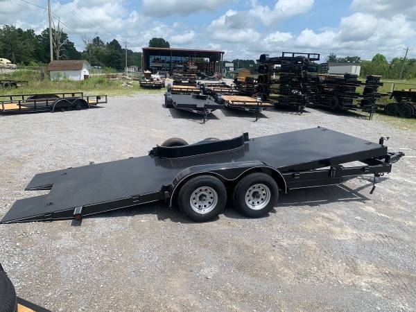

All day long on Caigs list. 2.5 Hrs north of ATL in north Georgia.
New 7x20 Heavy Duty Premium 10,400 GVWR Manual Tilt Car Hauler / Equipment Trail - $5,799
image 1 of 4
View attachment 1138698View attachment 1138699View attachment 1138700View attachment 1138701
condition: new
New 7x20 10,400 LB Manual Tilt Trailer
($5,799) + Tax For Ga Residents!
- 2.75% Up Charge For Debit and Credit Cards
- 5200 LB Drop Axles With Brakes & Breakaway
-THIS IS MANUAL NO SHOCK OR HYDRAULIC
-LED Lights, Removable Fender, Equipment Jack
-16” center on cross members
- 10 Ply Radial Tires, Add Matching Spare $160
-Spare Mount Standard, 6” Tube Frame
-1 Year Manufacturers Warranty
-D&D Trailer Sales (423:::240:::2050)
...and probably $9k on the west coast, cause it would cost that to get it here.

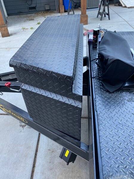

Aluminum trailer, lowest to the ground you can get, torsion axles, dexter axles preferred, biggest brakes / bearings you can get and heavy ply tires last longer, non scothlock wiring harness! LED lights, removable fenders, aluminum ramps, lots of tie downs well mounted, a well built winch mount with a good winch and battery/ tool box. I’m just putting all my ideas out there for ya..
Yep added box and winch on mine with Anderson connector to my truck battery best idea no extra battery to lug around
