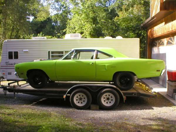

I talked to a respected buddy. He has a 16 foot Carson like the one below and says that he has used it to haul all sorts of cars including his 67 Coronet R/T. It concerns me a bit to have the back end of the car hanging out there but maybe I'd get used to that if I found a deal I could live with.
I had the same concerns about the tail hanging off the rear uncovered, and it’s why I went 18’.

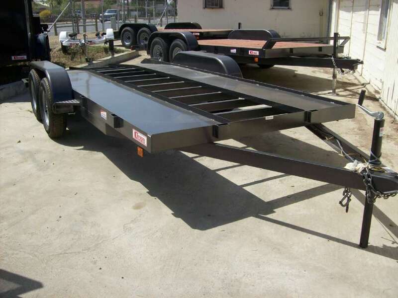

Considering the current climate, that looks like a heck of a deal. You will have to personalise it for your needs. (Winch, box, tiedowns, etc.

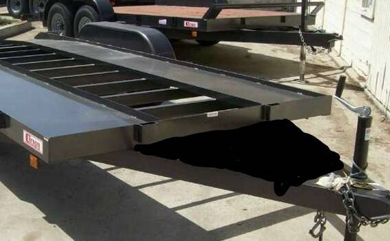

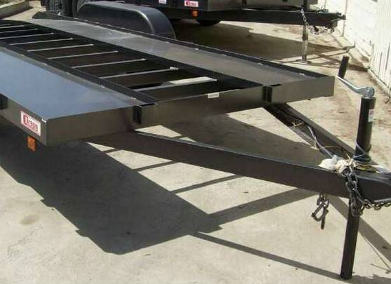

The only thing that concerns me is there isn’t much other than the channel iron from the front of the trailer to the top of the tongue. I like to see a plate across minimum or a plate and a nice heavy C channel tiring both parts of the A together. Every trailer wreck I’ve seen like that the bend there bad .. If they’re built with a plate it may help. IMO Silly question why do I see so many new trailers without the jack foot? Optional ?
I agree with F4R/T, that tung looks chinsy, also probably the first trailer I've ever seen where they use smooth steel plating.. they're always diamond plate? That would be awful slick with some wet tires.
If you get the Carson, check out the electrical. Last one I saw it was really crude. You might get better tires for it too as they are usually cheap junk.
GI have a Carson dovetail with the metal deck, it’s paid for it self over and over I’ve hauled so much with it, my friends have used it, but if you get one first thing you want to do is pack the bearings, I bought mine new 2 of the bearings were too loose the other 2 were to tight and none of them had enough grease had to do some wiring upgrades and took those cheap tires off and put some 10 ply bias tires on, been hauling vehicles for over 15 years now without having to touch a thing on it, oh I also added D rings for extra tie downs , you can’t have too many of them
Gotta mention tires here - NEVER operate a trailer with P-rated passenger car tires!!! EVER! You will have a failure with P-rated tires, guaranteed! Even LT-rated light truck tires are a bad idea. Whether tandem-axle or single-axle, always run trailer-rated tires, either bias or radial (I prefer bias-ply in this case!) with an eight-ply or higher rating. On the trailer I had that was stolen six years ago, it had a set of Korean-made 700-15 10-ply bias trailer tires that were the best trailer tire I had ever used. From 2000 to 2015, I had put a bit over 130K miles worth of road under my hauler, and went through only two sets of tires in that time. Bias-plies are far less prone to sidewall cracking and just falling apart the way radials do when exposed to long periods of sunshine and ozone. They have a sturdier sidewall that is strong and resists curbing; and are just a better overall trailer tire, IMO.

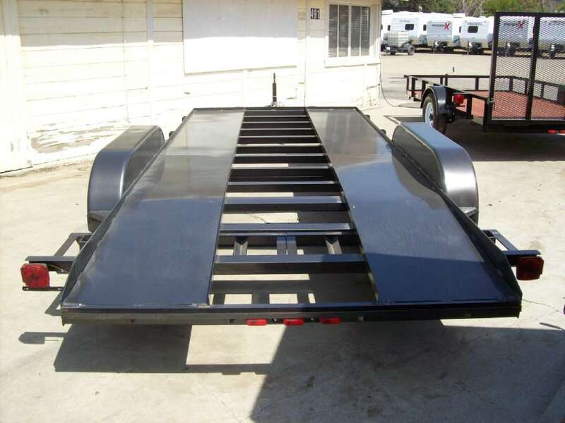

What if a man welded some sheet over this area like I depicted here?
^^^ Easy! ^^^ I don't know why you'd want to do that, necessarily. If I were to add metal to that example, it would be along the length of the trailer cargo length. A full floor enhances strength and usability - an open floor is useless for anything but something that rolls. If I were to "fix" the tongue area, I'd weld up a length of "C"-channel midway across the tongue (L to R), then install a HD 10K# jack with landing gear and a wide foot there, and delete that weak-assed POS tongue jack it has now. Delete that, and you also now have tailgate access to your tow vehicle. That is a horrible place to mount the trailer jack.
With a 78" width between fenderwells (standard for a car hauler is 82"), you limit yourself to what you can haul. No front over-run bar, either. Easy to roll right off the front of the hauler, and that makes for a bad day in itself.
No side rails along the frame edge (extending out the sides, NOT above like a utility trailer!) no square tie-down pockets or "D"-rings; hell, only one on the sides that I see at all! No recessed lighting...this is a very cheaply-made unit.
Flat metal instead of diamond-tread for the area where a vehicle rolls, is a perfect example of a poorly-thought-out build design. If I were still selling trailers, this is an example of what would NOT be on my lot! The trailer in the background has some of the features I mentioned - a set-back tongue jack, more tie-down points, and an overrun bar up front
With an 80" width between fenderwells (standard for a car hauler is 82"), you limit yourself to what you can haul. No front over-run bar, either. Easy to roll right off the front of the hauler, and that makes for a bad day in itself.

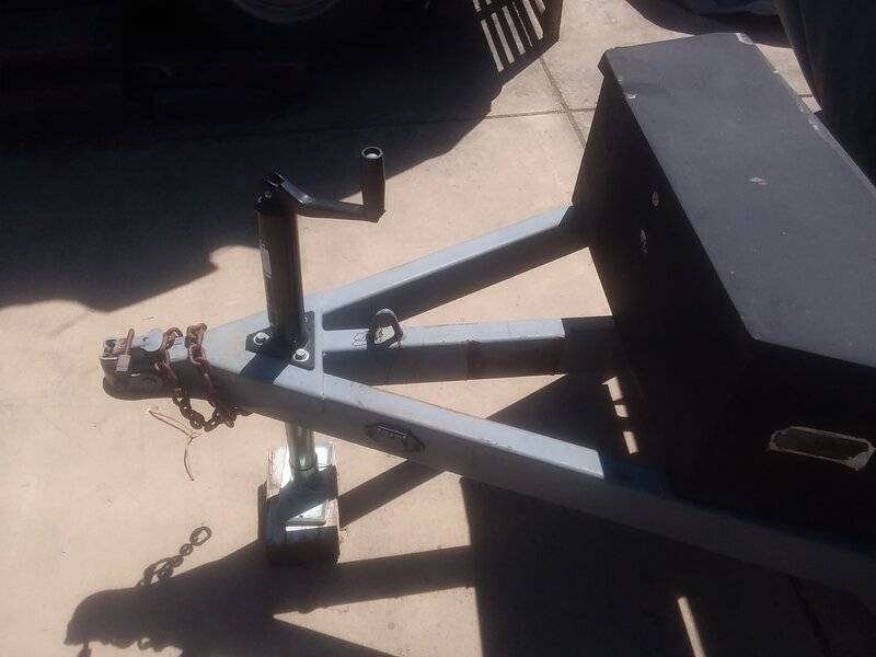

The trailer jack so close to the tongue is a poor placement. I didn't notice that.
Smooth metal for the deck does look cheap and does not inspire confidence. I've been considering wood anyway.

Your Charger would be a very tight fit on that, width-wise. The example trailer would be OK for a Dart or Duster-sized car on it, or a large quad, perhaps.
I prefer a wood deck, as well. I used to haul tractors, pickups, cars, flagstone, palletized items and more. Loading in the rain or just a wet deck, steel floors are a lot more dangerous to both you and the load when loading/off-loading. A wood deck, along with multiple tiedown points along the sides and front, offered flexibility that isn't there with an all-steel deck. You'll get folks that swear by steel, others by wood. Most of that is simply personal preference. Granted, you need to replace a wood deck periodically, based on usage, how the trailer is stored, and other criteria; and whether you use pine or oak as the decking material.
Oh, and the fact our example has an ANGLE-iron frame and not 4" or 5" "C"-channel frame, and there are NO brakes!!! Even more reason to run quickly from something like that! Most states require at least one axle have brakes on a tandem. Some go by weight - any trailer over 3,000# must have them. I can't believe the nanny state that is California, doesn't require trailer brakes on something that is 7,000K# GVW! Wow.
The description does list 10" electric brakes but also shows a 4 pin electrical plug. I don't know how that would work.

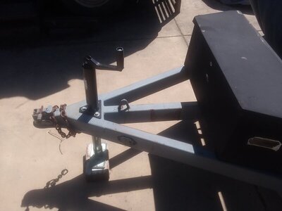

That trailer jack placement is just using the standard location that is a part of a universal ball mount on the tongue.
Mine had a swivel mount that worked very well..... till i forgot to swivel it one day, and i bottomed out going out my (fairly steep) driveway. The winch box placement makes its use impossible, so im stuck with the jack mount where it is. The problem is, it has to be removed to go in or out of my driveway, it wont retract enough to not bottom out. I hope i dont forget to remove it some day.
As to some of tbe rest..... i just welded a piece of 2"angle on the end of the rails as a stop. Works perfect.
Also, i did add a filler panel between the rails, at the back. I was carrying a very small car, with a very narrow rear, and very wide tires. Without the filler panel, half of the fourteen inch slicks would have been in space. Welded in 1/8" steel panel, problem solved.

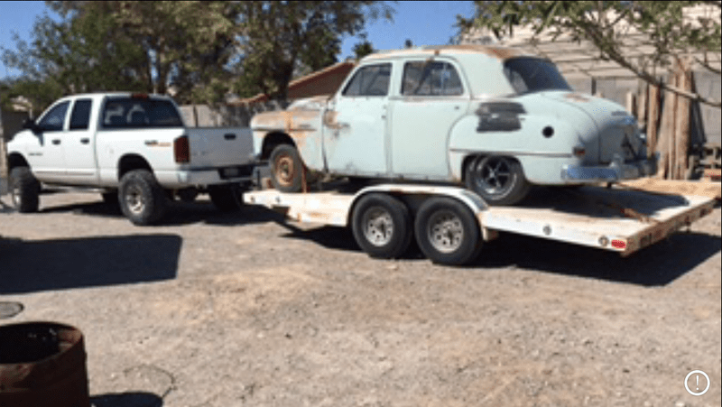

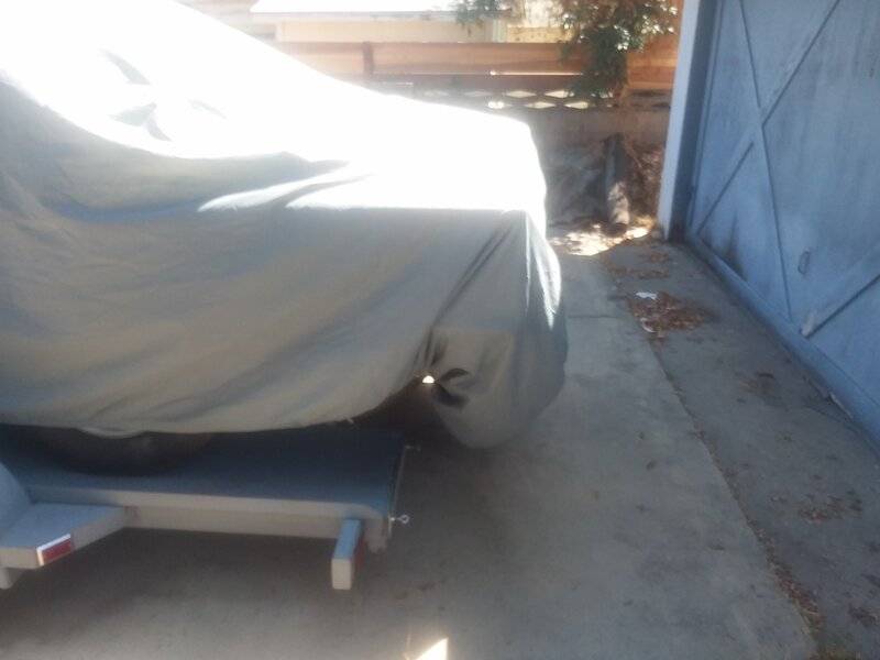

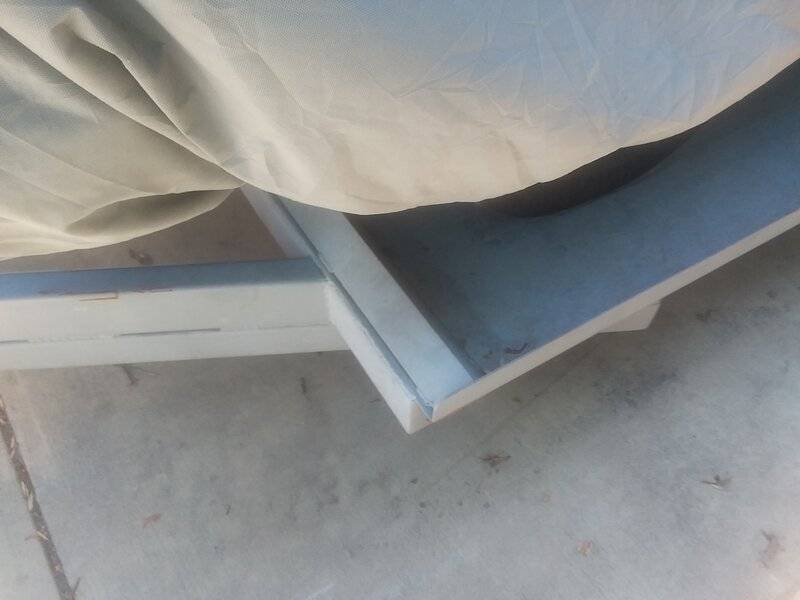

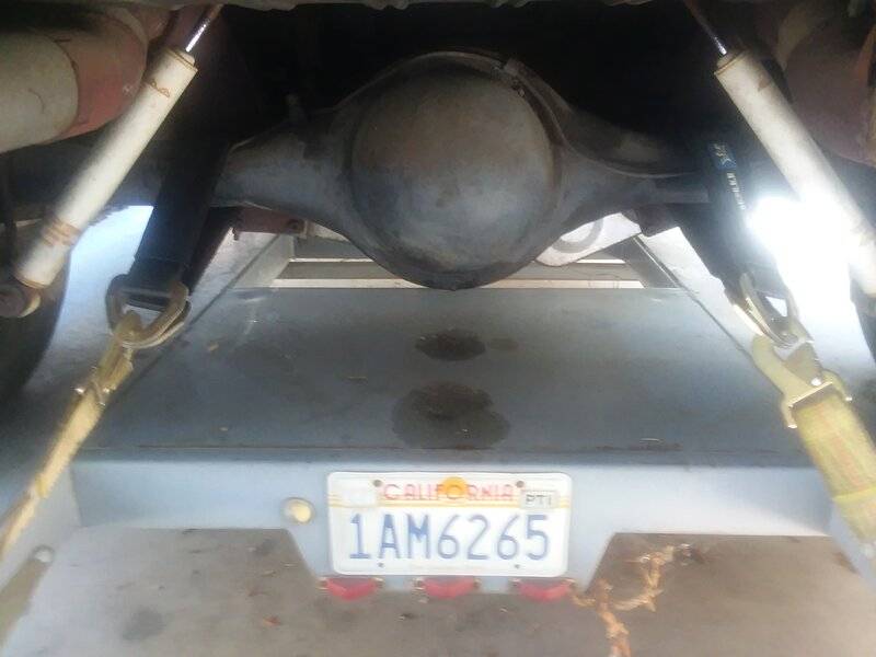

Mine is a fourteen foot bed, with a 62 b-body on it (still could go forward six inches or so.) This is how much hangs over the back. Has never given me a moment of worry.
20210805_143621.jpg 20210805_143628.jpg 20210805_143638.jpg 20210805_143718.jpg
Edit: if you look at my tongue, you can see that is double stacked tube on the sides, plus a center tube (where the swivel mount jack was, you can see the scar) i would guess my tounge is five to ten times stronger than that carson. But then, as others have said, a trailer is a blank canvas to build the way you want or need.

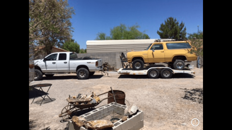

I will be towing with my 2007 Ram 1500 regular cab 2wd truck. Maybe on rare occasions, I'd use my 75 W200 Power Wagon.
I would prefer a used trailer but am open to whatever I can find. I am not in a hurry but I would like to have one as soon as I can find something that fits my needs.
I have no interest in buying another truck to tow with.
A buddy has tried to sell me his cobbled trailer and I have been as gentle as I can in telling him that I want something bigger. I want one sturdy enough to haul a B body or even a pickup truck if need be. It would be stupid to buy a 14 or 16 footer and then need to rent or borrow a longer one for a bigger car.

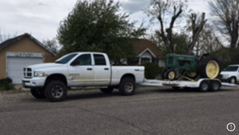

This is a 16ft Triple Crown with electric brakes on 1 axels with a Cbody as you can see plenty of room and I have another photo
