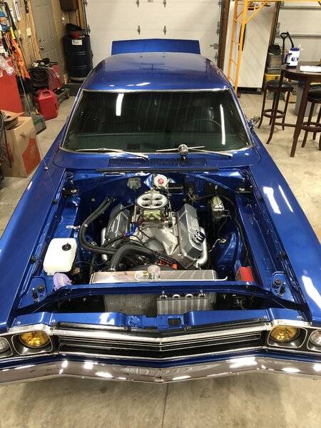

Thank you, I did reach out to Dom on Facebook. I haven't heard back yet. Sounds like we have similar cars. I have SS springs on mine with 90-10's front and adjustables on the rear. Will see how the car acts with the SS springs next year before pulling them and installing monos and Caltrac's. There's a nice guy here on this forum from St. Paul Minnesota with a beautiful 66 Satellite that's been real helpful on chassis set up. Thanks again for all the help & info.

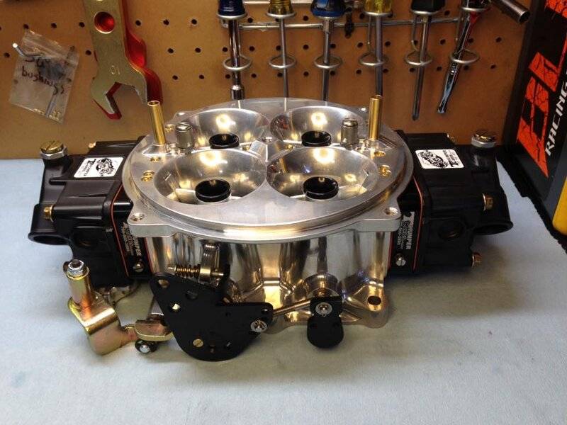

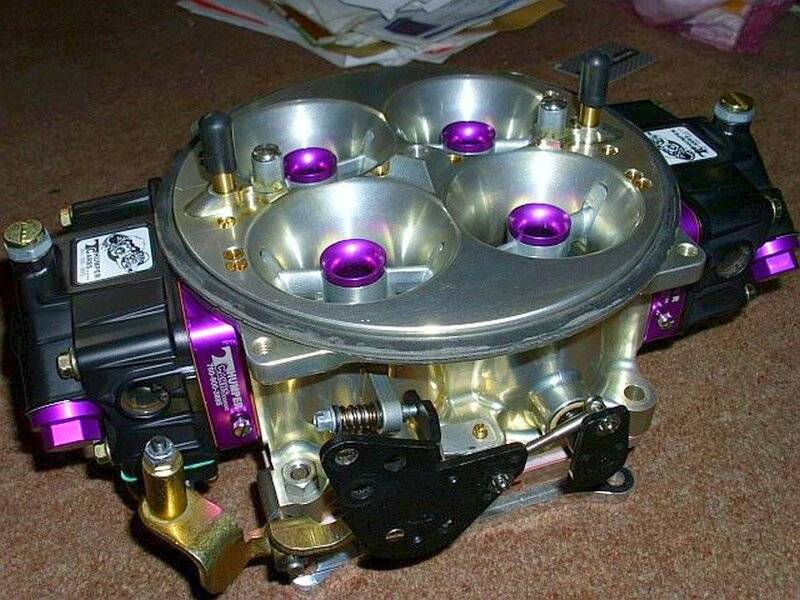

JPJ, You'll hit the Jackpot by talking and getting a nicely set up carb from a guy out west by the name of Thumperdart with his Thumper carbs based on both 950's and 1050's. I'm below 500 inches but a lot lot more lighter than most of y'all here, but Thumper's carb, along with a few other remedies that needed to be sorted out got my car clean on the streets and able to crack single digits but evened out just above that in the low 10's. The rule is good atomization. Both Thumper and the Boyz at BEST machine suggested that I go 1050, but I was on the fence and veered to the side of simplicity and most importantly streetability. I'll let Thumper speak his beat, but he'll steer you with an excellent carb. His mid 9 second Dart with his own 1050 roams the streets and lays down the numbers at the track.
I'm sure that there are other great carbs out there.
And its that same 1050-ish BLP carb that we are gonna try next year with some minor mods for our spec.:thumbsup:

Good on ya for going for it..........our Thumper 1050>1100+? has .082 pri jets with a 6.5pv put in for us and .090 secs no pv...I'm no carb guru but that tells a story.

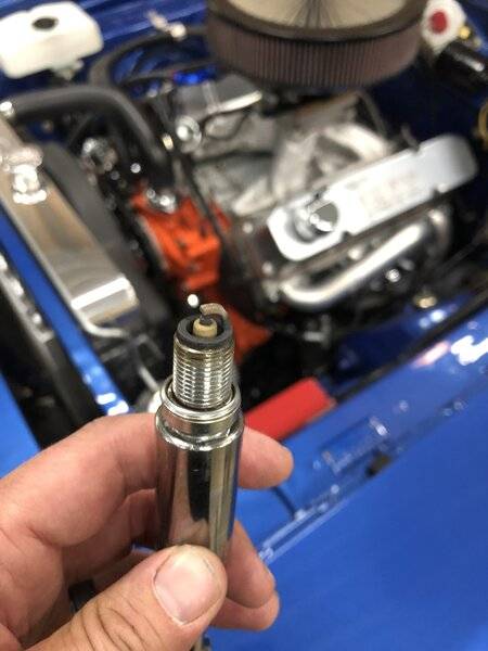

Takes a little work to get the dominator dialed in but is rock solid when completed. I haven't changed plugs in 6yrs.
