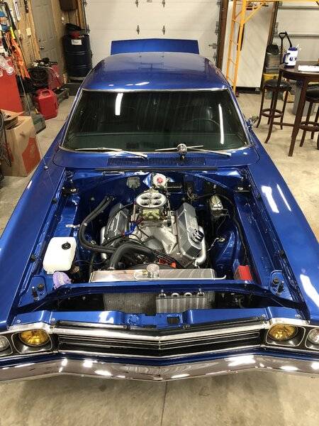

Can't quite tell from your photos, If that's a 4150 to 4500 carb adapter under your carb on the Dart what type did you buy? Thanks!
roadrunner has an 2” adaptor 4500 to 4150 with a 1” wood spacer on top of that.
the dart has a 4500 flanged intake.
The manifold is a Mopar M1 designed with a 1050 mount, spacer is just a spacer. Both intake and spacer are open plenum. Engine was originally designed as a drag race engine.( Muscle Motors Killer Krate) Having more fun on street with it. It cost about $100-150 for a day at the track to make a max. of 6 passes ( usually only two time trails) rest depended on how we did during eliminations. That kind of money can make a few days of local street driving.

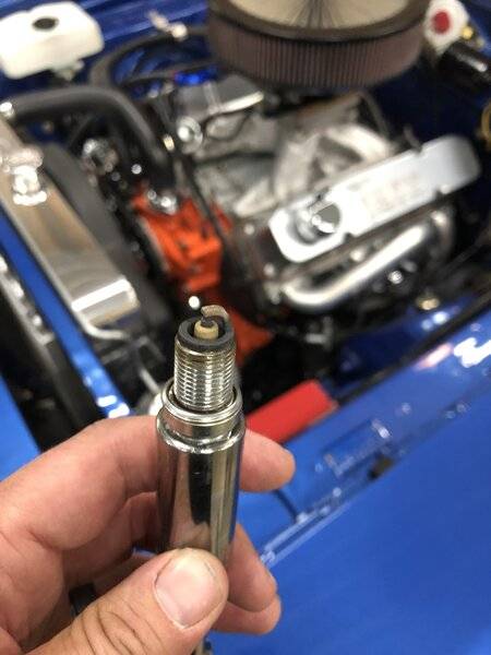

I think a dominator is to much carb. I think looking at 850 or maybe a bit bigger. Sounds like you want the whole package like we all do. Cruise on the weekend and knock down 11s at the track and.drive home again. No matter what you go with its going to take some tuning , going to hve to find that happy medium between driving and all out race. The domintor was not ment to be a cruiser ....
Agree 100%. That is why it is on there. Just thought I would try and help "clean up" the possible excess fuel issues. As stated by me here. And I really do not even know if I have any - never used a wide band to test any air/fuel ratios at any RPM. Have read a great number of articles that say ANY street car ( which it will be now ) needs vacuum advance to help it live. A modern fuel injection system that controls timing would fix that, but money here is going into windows, roof, and remodel. So trying to stay busy ( so I have something to add to the " What did you do to your B-Body today forum). And I do like to "piddle".
