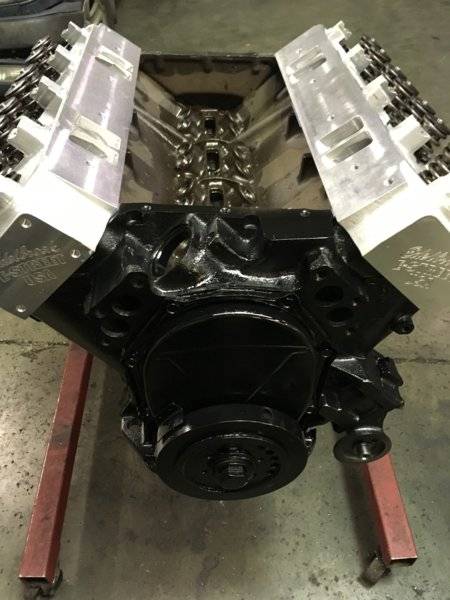

I’m building my 440 motor now I’m to the point where gotta make a decision on fuel whether it’s a 850 carb or EFI ??
I put kB 237 pistons in with the Hughes engine top end kit shld be 500 hp they recommended 850 carb but which one any recommendation out there this gonna be a street car. 69 sport satty
My motor now
