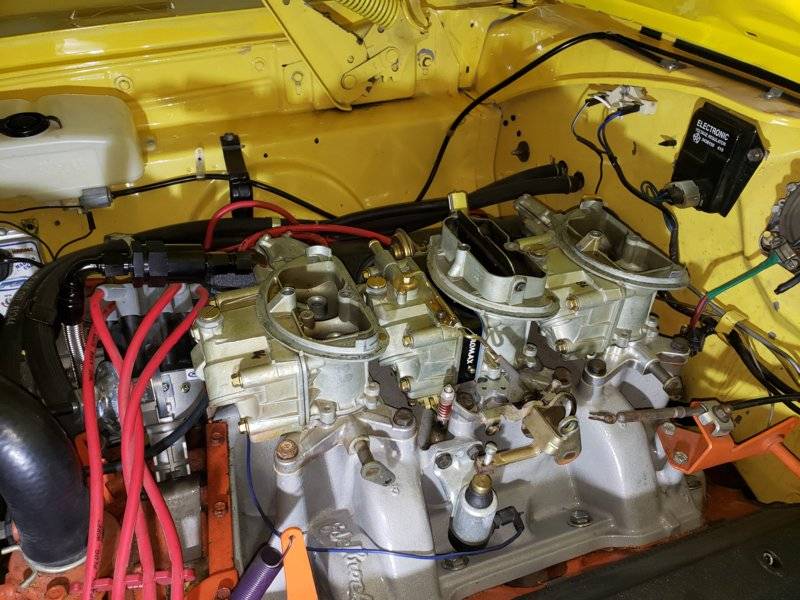

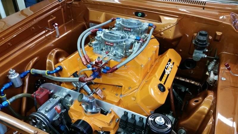

My cross ram runs 2 Eddys. Way cheaper that Holleys. It's been 9.02 with Holleys, 9.00 with Eddys.
Doug
What size eddys?
750s. 650s will work as well.
Doug

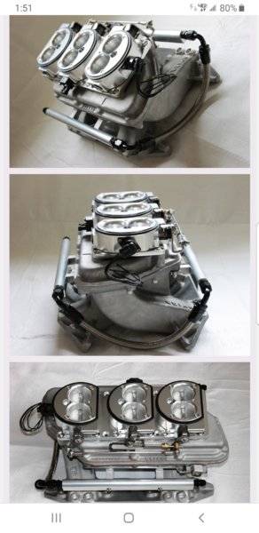

What about 2x4 EFI units?
I think @andyf has some experience with this!
