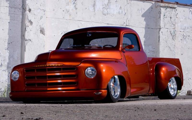

I have also changed my mind on the color and have had this option on the back burner before I decided on the last color. This has been the hardest part of the whole project. What do you think of my choice.
[/QUOTE]
Awesome job you are doing. Did you ever find out what color this is?
:icon_thumright:well since my last visit I see you have been very busy,some very nice work there,thanks for keeping us up to date ,:headbang:
Hunt2elk, I have not found the owner or anyone that could tell me so far. I am going to take the pic to the paint supplier and see what they come up with.
Thanks for the comments guys.
it looks like a House of Kolurs, almost a candy type of 3 stage paint job on that Studey, dark gold base, candy tangerine second several coats for the darkness & an orange or gold pearl third step mixed in the clear or something along those lines... cool color for sure
