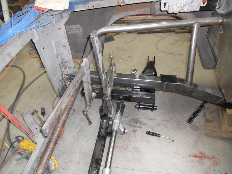

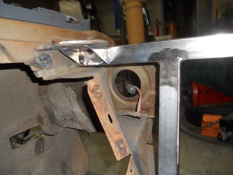

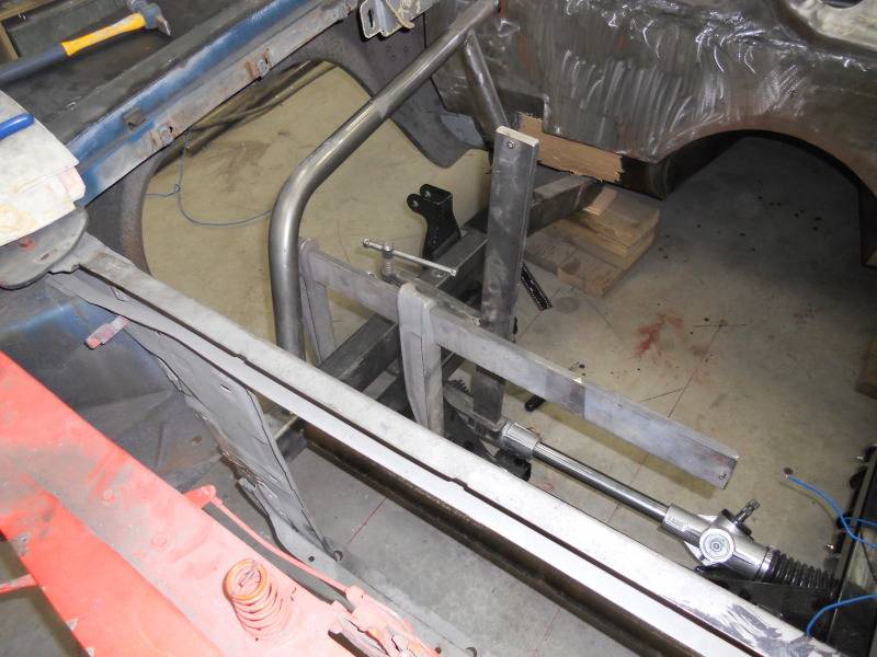

If you dont mind? Whats this color called? Looks better than the Fk5 that came on my Bee.Well I haven't posted in a while, have been busy working and have not had a chance to work on the car but I have been buying lots of parts. I got my rad and fans here and the fiberglass bumpers ( not sure if I will use the bumpers ). I had a good talk with Bill from RMS regarding the Alterkation unit and he told me the unit was actually designed for my type of application and morphed into stock application. I have been looking at all possible avenues and after talking with Bill I decided to order one and it will be ready to ship in about three weeks. Bill makes mounts for the upper control arm that I can weld to the frame rails and by using the same shorter mounts for both the front and rear of the control arm it brings the control arm more level and actually gives the suspension better geometry. The complete Wilwood disc brake kit is coming with it as well ( 11" slotted and drilled rotors, 4 piston calipers ). I have also been buying parts for the new 588" blown Hemi which I am going to have the machining, assembly and dyno done by Performance Only in Florida. I have also changed my mind on the color and have had this option on the back burner before I decided on the last color. This has been the hardest part of the whole project. What do you think of my choice.
