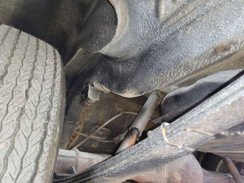

I absolutely plan on putting eyes on the car before I part with any money. I would assume that most problems start in the wheel wells. Here is the rear drivers side.
The mileage on the odometer is really low. I thought it might be 100k+ miles but I think the shocks might be factory.

Bring an awl and start hammering away at the various sections, if there are holes you'll find them.
Looks like a solid car, in Northeast terms.
