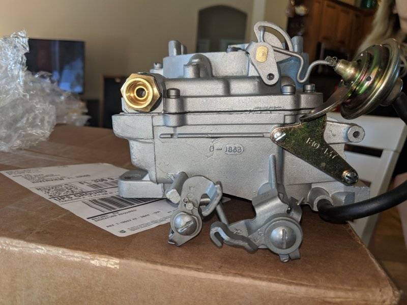

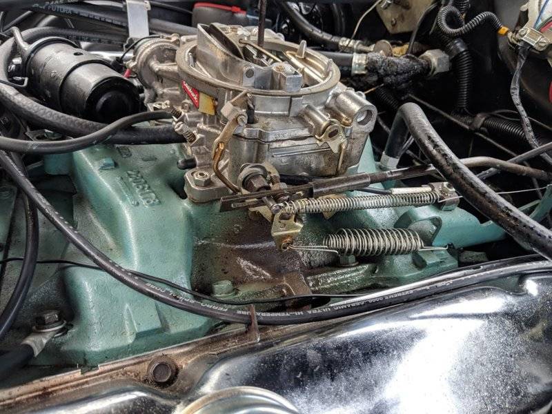

So I purchased what I hope is the correct carb for my 67 GTX.
Can someone please help me as to what parts I need to set up the throttle cable and the kickdown?

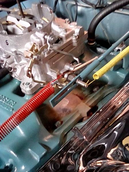

I currently have a 1407 edelbrock on there and I don't think the linkage transfers
Does anyone have pictures on how a correctsetup looks?
Thanks

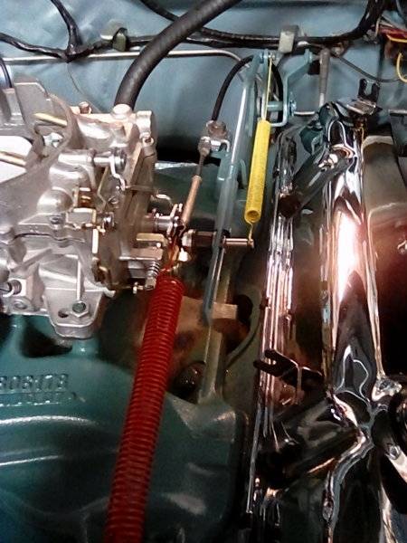

Here is what I have now. Being new and all I was wondering if someone can help me with what parts I need to order to make this correct.
I appreciate the help
It looks to me you would need the correct throttle return spring and bracket. You will also need the correct choke thermostat.
If you have a 67 440 automatic then you have the right carb

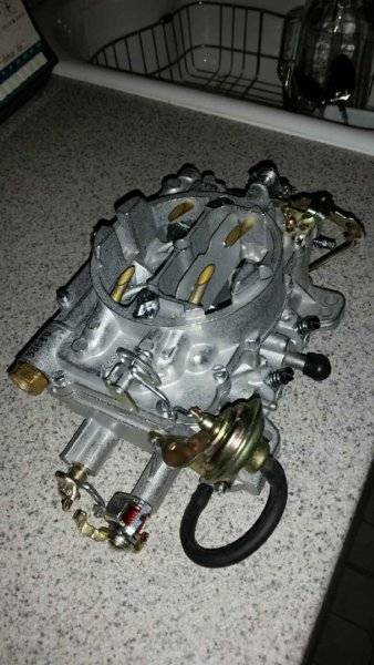

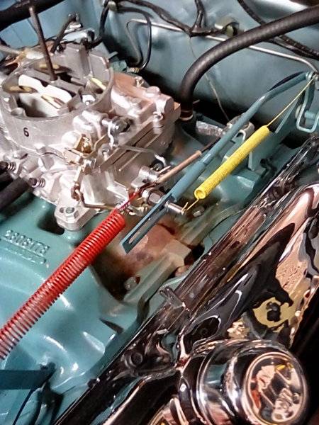

This is what arrived today . With my limited knowledge it looks ok
Looks like you'll need stud for throttle return spring, throttle spring, throttle spring bracket, and choke assembly. Your fortunate to locate 4327s carb.
