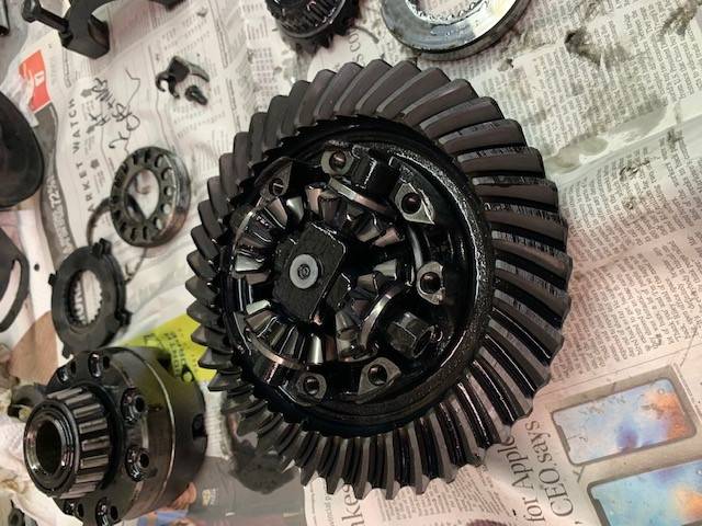

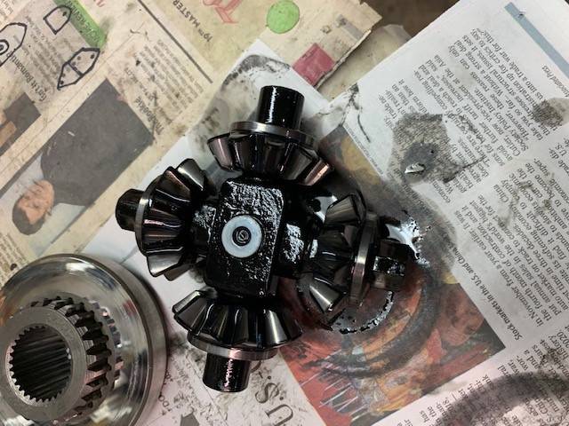

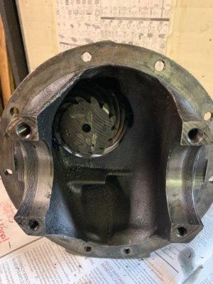

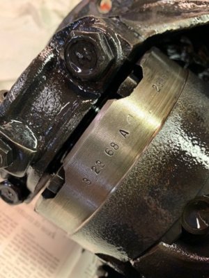

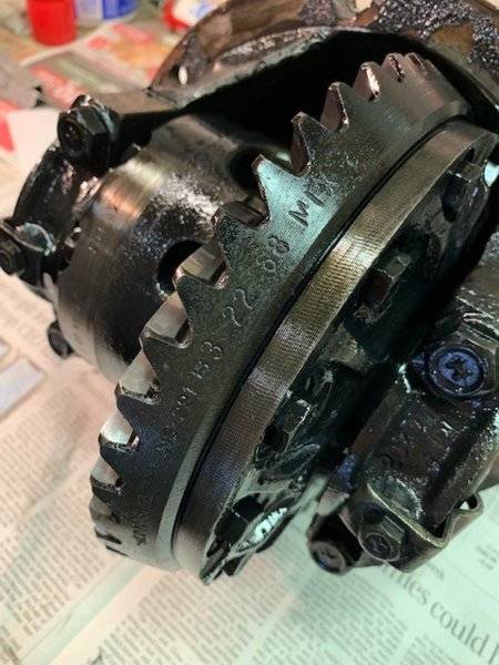

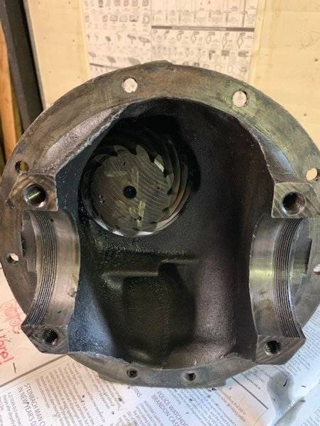

So...ordered new clutches. Diff opened up and all gears etc cleaned out. Everything looked brand new once cleaned. (I think!). Installed them. Lots of oil and friction modifier on assembly. Back on the car. The tires were "skipping" on turns for the few bunch of miles but then everything all smoothed out. The dates on the sure grip and gear were 1 day apart and about 45 days before the scheduled production date of the car. Pretty neat! Some pics.......

Nice! Thanks for the follow up. So many threads get left hanging....anyway glad it's working! Something that helps on a new setup is to find a safe spot to do some slow tight figure 8's, in forward and reverse. Sounds like you're good by now!
yes. Was on the highway but would not stop the tire chirp when doing turns. Went onto a parking lot and went around and around...that is when it stopped!
