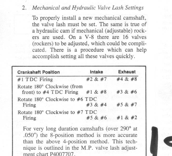

Summit is correct. So is Chrys. Below is the chart from Chrys.
Get the engine hot. Check the lash and right it down. One bank is sufficient. Let it cool over night. Recheck lash. Compare those numbers to the hot numbers. You'll get an average of how far they change. Now use that change number to set them cold. The exhaust and intake may different. I use a bump button on the starter relay. Set the intake lash when the exhaust valve starts to open. Do all the intakes on one bank Just watch for the next exhaust valve to start moving. Mark each rocker with a sharpie as you go. When all the intakes on that bank are done start on the exhaust's. When a intake valve just starts to close adjust that exhaust. Same procededure. Mark each when done and watch for the next movement. If you go to far on the rotation just bump it around. No need to go down the line for 1,3,5 etc. Then do the opposite bank.

This is the way thanks DVW. I go cylinder by cylinder (exhaust and intake) which is slower and requires more bumping the starter but it's easier for me to track. Geoffs method is from mopar and economizes how much you turn the motor over but I prefer using the bump starter and just going cylinders 1-3-5-7 then 2-4-6-8. Once you do it a couple of times it becomes routine.
