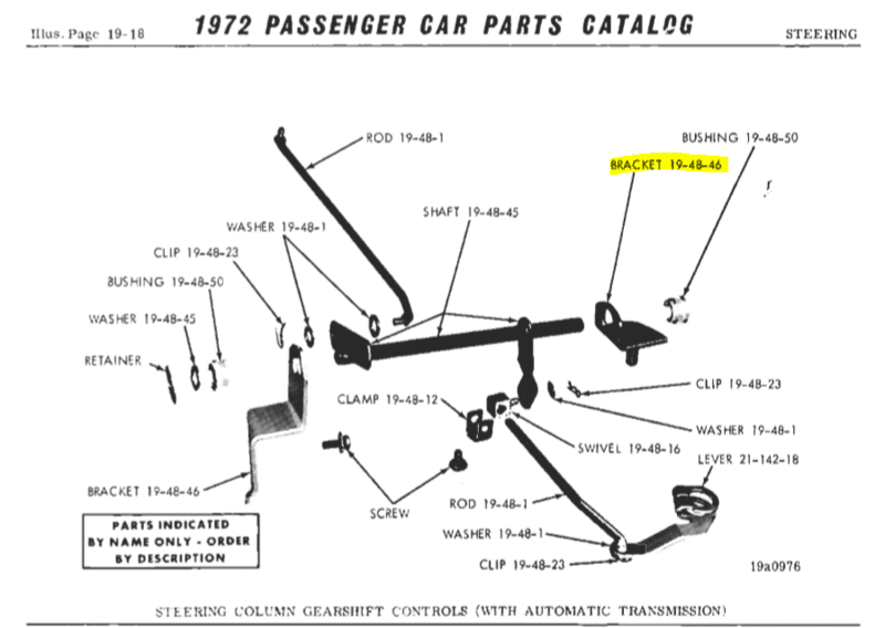

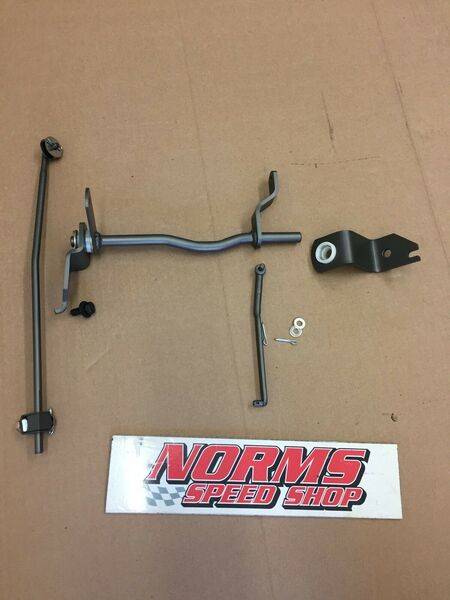

Mopar 1970-73 E Body 1971-72 B Body 727 Steering Column Shift Linkage Set Cuda
Is This what you have?
YES!

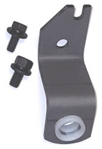

That is what mine looks like but I'm missing the bracket on the right side? and I'm not sure where it bolts into on a 1968 trans and even if it can? The 1968 trans I have is a 904, would it have a different case than a 727??
I don't think so, I am still looking.
It appears you have the correct set up just missing the bracket that bolts to the trans. Was the car original 904?

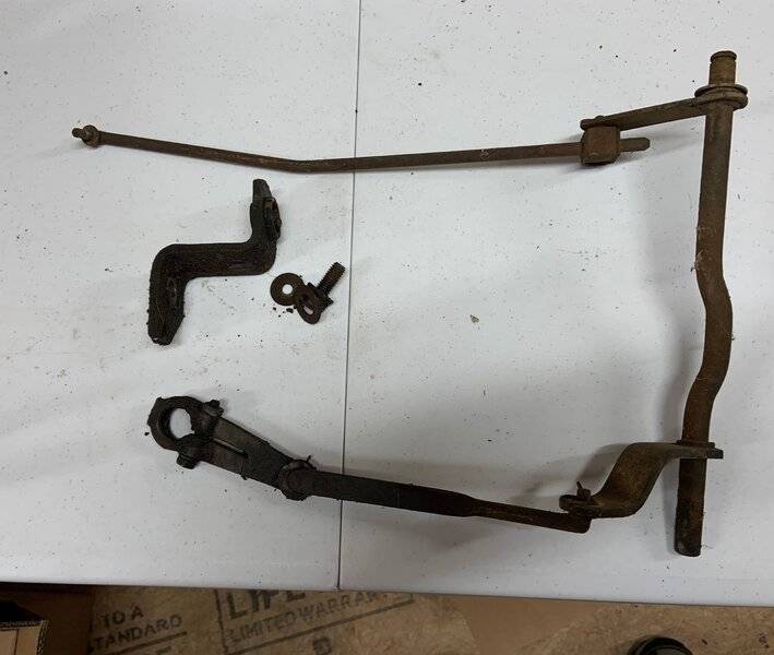

This is the correct setup. Here is the originals off my 71 Charger. As far as carlines in the manual its based off the first digit of the VIN. Charger in 71-72 is W.
Yup T2R9 that is what I have. In your picture you have the trans bracket but not the frame rail bracket.

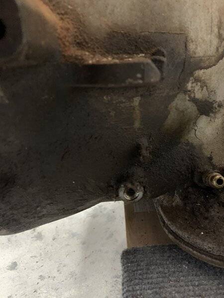

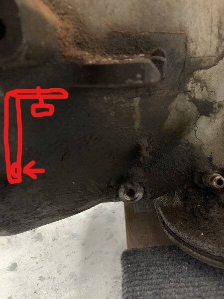

I have the frame bracket just did not dig it out for the pic. Thats very likley on the 68 trans. Here is a pic of the boss on my 71 trans. You can see where I unbolted the bracket.
Yep, that's the problem. I don't have that spot for anything on my 1968 trans.
Soooo, I'm gonna have to figure something out then. Man I am happy this got sorted out, I really thought I was losing my mind.
Any ideas on how to go from what I have to what I need?

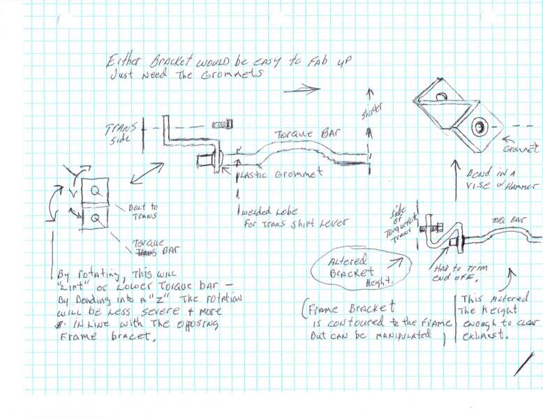

Maybe this? just a home made bracket?
Yup make an L shaped bracket that will mount to the flat boss you have and down to where it needs to be. Bore out a hole the size of the bushing and pop in a new one. It needs to be positioned just like the picture you posted in post 10 of this thread.

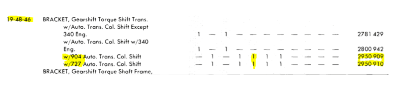

The 904 will use the same linkage starting in 71, the trans bracket might be different, (I would have to check my parts manual, but I think its the same). The difference we see here is because of the year of the trans.

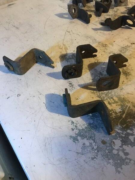

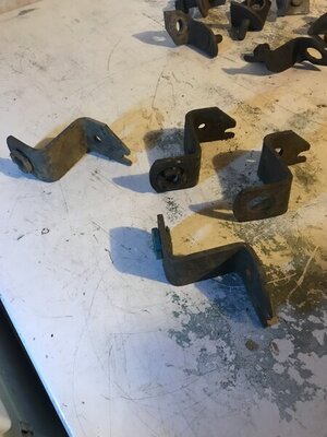

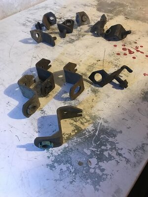

Yes 727 and 904 are different. The 727 linkage is shorter across. Here is a some pics of the bracket. Bottom 4 pieces are all the same part. Kim
2607CBEC-F687-445F-826A-918D4BB80CB9.jpeg EACA77F6-EF96-4905-9A7B-48C1F16AD8FC.jpeg
