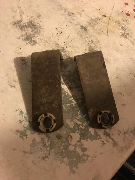

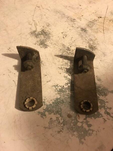

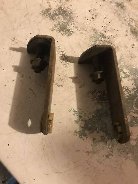

I have used this type of a bracket b4 on an older trans. Kim
1CB57CC9-D4FE-42EB-BC16-901167762795.jpeg 9F516ED2-8FA8-4CFC-8ACD-0B59DEFA8C08.jpeg ED47B8A3-0DD9-4545-8D8B-F462C4B91489.jpeg
Those should work from him. Thanks for the info, Kimmer.

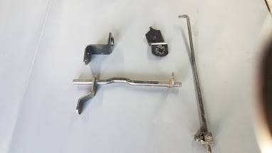

The truck bracket Kim pictured will get you close but it will still not be exactly where you need to be but a good start. Pre 70 auto trans did not have that boss on the lower area of the trans case for the 70-74 E and 71-74 B body column auto or 70 column lock-out linkage. A bracket to work for this would be a worthwhile repo piece unlike many of the other pieces they make that are not needed JMHO
