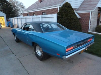

OK here is a pic of our street car. I run a trans brake in it and love it on the street. I come out at 4 and shift at 7 and man what a ride lol lThe Car 011.jpg

1969, bro, that car is so sick. Even my wife went nuts when I showed her.
