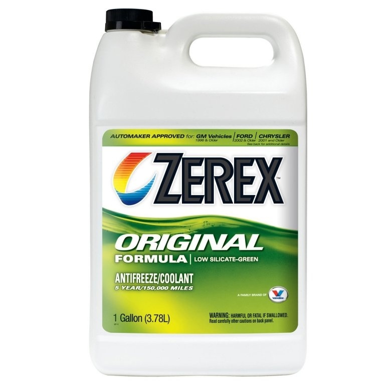

Zerex Original Green (by Valvoline) Amazon $16
OK, "Low Tox" means it has propylene glycol instead of ethylene glycol as the "antifreeze" component of the formula. Proplyene glycol won't kill your dog. However, I'm not positive about the rest of the formula. Our old Mopars used "Peak Green" (behind the counter, actual name not just color) which is a phosphate conventional green colored coolant (OEM style). fyi - Peak Long Life green (on the shelf) is actually green-dyed DexCool & will work, but is not what Mopar put in these cars back in the 60's & 70's.

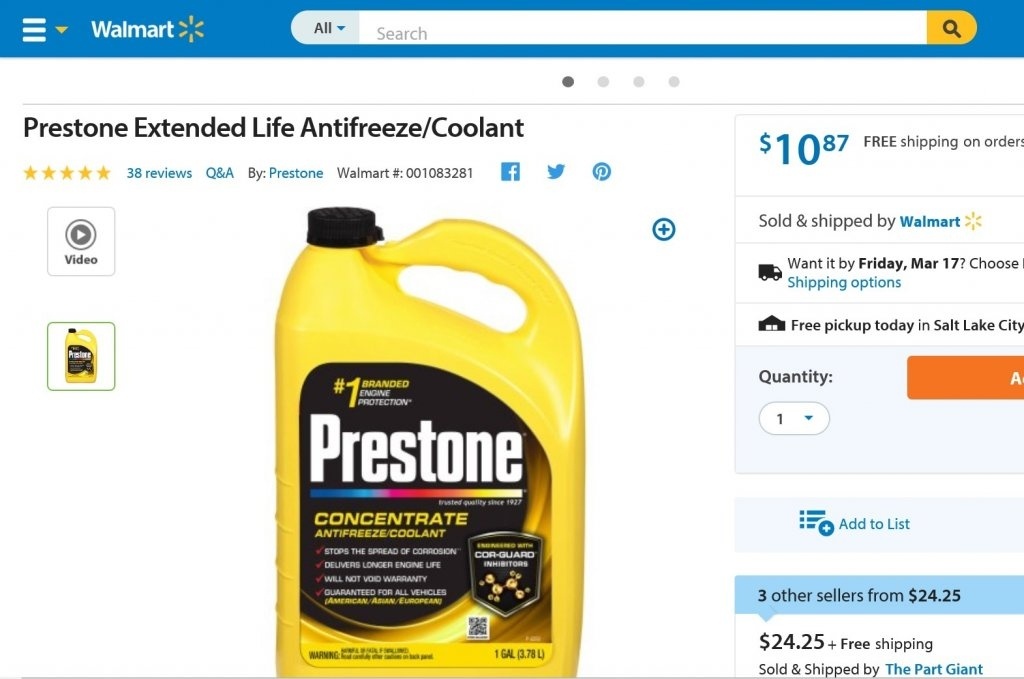

Not sure what kind of water they use in the 50/50, but "filtering" won't take minerals out like softening it will. I always use the concentrate with distilled water. 50/50 is way overpriced considering you are paying for a half gallon of water.
1 gal of Prestone 50/50 = $16
1 gal of prestone concentrate ($18) & 1 gal of distilled water ($1) = 2 gal of coolant for $19.
Good point. I was thinking about the fact of useing tap water or well water wouldn't be a good idea.
This is what I use, but I really don't think WHAT you use is as important how often you change it. I'm with Dennis, every other year is cheap insurance.
Wow, you paid almost twice what I paid!
