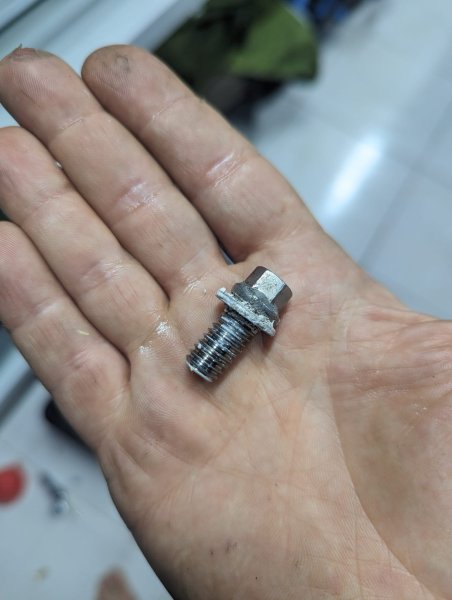

The studs I have look short to me, 3/8" long. I have longer bolts and I'll try that first and if that fails, the headers are coming off.

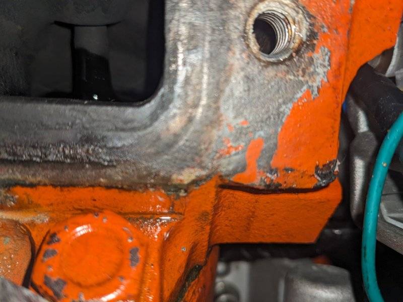

Headers are off. The threads look good to me with no cracks. I added a few pics, maybe someone can spot something I'm missing?
At this stage I suspect the culprit is the second bolt from the front. Longer Bolts on the way.
