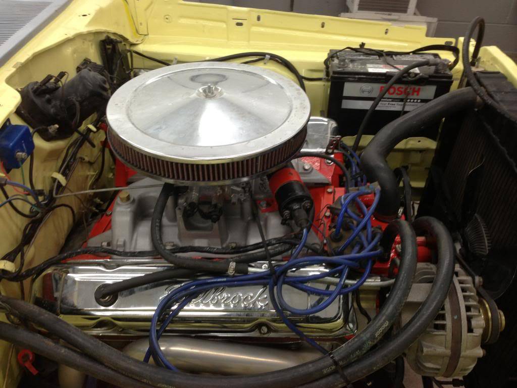

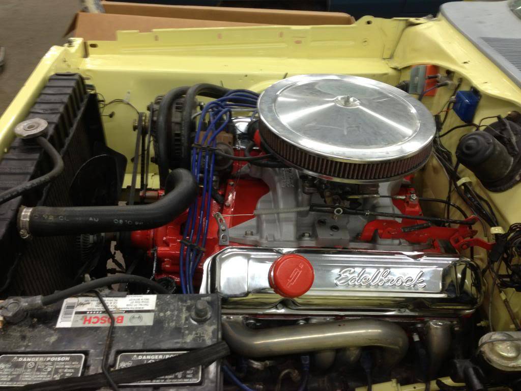

I have my R/T in the shop for interior work and some engine detailing. I bought new radiator hoses from YearOne and the mechanic at the shop claims I have a small block radiator as all big block radiators have the upper hose that connect towards the passenger side. Any idea if this is correct radiator for a 440 cid engine?

I will have the sop send me a picture of the number on top of the radiator in the morning. The upper radiator hose is too short from YearOne to fit my application.
The radiator has a number 2949043 stamped on top. I think this is for a 318 C body. Would running a small block radiator hurt a big block engine?

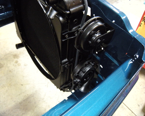

I narrowed it down to either an aluminum 'shiny' radiator from Be Cool or go with a stock replacement from Glen-Ray. I most likely will be upgrading the engine with ported heads and possibly a stroker kit so I will need a radiator that can handle 500 horsepower. I do not go to many car shows and I do not raise my hood when I do go to a show so the radiator will go unseen. Any suggestions?
Use Glen-Ray; you will not be disappointed. Used them on the '64 and haven't looked back. this is a shot of the horns but you can see the radiator.

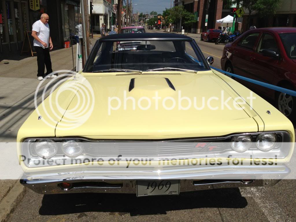

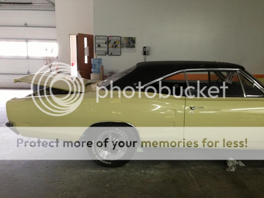

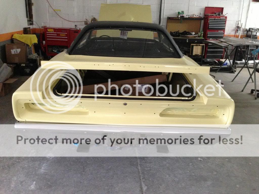

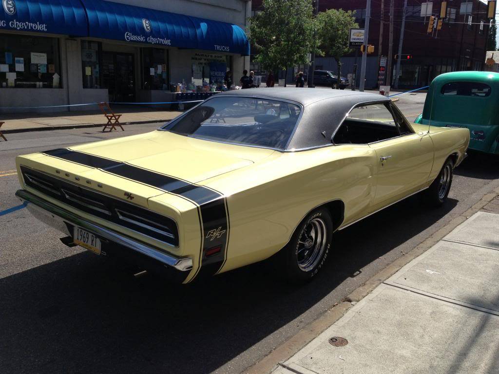

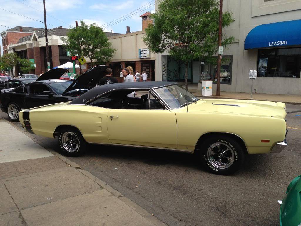

now that is settled, any pictures of your car? in case I missed it? I can guess it's yellow, and a coronet?
Sure.
After it was painted last winter.
The fratzog emblem was turned upside down in error. I noticed it later that day fixed it.
