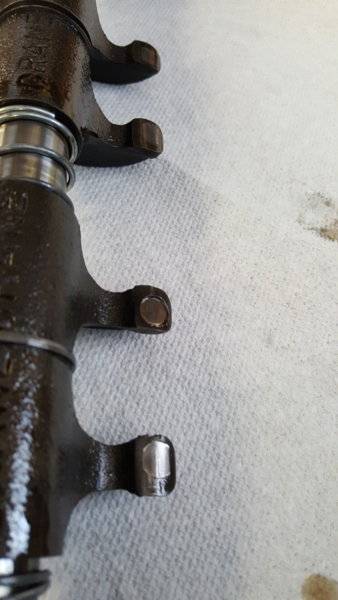

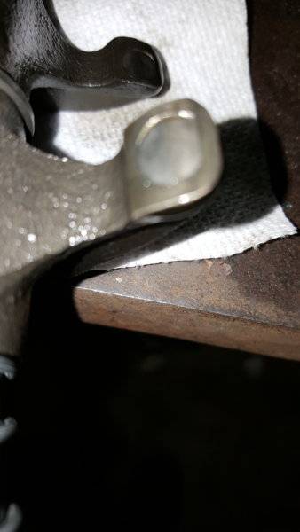

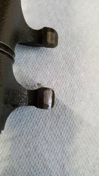

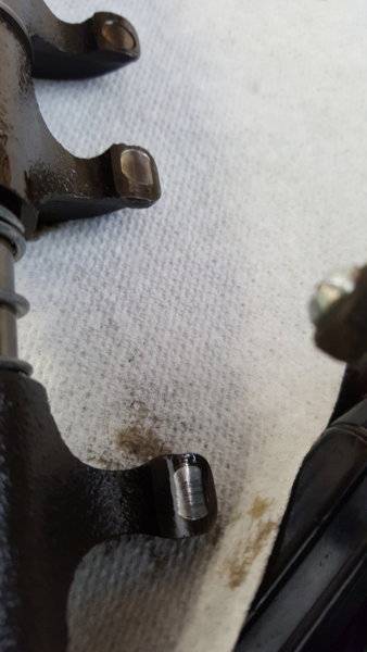

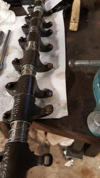

So I decided to do some pre-spring checking and pull the rockers I installed last summer since threewood had experienced failures with his last year. I had already bought mine, so I went ahead and installed them. Unfortunately, I found the same problem with mine with very little run time. Really sucks!
I contacted Crane and they discontinued them a month ago apparently. They must not have been hardened properly to wear so fast.
Now I have to replace them and probably the bloody pushrods again...not happy. What to use?

No way to know if you got the bad ones too, so unless you've got the extra money and time to re-do everything, run them.
Just keep a close eye on them now that you're aware of the potential issues. It seems to be a problem that can be averted when caught early, so watch 'em close...

Check for a recall? Crane had no problem issuing the RMA to summit for mine. Id check with where you bought them if you're uncomfortable. They have a 1 year warranty.
If you can can go through the place you purchased them, do it. Going through Crane took me several months for a replacement set.
I might do that... It must be about a year since I originally purchased them.

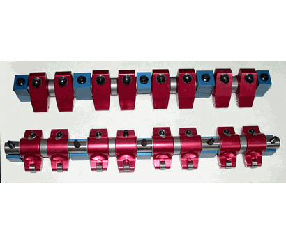

great deal on from Mancini ($511), so these are nearly the same price as the defective cranes I just sent back to Summit. Hopefully I will receive them before next Christmas!

Mancini Racing Aluminum Roller Rocker Arm Kit
Item #: MRE57001-15-714K
Write a Review
Regular Price: $669.80
Sale Price: $511.95
You Save: $157.85 (24%)
PRODUCT DESCRIPTION
Fits: Big Block, B/RB, 1.5 Ratio with Billet Holdowns
Mancini Racing Single shaft mount, rockers for Big Block Chrysler are like no other on the market. Manufactured by Harland Sharp,the only shaft rocker of this style to feature heavy duty fulcrums. Mancini Racing Mopar kits are designed for race applications with valve springs up to 1.650 diameter and .700 lift cams.
The 7/16-20 x 5/16 ball adjusters are designed for use with Cup & Ball style pushrods, length to be determined after you have rockers installed.
Kits include rocker arms, shafts, spacers, adjusters and nuts.
Warranty All Harland Sharp rocker arms carry a Lifetime Guarantee against manufacturing defects. If any machine work is done to alter their product from its original manufactured state all guarantees against defects and materials will be void.
Includes Billet Aluminum rocker shaft hold downs with ARP 12 point bolts.
ARP Bolts are made from 8740 Chromemoly and 180,000 psi tensile strength.

I just got these as well. Engine is not back together yet, but after disassembling/cleaning and setting a couple up on the heads with checking springs, I am happy with the overall quality. The swipe pattern for my lift (.526) is wide for my personal liking, but that's okay because I had already figured on using B3 for help with the geometry..
