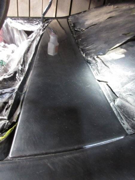

I polished part of my roof today - looked amazing, until I tried a different angle and it turned out there were sandpaper scratches that hadn't been sanded out. I moved over to a b pillar and tried a compound pass, but the compound and pad combination (3M Perfect-It PN33035 pad and Meguiar's GR17216 compound) wasn't getting the job done either.
I'm also getting a slight fogginess in the paint, although it still has that wet look, it is like the color is slightly lighter. It looks like the DA put it in. I'm not sure what is going on - maybe it isn't serious.

The foggy areas you mention kinda raise a red flag. If this is a base clear job you may be down to the base ? That or it was sprayed with to much air pressure and you have some air fog / bubbles in your clear.
These areas of fog you mention .. clean them up , get a good light on them from the side and get a couple pics. For us.

Take some good pictures like suggested. Sounds to me like you‘re not cutting with the compound.
